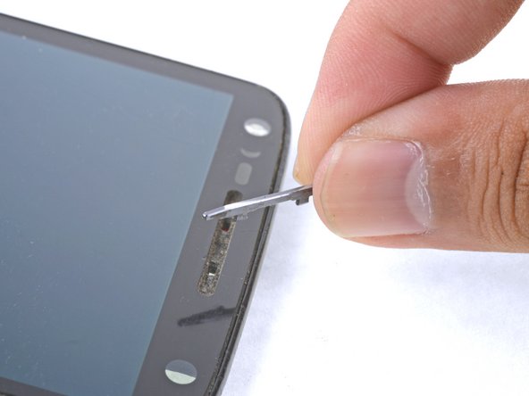

  1. Motorola Droid Turbo 2 LCD Screen and Digitizer Assembly Replacement, Midframe: step 1, image 1 of 3 Motorola Droid Turbo 2 LCD Screen and Digitizer Assembly Replacement, Midframe: step 1, image 2 of 3 Motorola Droid Turbo 2 LCD Screen and Digitizer Assembly Replacement, Midframe: step 1, image 3 of 3
    • Power off your phone before you begin working.
    • Insert a SIM eject tool, SIM eject bit, or a straightened paperclip into the small hole in the SIM card tray.
    • Press to eject the tray.
    • Remove the SIM card tray assembly from the phone.

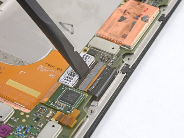

    • Peel away the yellow tape covering the display ZIF connector.
    • Use the flat end of a spudger to gently flip up the ZIF connector lock.
    • The ZIF lock is prone to breaking due to its width.
  24. Motorola Droid Turbo 2 LCD Screen and Digitizer Assembly Replacement: step 24, image 1 of 2 Motorola Droid Turbo 2 LCD Screen and Digitizer Assembly Replacement: step 24, image 2 of 2
    Tool used on this step:
    Buy
    • Use a spudger or tweezers to walk the flat cable out of the ZIF connector.

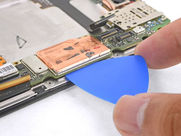

  27. Motorola Droid Turbo 2 LCD Screen and Digitizer Assembly Replacement: step 27, image 1 of 3 Motorola Droid Turbo 2 LCD Screen and Digitizer Assembly Replacement: step 27, image 2 of 3 Motorola Droid Turbo 2 LCD Screen and Digitizer Assembly Replacement: step 27, image 3 of 3
    • Slide an opening pick underneath the motherboard below the copper shield.
    • Twist the pick slightly to release the adhesive tape securing the motherboard to the frame.

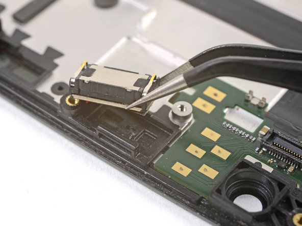

  30. Motorola Droid Turbo 2 LCD Screen and Digitizer Assembly Replacement: step 30, image 1 of 2 Motorola Droid Turbo 2 LCD Screen and Digitizer Assembly Replacement: step 30, image 2 of 2
    • The earpiece speaker module is very delicate and prone to breaking. Be gentle when handling the module.
    • Insert a pointed end of a pair of tweezers into a corner as far down as possible.
    • Pry very slightly to help loosen the earpiece speaker module.
    • Repeat the process in the remaining corners.
  31. Motorola Droid Turbo 2 LCD Screen and Digitizer Assembly Replacement: step 31, image 1 of 3 Motorola Droid Turbo 2 LCD Screen and Digitizer Assembly Replacement: step 31, image 2 of 3 Motorola Droid Turbo 2 LCD Screen and Digitizer Assembly Replacement: step 31, image 3 of 3
    • Continue to pry with the point of a pair of tweezers until the earpiece module feels loose.
    • Remove the earpiece module and transfer it to the new display frame.
