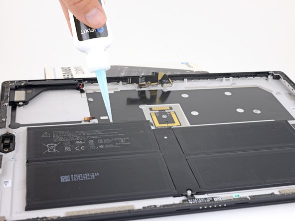

      • Prop the top edge of the Surface up a couple inches so the whole Surface slopes towards the bottom edge.
      • Apply adhesive remover or high-concentration (90% or higher) isopropyl alcohol to the top edge of the battery.
      • If you are using adhesive remover, follow these preparation steps first.
      • Let the adhesive remover sit and soak into the adhesive for 2–3 minutes before continuing.

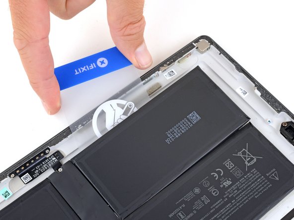

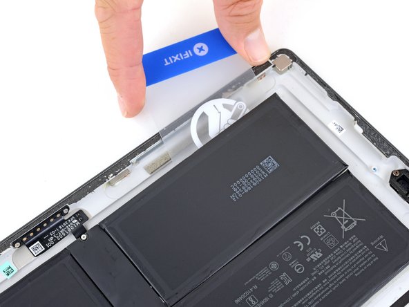

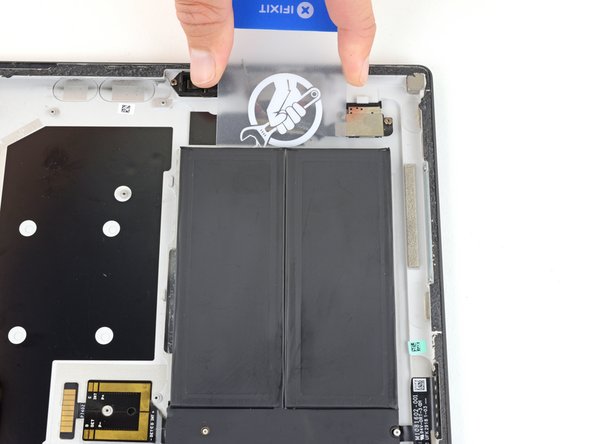

      • Take care not to puncture or bend the battery with your tools—a punctured or bent battery may leak dangerous chemicals or cause a thermal event.
      • Slide a plastic card under the left side of the top edge of the battery.
      • If you encounter significant resistance at any point during this procedure, stop, apply a little more adhesive remover, and wait for it to soak in.
      • Slide the card side to side under the upper left battery cell to slice through the adhesive underneath.
      Ask FixBot

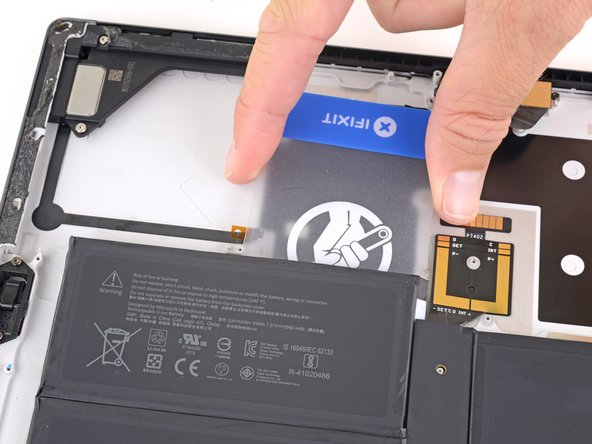

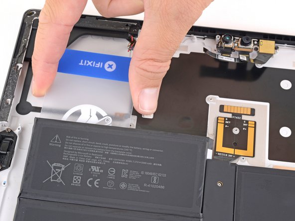

      • Slide the plastic card around the left edge of the battery and under the bottom left battery cell.
      • Slide the card side to side under the bottom left cell to slice through the adhesive underneath.

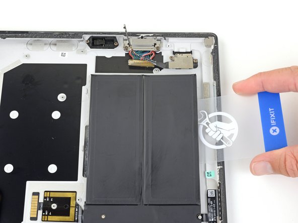

      • Repeat the previous two steps for the right side of the battery to release the two right cells from their adhesive.

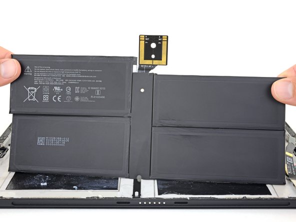

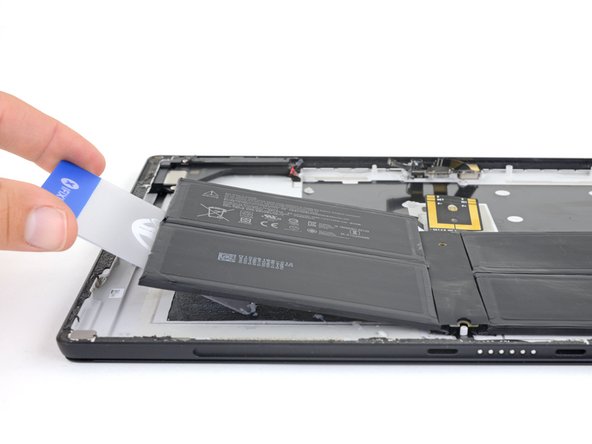

      • Lift each side of the battery with a plastic card and make sure all the adhesive is separated from the battery.
      • Gently lift the battery out of the case.
      • Do not reuse the battery after it has been removed, as doing so is a potential safety hazard. Replace it with a new battery.
      • During reassembly, follow this guide to clean off old adhesive and apply new adhesive from a pre-cut adhesive card.
