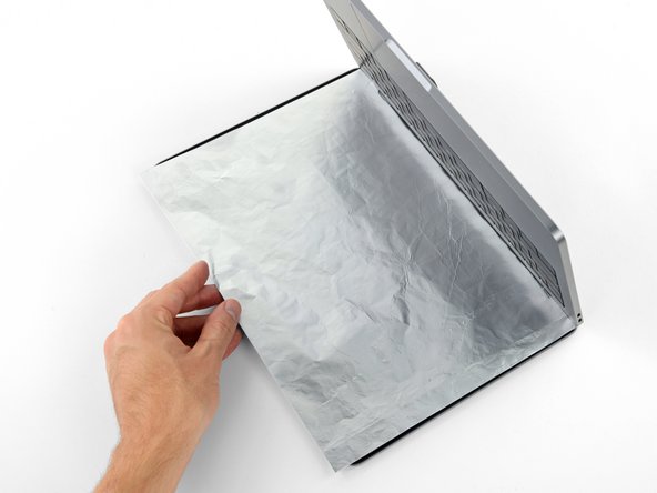

    1. MacBook Pro 13" Retina Display Early 2015 Battery Replacement, Battery: step 22, image 1 of 1
      • The liquid adhesive remover provided in your iFixit battery replacement kit can affect the antireflective coating on your MacBook Pro's display.
      • To protect your display, place a sheet of aluminum foil between the display and keyboard and leave it there while you work.
      Ask FixBot

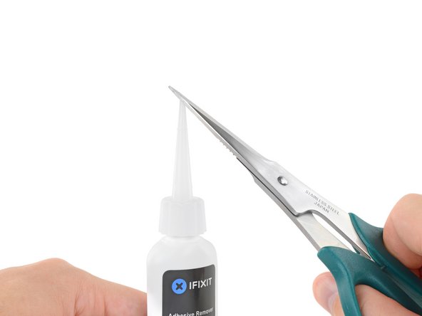

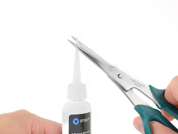

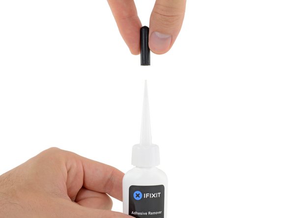

    3. MacBook Pro 13" Retina Display Early 2015 Battery Replacement: step 24, image 1 of 3 MacBook Pro 13" Retina Display Early 2015 Battery Replacement: step 24, image 2 of 3 MacBook Pro 13" Retina Display Early 2015 Battery Replacement: step 24, image 3 of 3
      • Pull off the black rubber stopper from your bottle of adhesive remover.
      • Twist to loosen or remove the bottle cap before you cut the applicator tip.
      • This unseals the bottle and allows the pressure to equalize before you cut the applicator tip. If you skip this step, the adhesive remover may spray out unexpectedly when the tip is cut.
      • Use scissors to cut off the sealed tip of the applicator.
      • Cutting close to the narrow tip will give you better control so you can apply the adhesive remover in small amounts.
      • Twist and close the bottle cap securely before you proceed further.

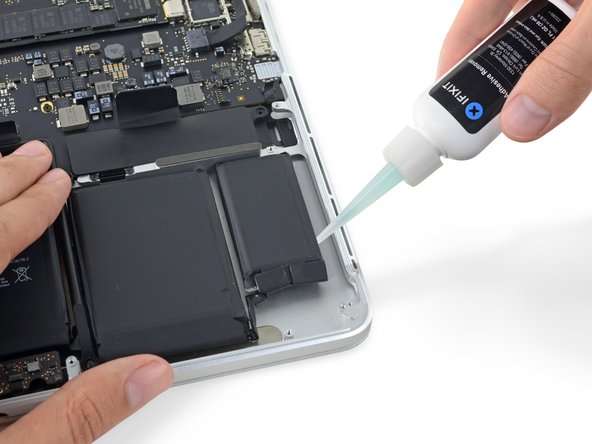

    4. MacBook Pro 13" Retina Display Early 2015 Battery Replacement: step 25, image 1 of 1
      • Apply a few drops of adhesive remover evenly under the edge of the rightmost battery cell.
      • You don't need to use very much. The small bottle contains more than twice the amount of solvent needed to remove all the battery cells.
      • Wait 2-3 minutes for the liquid adhesive remover to penetrate underneath the battery cell before you proceed to the next step.
      Ask FixBot

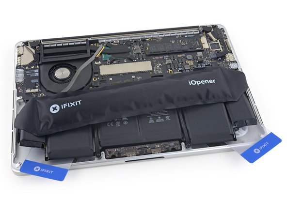

    5. MacBook Pro 13" Retina Display Early 2015 Battery Replacement: step 26, image 1 of 2 MacBook Pro 13" Retina Display Early 2015 Battery Replacement: step 26, image 2 of 2
      • If you don't have a liquid adhesive remover, you'll be using a hot iOpener to warm and soften a section of the adhesive securing the battery to the upper case, and then carefully prying at that point.
      • Use the hot iOpener to cover half of the right-most battery cells.
      • After about a minute, reheat the iOpener and move it to cover the other half of the right-most battery cells.
      Ask FixBot

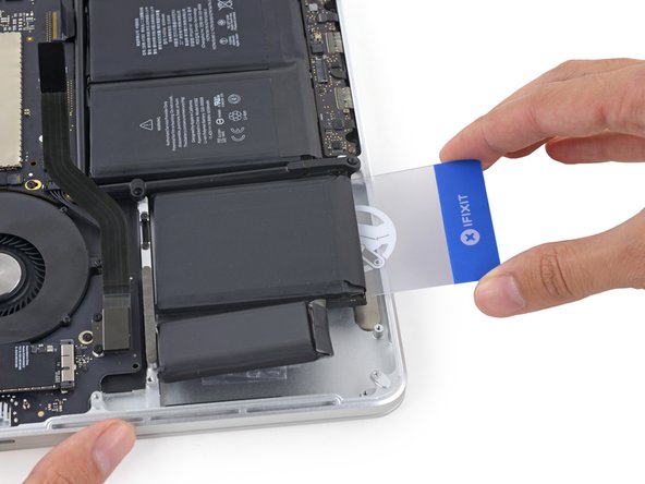

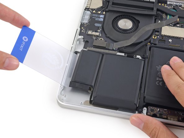

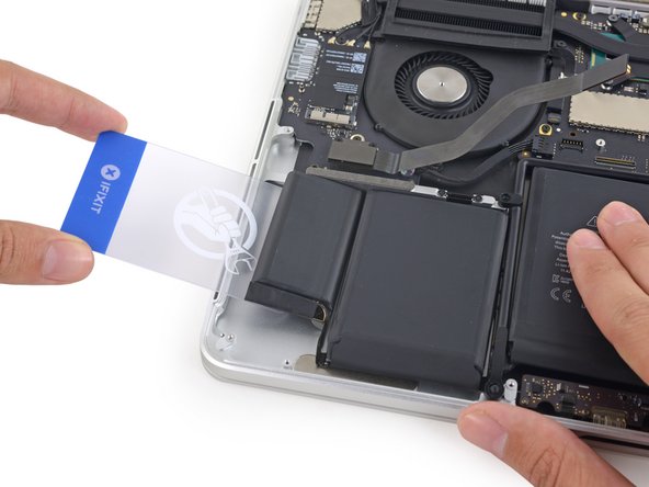

    6. MacBook Pro 13" Retina Display Early 2015 Battery Replacement: step 27, image 1 of 3 MacBook Pro 13" Retina Display Early 2015 Battery Replacement: step 27, image 2 of 3 MacBook Pro 13" Retina Display Early 2015 Battery Replacement: step 27, image 3 of 3
      Tool used on this step:
      Plastic Cards
      $2.99
      Buy
      • Push a plastic card between the right-most battery cell and the upper case, cutting the adhesive between the two.
      • Throughout this procedure, be careful not to damage any of the battery cells with your tools. A damaged lithium-ion battery may leak dangerous chemicals and/or catch fire. Use only plastic pry tools.
      • When using the hot iOpener method, if you encounter significant resistance to prying, stop and use the iOpener to reheat the section you're working on.
      Ask FixBot

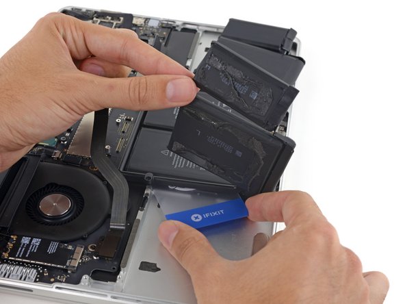

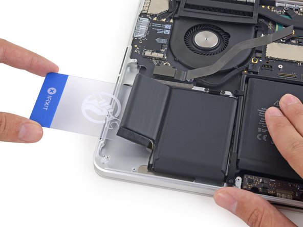

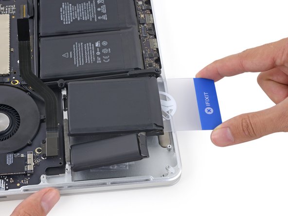

    7. MacBook Pro 13" Retina Display Early 2015 Battery Replacement: step 28, image 1 of 3 MacBook Pro 13" Retina Display Early 2015 Battery Replacement: step 28, image 2 of 3 MacBook Pro 13" Retina Display Early 2015 Battery Replacement: step 28, image 3 of 3
      • Repeat this procedure with the adjacent battery cell:
      • Apply a small amount of liquid adhesive remover under the battery cell, and wait 2-3 minutes for it to penetrate and soften the adhesive.
      • Alternatively, re-heat this section with your iOpener if needed.
      • Push a plastic card about an inch between the battery cell and the upper case, and slowly pry the cell up to separate all of the adhesive.
      Ask FixBot

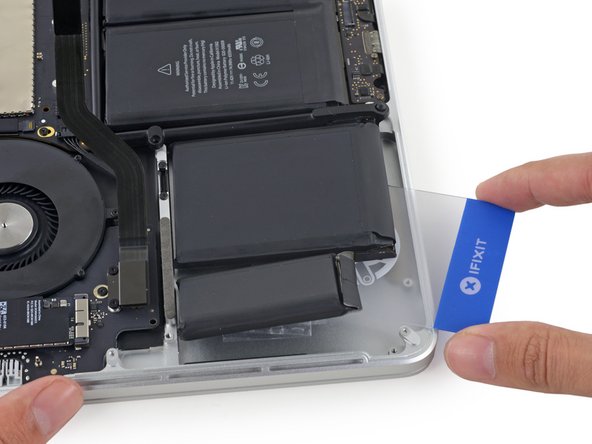

    9. MacBook Pro 13" Retina Display Early 2015 Battery Replacement: step 30, image 1 of 3 MacBook Pro 13" Retina Display Early 2015 Battery Replacement: step 30, image 2 of 3 MacBook Pro 13" Retina Display Early 2015 Battery Replacement: step 30, image 3 of 3
      • Repeat the above procedure to separate the two leftmost battery cells from the upper case.
      • Remember to apply a small amount of adhesive remover to each battery cell, and wait 2-3 minutes for it to penetrate and soften the adhesive.
      • Use a second plastic card to separate the two leftmost battery cells from the upper case.
      Ask FixBot

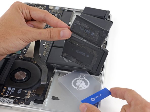

    12. MacBook Pro 13" Retina Display Early 2015 Battery Replacement: step 33, image 1 of 3 MacBook Pro 13" Retina Display Early 2015 Battery Replacement: step 33, image 2 of 3 MacBook Pro 13" Retina Display Early 2015 Battery Replacement: step 33, image 3 of 3
      • If using liquid adhesive remover, apply a few more drops under each of the final two, middle cells.
      • It may help to elevate one side of your MacBook Pro a few inches so that the adhesive remover flows in the correct direction, underneath the battery cells. You can use a sturdy book or foam block to prop up one side of your MacBook Pro while you work.
      • Allow 2-3 minutes for the adhesive remover to penetrate before you continue.
      • Gently folding the right-most battery cells out of the way, insert a plastic card under the right center cell.
      • Push the card in about half of its length to cut the adhesive holding the battery cell to the case.
      • Be sure to avoid the trackpad control board. Aim the card up toward the logic board, where the adhesive is.
      • Leave the card in place to keep the adhesive from re-sealing.
      Ask FixBot

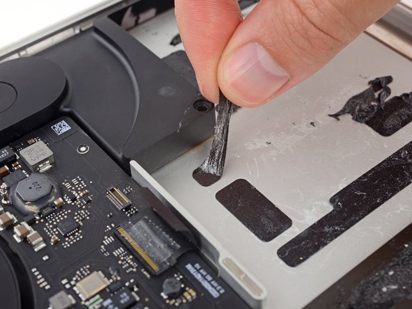

    13. MacBook Pro 13" Retina Display Early 2015 Battery Replacement: step 34, image 1 of 3 MacBook Pro 13" Retina Display Early 2015 Battery Replacement: step 34, image 2 of 3 MacBook Pro 13" Retina Display Early 2015 Battery Replacement: step 34, image 3 of 3
      • Repeat the same procedure for the last remaining battery cell.
      • Holding the outer cells out of the way, insert the plastic card about halfway under the left center battery cell, avoiding the trackpad board.
      Ask FixBot
    14. MacBook Pro 13" Retina Display Early 2015 Battery Replacement: step 35, image 1 of 2 MacBook Pro 13" Retina Display Early 2015 Battery Replacement: step 35, image 2 of 2
      • Return to the card beneath the right-center cell, and twist it to separate the entire battery from the upper case.
      • By now you should have cut all of the adhesive securing the battery to the upper case, and it should come out freely.
      • If it does not come out easily, you may need to reheat the iOpener and apply it to the stuck areas, and then continue gently cutting the adhesive with the plastic cards.
      Ask FixBot
    15. MacBook Pro 13" Retina Display Early 2015 Battery Replacement: step 36, image 1 of 2 MacBook Pro 13" Retina Display Early 2015 Battery Replacement: step 36, image 2 of 2
      • Remove the battery.
      • Before installing your new battery, remove all the old adhesive from the MacBook Pro's case.
      • With a little luck, you can slowly pull out each strip of adhesive with your fingers.
      • Otherwise, soak each section of adhesive with a bit of adhesive remover for 2-3 minutes, and then scrape it out with an opening pick or one of the other tools in your kit. This can take quite a bit of work, so be patient.
      • Mop up any remaining adhesive remover and give your MacBook Pro a few minutes to air dry.
      • The replacement battery included in your iFixit kit comes with adhesive pre-installed. Test the battery's fit and alignment carefully before peeling off the film covering the adhesive, and then press each cell firmly into place. If any additional films/liners are present that weren't on your original battery, remove them last.
