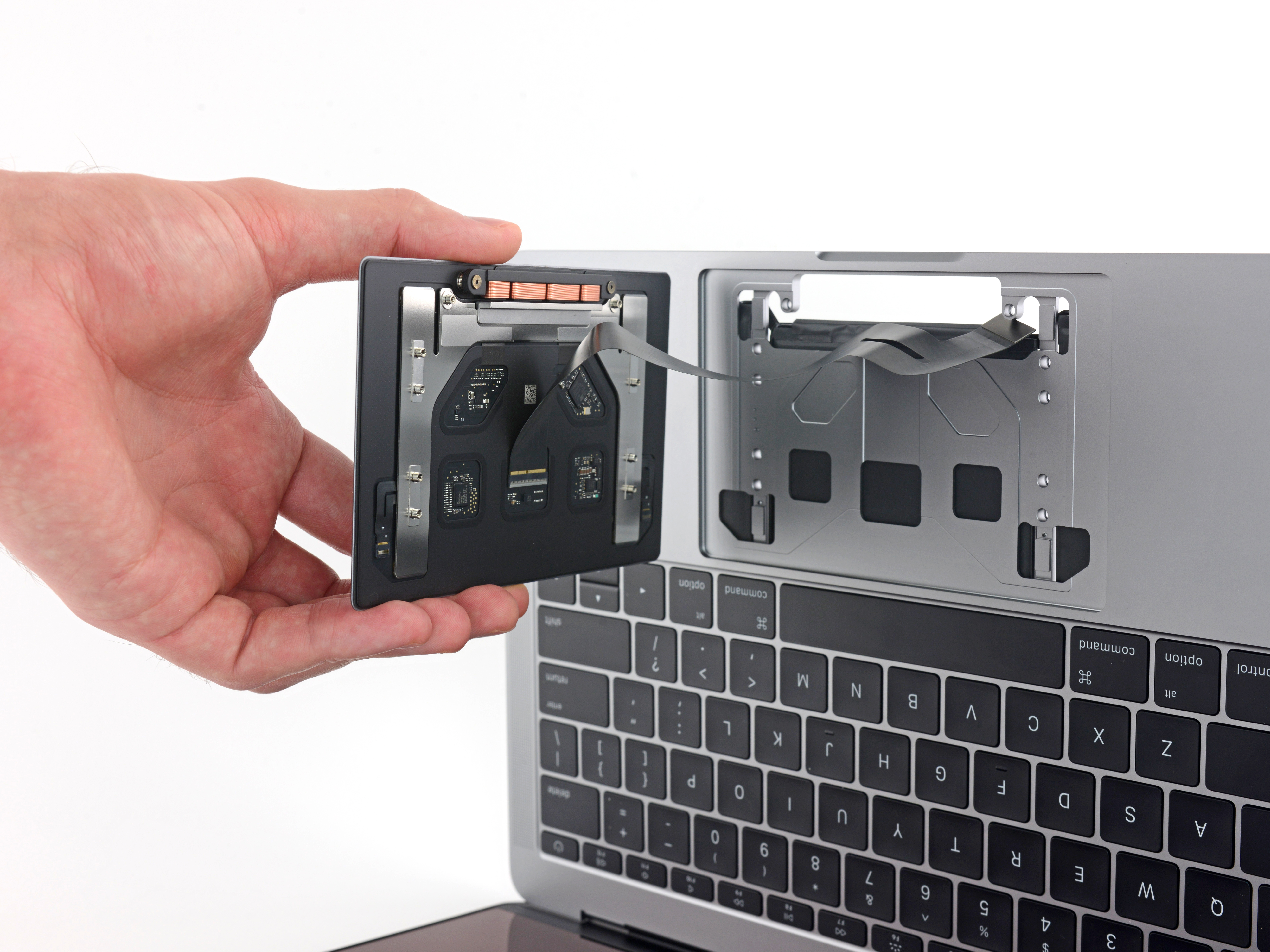

    7. MacBook Pro 13" Function Keys 2017 Battery Replacement: step 22, image 1 of 3 MacBook Pro 13" Function Keys 2017 Battery Replacement: step 22, image 2 of 3 MacBook Pro 13" Function Keys 2017 Battery Replacement: step 22, image 3 of 3
      • Remove the trackpad assembly.
      • You'll need to swing the display open slightly to remove the trackpad.
      • Take care to feed the trackpad ribbon cable through the MacBook Pro's frame without snagging.
      • Be sure not to lose the six small washers (two circular and four rectangular) resting on the underside of the trackpad.
      Ask FixBot
