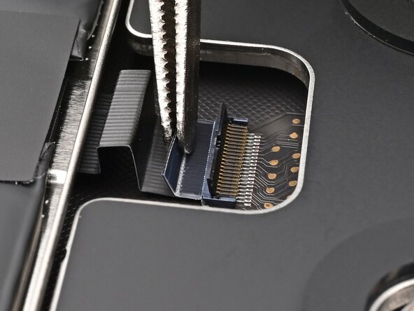

    1. MacBook Neo Trackpad Replacement, Disconnect the trackpad: step 8, image 1 of 2 MacBook Neo Trackpad Replacement, Disconnect the trackpad: step 8, image 2 of 2
      • Use the flat end of a spudger to lift the hinged locking flap on the trackpad cable ZIF connector.
      Ask FixBot
    2. MacBook Neo Trackpad Replacement: step 9, image 1 of 2 MacBook Neo Trackpad Replacement: step 9, image 2 of 2
      • Use tweezers or your fingers to gently pull the trackpad cable out of its socket.
      Ask FixBot

    5. MacBook Neo Trackpad Replacement, Connect the trackpad: step 19, image 1 of 3 MacBook Neo Trackpad Replacement, Connect the trackpad: step 19, image 2 of 3 MacBook Neo Trackpad Replacement, Connect the trackpad: step 19, image 3 of 3
      • Make sure the locking flap is flipped up and gently insert the trackpad cable into its socket.
      • Flip the locking flap down to secure the cable.
      Ask FixBot
