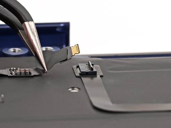

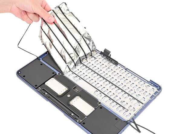

    11. MacBook Neo Keyboard Replacement, Lift the keyboard cable cover: step 34, image 1 of 2 MacBook Neo Keyboard Replacement, Lift the keyboard cable cover: step 34, image 2 of 2
      • Don't tear or fully remove this cover—it'll be used to disconnect the cable.
      • Use tweezers to peel up the black sticker over the keyboard cable, just until it comes off the socket on the board. Make sure it stays attached to the cable.
      Ask FixBot

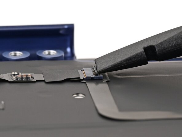

    12. MacBook Neo Keyboard Replacement, Disconnect the keyboard: step 35, image 1 of 2 MacBook Neo Keyboard Replacement, Disconnect the keyboard: step 35, image 2 of 2
      • Use the flat end of a spudger to flip up the hinged locking flap on the keyboard cable ZIF connector.
      Ask FixBot
    13. MacBook Neo Keyboard Replacement: step 36, image 1 of 2 MacBook Neo Keyboard Replacement: step 36, image 2 of 2
      • Use tweezers or your fingers to gently grip the keyboard cable by its cover and slide the cable out of its socket.
      Ask FixBot

    26. MacBook Neo Keyboard Replacement, Disconnect the Touch ID cable: step 49, image 1 of 3 MacBook Neo Keyboard Replacement, Disconnect the Touch ID cable: step 49, image 2 of 3 MacBook Neo Keyboard Replacement, Disconnect the Touch ID cable: step 49, image 3 of 3
      • Use the flat end of a spudger to pry up the hinged locking flap on the Touch ID interconnect cable.
      • Use tweezers or your fingers to pull the Touch ID cable out of its socket.
      Ask FixBot

    29. MacBook Neo Keyboard Replacement, Peel up the keyboard shield: step 52, image 1 of 3 MacBook Neo Keyboard Replacement, Peel up the keyboard shield: step 52, image 2 of 3 MacBook Neo Keyboard Replacement, Peel up the keyboard shield: step 52, image 3 of 3
      • In the next two steps, you'll destructively remove the keyboard shield. Try not to tear the shield—it's easier to remove in one piece.
      • Be careful not to damage any of the flex cables surrounding the keyboard shield as you remove it.
      • Use the point of a spudger to pry up the keyboard shield until you can grab it with tweezers.
      Ask FixBot
    30. MacBook Neo Keyboard Replacement: step 53, image 1 of 3 MacBook Neo Keyboard Replacement: step 53, image 2 of 3 MacBook Neo Keyboard Replacement: step 53, image 3 of 3
      • Use tweezers to slowly peel up an entire edge of the keyboard shield so you can grab it with your fingers.
      Ask FixBot
    31. MacBook Neo Keyboard Replacement: step 54, image 1 of 3 MacBook Neo Keyboard Replacement: step 54, image 2 of 3 MacBook Neo Keyboard Replacement: step 54, image 3 of 3
      • Peel up the keyboard shield at a low angle. Try to lift it in one large piece.
      Ask FixBot
    32. MacBook Neo Keyboard Replacement, Remove the keyboard shield: step 55, image 1 of 3 MacBook Neo Keyboard Replacement, Remove the keyboard shield: step 55, image 2 of 3 MacBook Neo Keyboard Replacement, Remove the keyboard shield: step 55, image 3 of 3
      • Peel off the entire keyboard shield. Try to keep it in one piece.
      • If the shield tears, peel up any remnants off the laptop.
      Ask FixBot
