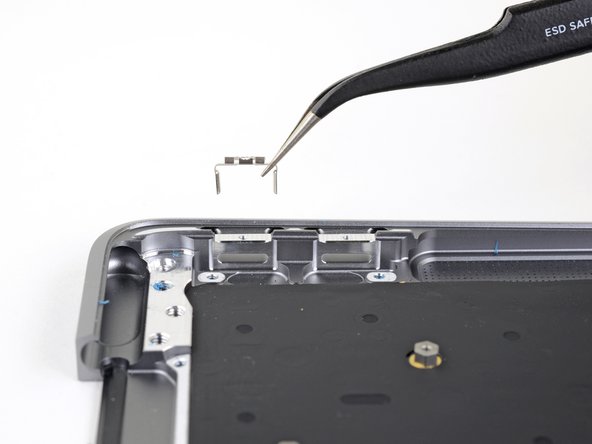

  25. MacBook Air 13” Retina Display Late 2018 Upper Case Replacement, Disconnect the antenna bar: step 25, image 1 of 2 MacBook Air 13” Retina Display Late 2018 Upper Case Replacement, Disconnect the antenna bar: step 25, image 2 of 2
    • Use a T3 Torx driver to remove the two 1.4 mm screws securing the antenna cable bracket.
    • Remove the antenna cable bracket.

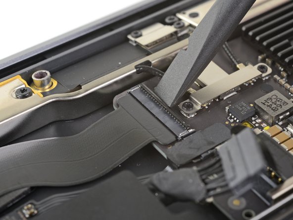

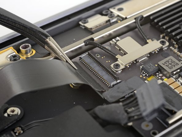

  28. MacBook Air 13” Retina Display Late 2018 Upper Case Replacement: step 28, image 1 of 2 MacBook Air 13” Retina Display Late 2018 Upper Case Replacement: step 28, image 2 of 2
    • Use the flat end of a spudger to pry up the display cable connector.

  46. MacBook Air 13” Retina Display Late 2018 Upper Case Replacement, Disconnect the keyboard: step 46, image 1 of 3 MacBook Air 13” Retina Display Late 2018 Upper Case Replacement, Disconnect the keyboard: step 46, image 2 of 3 MacBook Air 13” Retina Display Late 2018 Upper Case Replacement, Disconnect the keyboard: step 46, image 3 of 3
    • Use the flat end of a spudger to lift the small locking flap on the keyboard ZIF connector.
    • The trackpad cable connects the logic board to both the keyboard and the trackpad.
    • Slide the keyboard cable straight out of its connector.
  47. MacBook Air 13” Retina Display Late 2018 Upper Case Replacement, Separate the trackpad cable adhesive: step 47, image 1 of 2 MacBook Air 13” Retina Display Late 2018 Upper Case Replacement, Separate the trackpad cable adhesive: step 47, image 2 of 2
    • Carefully slide an opening pick under the trackpad cable to separate the adhesive securing it to the battery.
    • If you have difficulty separating the adhesive, heat it slightly with an iOpener or hair dryer. Be careful not to overheat the battery.

  62. MacBook Air 13” Retina Display Late 2018 Upper Case Replacement, Remove the USB-C port brackets: step 62, image 1 of 2 MacBook Air 13” Retina Display Late 2018 Upper Case Replacement, Remove the USB-C port brackets: step 62, image 2 of 2
    • Lift the USB-C port brackets out of their recesses in the upper case and remove them.
    • Compare your new upper case to your old one and transfer over any remaining parts.
