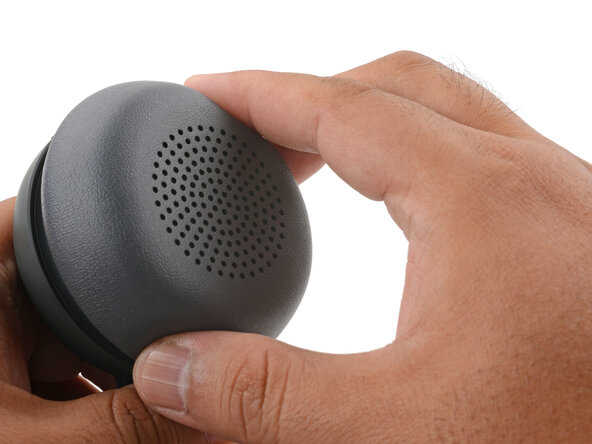

    2. Logitech Zone Wireless 2 Battery Replacement, Remove the ear pad: step 2, image 1 of 3 Logitech Zone Wireless 2 Battery Replacement, Remove the ear pad: step 2, image 2 of 3 Logitech Zone Wireless 2 Battery Replacement, Remove the ear pad: step 2, image 3 of 3
      • If you're replacing the battery, you only need to remove the ear pad from the side that doesn't have the boom mic.
      • With one hand, firmly hold the ear cup steady.
      • With your free hand, twist the ear pad counter-clockwise until it feels loose.
      • Remove the ear pad.
