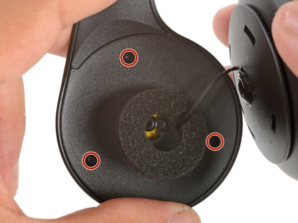

    6. Logitech Zone 301 Battery Replacement, Remove the midplate screws: step 8, image 1 of 1
      • Use a Phillips screwdriver to remove the three 5.3 mm‑long screws securing the midplate.
      Ask FixBot

    16. Logitech Zone 301 Battery Replacement, Install the midplate: step 18, image 1 of 2 Logitech Zone 301 Battery Replacement, Install the midplate: step 18, image 2 of 2
      • Swing the midplate back in place over the ear cup.
      Ask FixBot
    17. Logitech Zone 301 Battery Replacement: step 19, image 1 of 1
      • Use a Phillips screwdriver to install the three 5.3 mm‑long screws to secure the midplate.
      • Make sure the midplate isn't pinching any wires.
      Ask FixBot
