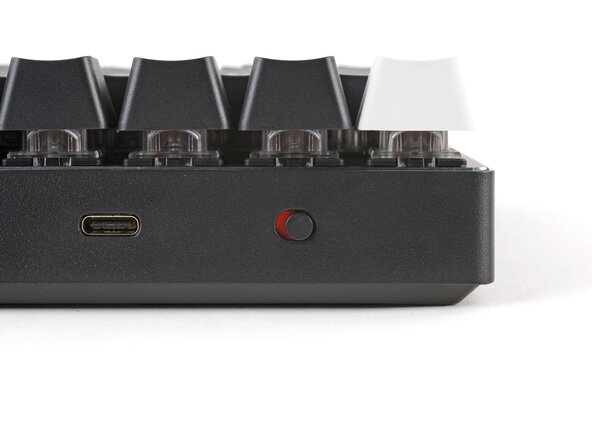

    1. Logitech Pro X 60 Battery Replacement, Prepare your keyboard for disassembly: step 1, image 1 of 3 Logitech Pro X 60 Battery Replacement, Prepare your keyboard for disassembly: step 1, image 2 of 3 Logitech Pro X 60 Battery Replacement, Prepare your keyboard for disassembly: step 1, image 3 of 3
      • Slide the power switch on the top edge of the keyboard to the OFF position.
      • A red indicator should be visible beneath the switch.
      • Unplug all cables from your keyboard.

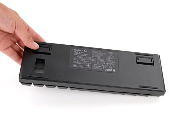

    1. Logitech Pro X 60 Battery Replacement, Remove the sticker: step 2, image 1 of 2 Logitech Pro X 60 Battery Replacement, Remove the sticker: step 2, image 2 of 2
      • The Logitech sticker hides two battery cover screws.
      • Heat an iOpener and lay it on the Logitech sticker for one minute.
      • Alternatively, you can use a hair dryer to heat the sticker. Make sure it's on the Low setting to avoid warping the plastic.

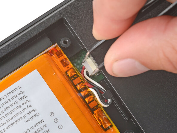

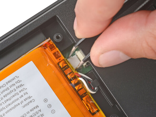

    5. Logitech Pro X 60 Battery Replacement, Disconnect the battery: step 6, image 1 of 3 Logitech Pro X 60 Battery Replacement, Disconnect the battery: step 6, image 2 of 3 Logitech Pro X 60 Battery Replacement, Disconnect the battery: step 6, image 3 of 3
      • Use a pair of angled tweezers to firmly grip the battery connector.
      • Hold the tweezers with your fingers as close to the connector as possible to get a firm hold.
      • Gently rock the connector side‑to‑side and slide it straight out of the socket.
