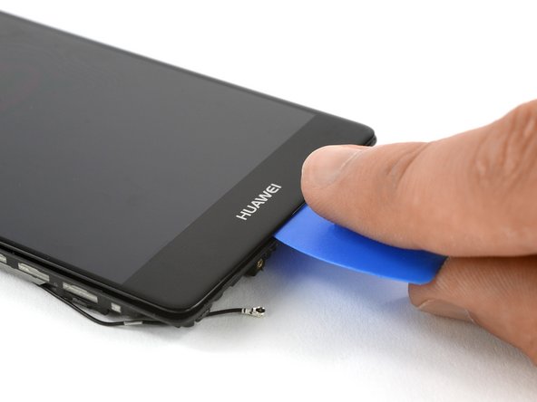

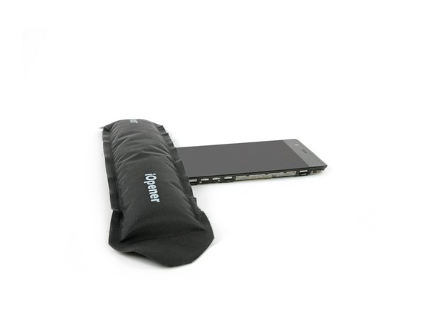

    1. Huawei P9 Plus Display Replacement, Display: step 15, image 1 of 2 Huawei P9 Plus Display Replacement, Display: step 15, image 2 of 2
      • Use an iOpener to loosen the adhesive under the display of your phone. It is mainly placed around the edge of the display.
      • After you have heated the sides, concentrate on the bottom part.
      • The adhesive is very sticky. Take your time to heat it up properly.

    2. Huawei P9 Plus Display Replacement: step 16, image 1 of 3 Huawei P9 Plus Display Replacement: step 16, image 2 of 3 Huawei P9 Plus Display Replacement: step 16, image 3 of 3
      Tool used on this step:
      Halberd Spudger
      $2.99
      Buy
      • Insert an opening pick between the mid frame and the display.
      • Slide along the bottom to loosen the adhesive.
      • If the adhesive was heated properly you can separate the display from the mid frame by turning the opening pick sideways.
      • If you can't separate the display easily, re-heat the iOpener and repeat the procedure. You may also want to use an Halberd spudger to carefully slide around the whole display frame to loosen the adhesive a little bit more.
