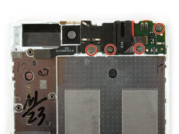

    2. Huawei P8 Display with Frame Replacement: step 17, image 1 of 3 Huawei P8 Display with Frame Replacement: step 17, image 2 of 3 Huawei P8 Display with Frame Replacement: step 17, image 3 of 3
      • Remove the power and volume button flex cable.
      • Remove the four Phillips #00 screws.
      • Use a tweezer to remove the plastic bracket which is covering the corner of the headphone jack.
      Ask FixBot

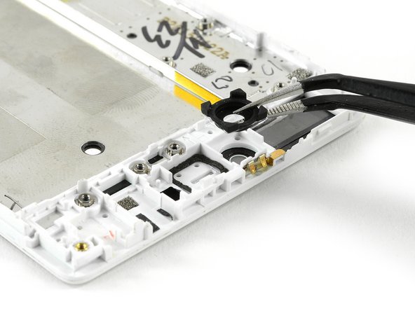

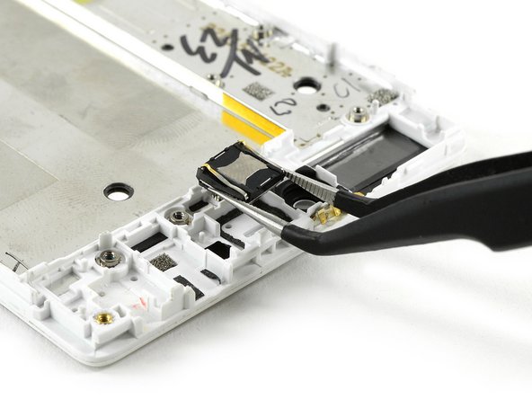

    4. Huawei P8 Display with Frame Replacement: step 19, image 1 of 3 Huawei P8 Display with Frame Replacement: step 19, image 2 of 3 Huawei P8 Display with Frame Replacement: step 19, image 3 of 3
      • Remove the gasket which was placed under the daughterboard in the top right corner of your phone.
      • Remove the earpiece speaker with a tweezer. Take care of its connectors while doing so.
      • Remove the front camera gasket.
      Ask FixBot
