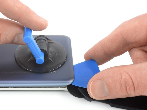

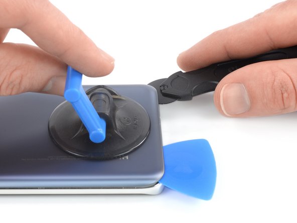

    2. Huawei P40 Pro Screen Replacement, Insert an opening wheel: step 2, image 1 of 3 Huawei P40 Pro Screen Replacement, Insert an opening wheel: step 2, image 2 of 3 Huawei P40 Pro Screen Replacement, Insert an opening wheel: step 2, image 3 of 3
      • Since the rear glass of the Huawei P40 Pro is curved, we highly recommend to slice the adhesive with a softer plastic tool like the iMac opening wheel before working with opening picks to prevent the rear glass from shattering.
      • Secure a suction handle to the bottom edge of the rear glass, as close to the curved edge as possible.
      • If your rear glass is badly cracked, covering it with a layer of clear packing tape may allow the suction cup to adhere. Alternatively, very strong tape may be used instead of the suction cup. If all else fails, you can superglue the suction cup to the rear glass.
      • Lift the back cover with the suction handle to create a small gap between the back cover and the frame.
      • In case you have trouble creating a gap, apply more heat to further soften the adhesive. Follow the iOpener instructions to avoid overheating.
      • Insert an iMac opening wheel into the gap.
      • Slide the opening wheel to the bottom left corner to slice the adhesive.

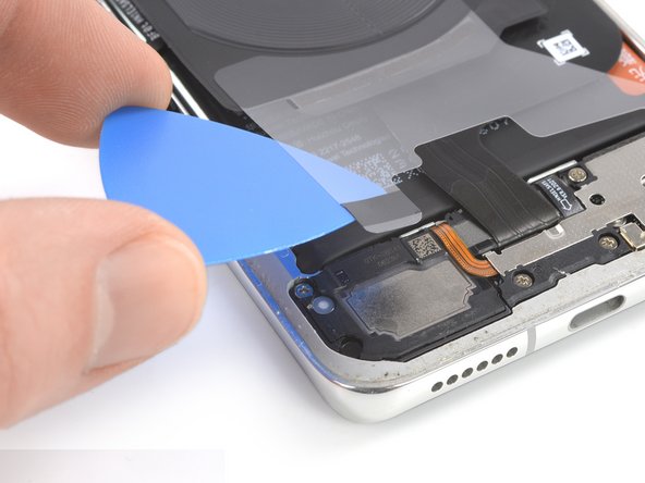

    2. Huawei P40 Pro Screen Replacement, Peel off the protective foil: step 10, image 1 of 3 Huawei P40 Pro Screen Replacement, Peel off the protective foil: step 10, image 2 of 3 Huawei P40 Pro Screen Replacement, Peel off the protective foil: step 10, image 3 of 3
      • Slide an opening pick underneath the bottom right corner of the protective foil.
      • Use the opening pick to gently peel the protective foil off the daughterboard cover.
      • Repeat the previous procedure to peel the bottom left protective foil corner off the speaker.

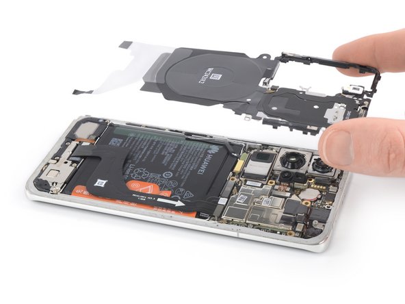

    3. Huawei P40 Pro Screen Replacement, Pry up the midframe: step 11, image 1 of 2 Huawei P40 Pro Screen Replacement, Pry up the midframe: step 11, image 2 of 2
      • The left side of the midframe is very fragile. Take your time prying it up to prevent breaking it.
      • Slide an opening pick underneath the bottom left corner of the plastic midframe.
      • Slide the opening pick along the left edge of the midframe to release the plastic clips holding it in place.
      Ask FixBot
    4. Huawei P40 Pro Screen Replacement: step 12, image 1 of 3 Huawei P40 Pro Screen Replacement: step 12, image 2 of 3 Huawei P40 Pro Screen Replacement: step 12, image 3 of 3
      • Insert the tip of an opening pick at the top edge of the midframe next to the top left corner.
      • Tilt the opening pick downwards to pop the plastic clips out of their sockets.
      • Slide the opening pick along the top edge of the midframe to release the remaining plastic clips.
      Ask FixBot
    5. Huawei P40 Pro Screen Replacement, Remove the midframe: step 13, image 1 of 2 Huawei P40 Pro Screen Replacement, Remove the midframe: step 13, image 2 of 2
      • Remove the midframe.
      Ask FixBot

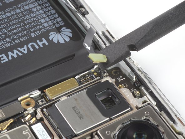

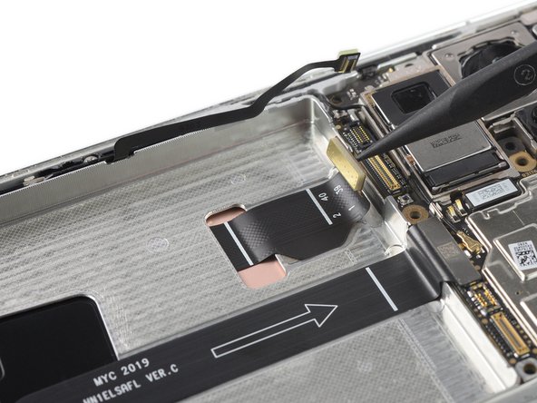

    1. Huawei P40 Pro Screen Replacement, Disconnect the antenna cable: step 16, image 1 of 2 Huawei P40 Pro Screen Replacement, Disconnect the antenna cable: step 16, image 2 of 2
      • Use a spudger tor pry up and disconnect the antenna flex cable.
      Ask FixBot

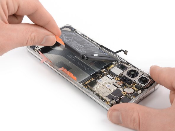

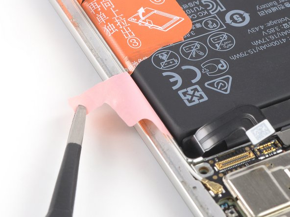

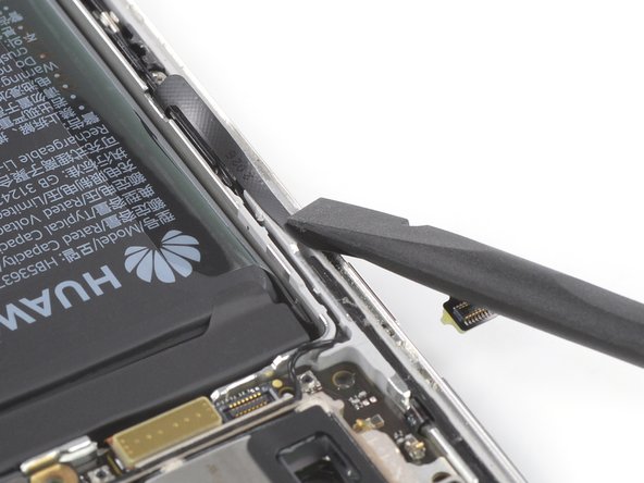

    4. Huawei P40 Pro Screen Replacement, Peel the pull tabs off the battery: step 19, image 1 of 2 Huawei P40 Pro Screen Replacement, Peel the pull tabs off the battery: step 19, image 2 of 2
      Tool used on this step:
      Buy
      • Take care not to puncture or bend the battery with your tool—a punctured or bent battery may leak dangerous chemicals or cause a thermal event.
      • Use a pair of blunt nose tweezers or a clean fingernail to peel the orange adhesive strip labelled with a 1 off the battery.
      • The orange adhesive tape will rip along a small perforated line.
      Ask FixBot
    5. Huawei P40 Pro Screen Replacement: step 20, image 1 of 2 Huawei P40 Pro Screen Replacement: step 20, image 2 of 2
      • Use a pair of blunt nose tweezers or a clean fingernail to peel the orange adhesive strip labelled with a 2 off the battery.
      Ask FixBot
    6. Huawei P40 Pro Screen Replacement, Lift the battery out of its recess: step 21, image 1 of 2 Huawei P40 Pro Screen Replacement, Lift the battery out of its recess: step 21, image 2 of 2
      • Peel the orange adhesive strip labelled with a 3 off the battery.
      • Pull up on the orange adhesive strip to lift the battery out of its recess and swing it up to an upright position.
      • Although these adhesive tabs are supposed to make the battery removal easier, they may require some force. In case you're having trouble removing the battery, you can apply a heated iOpener to the center of the display to loosen the adhesive underneath.
      Ask FixBot
    7. Huawei P40 Pro Screen Replacement, Remove the battery: step 22, image 1 of 3 Huawei P40 Pro Screen Replacement, Remove the battery: step 22, image 2 of 3 Huawei P40 Pro Screen Replacement, Remove the battery: step 22, image 3 of 3
      • Peel the battery off the remaining adhesive.
      • Remove the battery.

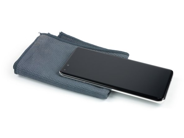

    2. Huawei P40 Pro Screen Replacement, Loosen the display adhesive: step 24, image 1 of 2 Huawei P40 Pro Screen Replacement, Loosen the display adhesive: step 24, image 2 of 2
      • Apply a heated iOpener or a heat gun to the screen to loosen the adhesive underneath. Apply the iOpener for at least two minutes.
      • The protective adhesive of the P40 Pro is very strong and hard to cut. It is likely that you have to reapply the iOpener after each of the following steps to soften the adhesive enough to cut it.
      • A hair dryer, heat gun, or hot plate may also be used, but be careful not to overheat the device.
      • Since the rear camera module sticks out of the midframe, we recommend placing a lint free cloth or similar underneath the camera module during the following steps in order to avoid damaging the lenses.

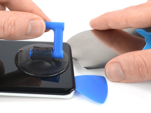

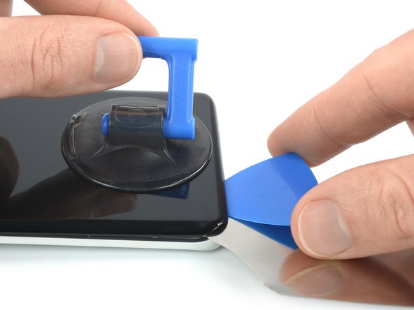

    3. Huawei P40 Pro Screen Replacement, Insert an iFlex: step 25, image 1 of 3 Huawei P40 Pro Screen Replacement, Insert an iFlex: step 25, image 2 of 3 Huawei P40 Pro Screen Replacement, Insert an iFlex: step 25, image 3 of 3
      • Since the screen of the Huawei P40 Pro is curved, we highly recommend slicing the adhesive with a flexible tool like the iFlex before working with opening picks to prevent the display glass from shattering.
      • Once the screen is warm to touch, apply a suction cup to the bottom edge of the screen.
      • If your screen is badly cracked, covering it with a layer of clear packing tape may allow the suction cup to adhere. Alternatively, very strong tape may be used instead of the suction cup. If all else fails, you can superglue the suction cup to the screen.
      • Lift the screen with the suction handle to create a small gap between the screen and the frame.
      • Insert an iFlex in the gap between the midframe and the screen.
      • Slide the iFlex to the bottom left corner of the screen to slice its adhesive.

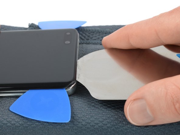

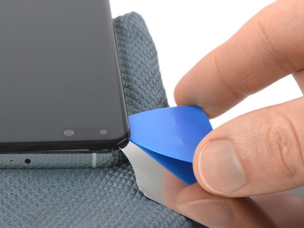

    4. Huawei P40 Pro Screen Replacement, Insert an opening pick: step 26, image 1 of 2 Huawei P40 Pro Screen Replacement, Insert an opening pick: step 26, image 2 of 2
      • Insert an opening pick next to the bottom left corner of the screen to prevent the adhesive from resealing.
      • Do not insert the opening pick right at the corner. An opening pick right at the corner puts more tension on the screen and makes it likely to shatter because of the curved display glass.
      Ask FixBot
    5. Huawei P40 Pro Screen Replacement, Slice the display adhesive: step 27, image 1 of 3 Huawei P40 Pro Screen Replacement, Slice the display adhesive: step 27, image 2 of 3 Huawei P40 Pro Screen Replacement, Slice the display adhesive: step 27, image 3 of 3
      • Relocate the iFlex to the center of the bottom edge and slide it to the bottom right corner of the screen to slice the display adhesive.
      • Insert an opening pick next to the bottom right corner of the screen to prevent the adhesive from resealing.

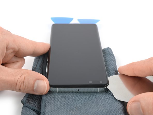

    6. Huawei P40 Pro Screen Replacement: step 28, image 1 of 3 Huawei P40 Pro Screen Replacement: step 28, image 2 of 3 Huawei P40 Pro Screen Replacement: step 28, image 3 of 3
      • If the adhesive becomes hard to cut, it has most likely cooled down. Use your iOpener to reheat it.
      • Insert the iFlex next to the bottom left corner of the screen.
      • Slide the iFlex along the left edge of your Huawei P40 Pro to slice the adhesive.
      • When you slice near the front facing camera, insert only the tip of the iFlex (about 3 mm) to avoid damaging or smearing the camera.
      • Insert the iFlex next to the top left corner of the screen.
      • Slide the iFlex along the top edge of your phone to cut the remaining adhesive.
      • Do not try to remove the display all the way yet. The display cable is still threaded through the frame.
