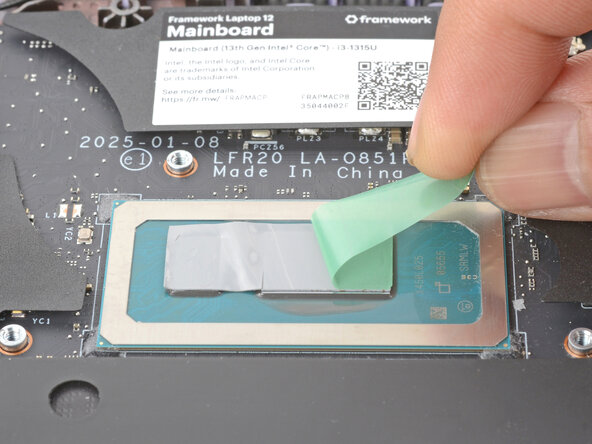

  13. How to Replace the Thermal Pad In Your Framework Laptop 12, Install a thermal pad: step 13, image 1 of 2 How to Replace the Thermal Pad In Your Framework Laptop 12, Install a thermal pad: step 13, image 2 of 2
    • The next two steps show how to install a thermal pad. If you're using thermal paste instead, skip down two steps.
    • The thermal pad is covered with liners on both sides.
    • Use your fingers to carefully remove the thermal pad and liners from its container.
    • Peel the stiffer, clear liner away from the thermal pad.
    • If you have trouble handling your thermal pad, place it in your fridge for a few minutes to make it more rigid.
  14. How to Replace the Thermal Pad In Your Framework Laptop 12: step 14, image 1 of 2 How to Replace the Thermal Pad In Your Framework Laptop 12: step 14, image 2 of 2
    • Place the thermal pad over the processor, making sure it covers both raised blocks.
    • Use your fingers to press the thermal pad onto the processor blocks.
    • Peel the colored liner away from the thermal pad.
    • Skip the next step.
