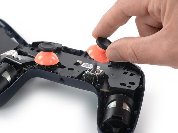

    1. Google Stadia Controller Thumbstick Replacement, Remove the right thumbstick: step 14, image 1 of 2 Google Stadia Controller Thumbstick Replacement, Remove the right thumbstick: step 14, image 2 of 2
      • Use your fingers to remove the right thumbstick by pulling it upwards and off the right joystick.
      Ask FixBot
    2. Google Stadia Controller Thumbstick Replacement, Remove the left thumbstick: step 15, image 1 of 2 Google Stadia Controller Thumbstick Replacement, Remove the left thumbstick: step 15, image 2 of 2
      • Use your fingers to remove the left thumbstick by pulling it upwards and off the left joystick.
      Ask FixBot
