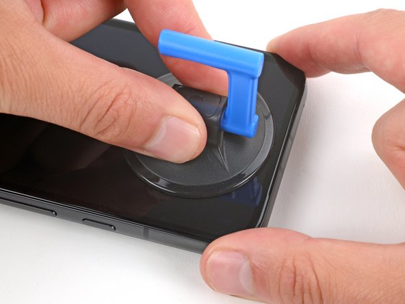

    3. Google Pixel 8a Screen Replacement, Insert your tool under the screen: step 4, image 1 of 2 Google Pixel 8a Screen Replacement, Insert your tool under the screen: step 4, image 2 of 2
      • Apply a suction handle to the center of the top edge of the screen.

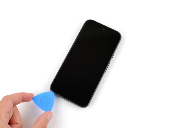

    6. Google Pixel 8a Screen Replacement, Separate the screen adhesive: step 7, image 1 of 3 Google Pixel 8a Screen Replacement, Separate the screen adhesive: step 7, image 2 of 3 Google Pixel 8a Screen Replacement, Separate the screen adhesive: step 7, image 3 of 3
      • Don't insert your pick deeper than 2 mm, as you might damage the front-facing camera.
      • Slide your pick back and forth across the top edge of the screen to separate the adhesive.
      Ask FixBot

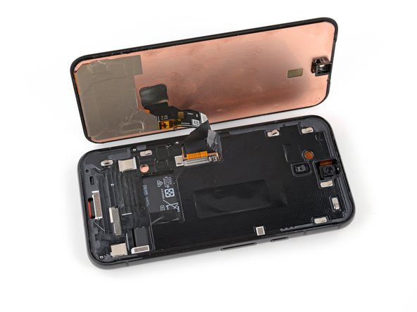

    8. Google Pixel 8a Screen Replacement: step 9, image 1 of 3 Google Pixel 8a Screen Replacement: step 9, image 2 of 3 Google Pixel 8a Screen Replacement: step 9, image 3 of 3
      • Swing the right edge of the screen open (like turning the page of a book) and lay it over the left edge of the frame.
      • Be careful not to strain the screen cable.
      Ask FixBot
    9. Google Pixel 8a Screen Replacement, Disconnect the screen: step 10, image 1 of 2 Google Pixel 8a Screen Replacement, Disconnect the screen: step 10, image 2 of 2
      • Move the flap of graphite film away from the screen connector.
      Ask FixBot

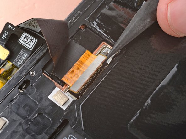

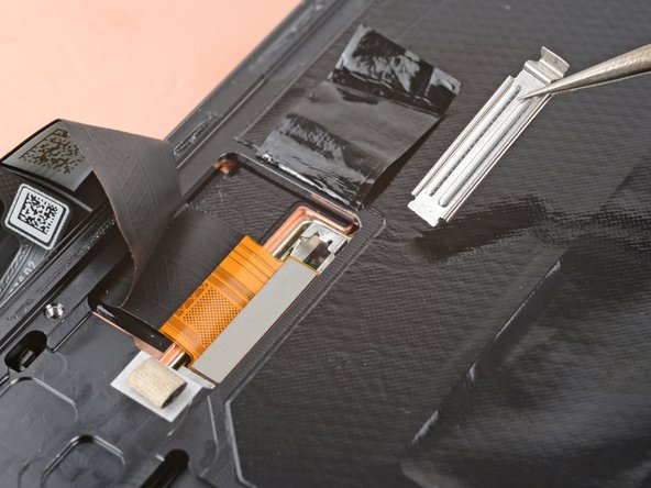

    10. Google Pixel 8a Screen Replacement: step 11, image 1 of 3 Google Pixel 8a Screen Replacement: step 11, image 2 of 3 Google Pixel 8a Screen Replacement: step 11, image 3 of 3
      • Hold one hand above the display bracket when prying it up, as the bracket can easily eject.
      • Use the tip of one arm of your angled tweezers to pry up the top edge of the display cable bracket from the center of the logic board.
      • Be very careful not to damage the board under the bracket's socket. Only insert your tweezers just enough to pry up the bracket.
      • Remove the bracket.

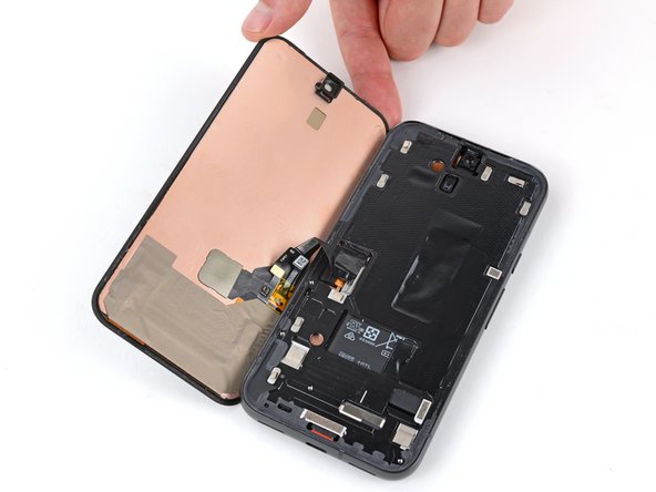

    12. Google Pixel 8a Screen Replacement: step 13, image 1 of 2 Google Pixel 8a Screen Replacement: step 13, image 2 of 2
      • Use tweezers or your fingers to pull the screen cable out from under its lip on the edge of the frame.
      Ask FixBot
    13. Google Pixel 8a Screen Replacement: step 14, image 1 of 1

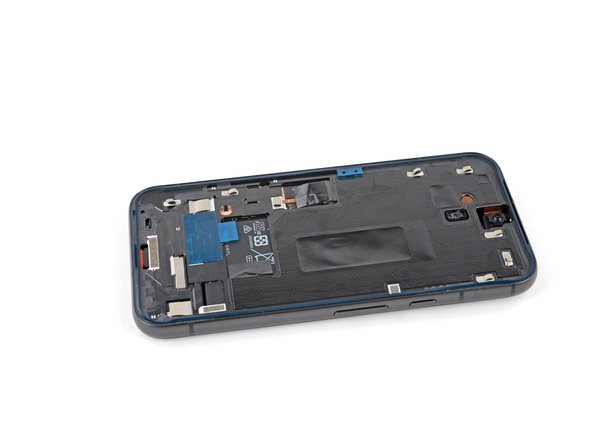

      • Remove the screen.
      • The back of the Pixel's screen is very fragile. Even a small scratch or dent can damage the screen.
      • To prevent damaging your screen or replacement screen:
      • When handling your screen, grip it by its edges.
      • When placing the screen on your work area, make sure nothing is touching the bottom of the screen. Consider placing it on a soft, lint-free cloth.

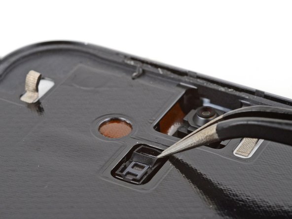

    14. Google Pixel 8a Screen Replacement: step 15, image 1 of 3 Google Pixel 8a Screen Replacement: step 15, image 2 of 3 Google Pixel 8a Screen Replacement: step 15, image 3 of 3
      • The remaining steps show how to install your replacement screen.
      • Make sure the front sensor gasket (located just below the front camera) is properly aligned and fully over the sensor.
      • If it's not, reposition it over the front sensor with the smaller cutout toward the top.

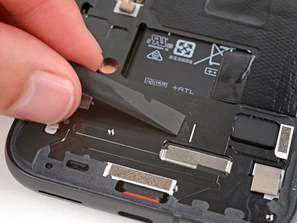

    15. Google Pixel 8a Screen Replacement, Prepare the frame for reassembly: step 16, image 1 of 2 Google Pixel 8a Screen Replacement, Prepare the frame for reassembly: step 16, image 2 of 2
      • The underside of the battery is exposed through a small cutout in the frame—be careful not to damage it with your tool.
      • Use tweezers and a spudger to scrape up and remove any remaining pieces of adhesive below the battery cutout.
      Ask FixBot

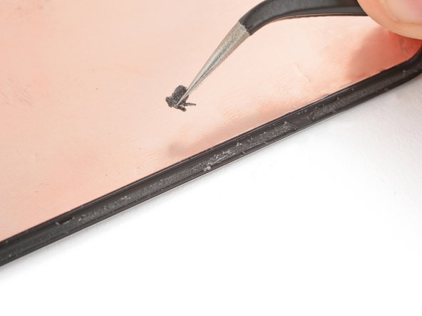

    16. Google Pixel 8a Screen Replacement: step 17, image 1 of 2 Google Pixel 8a Screen Replacement: step 17, image 2 of 2
      • If any screen adhesive bits remain on the perimeter of the frame, use a spudger and tweezers to scrape up and remove them.
      Ask FixBot
    17. Google Pixel 8a Screen Replacement: step 18, image 1 of 2 Google Pixel 8a Screen Replacement: step 18, image 2 of 2
      • If you're reusing your original screen, use a spudger and tweezers to scrape up and remove the old adhesive from the perimeter of the screen.
      Ask FixBot

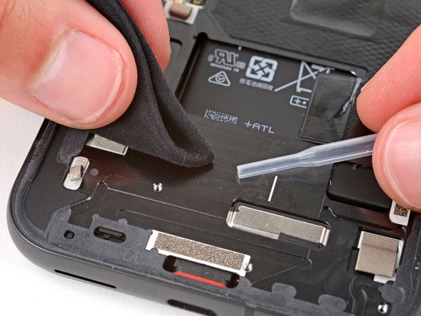

    18. Google Pixel 8a Screen Replacement: step 19, image 1 of 2 Google Pixel 8a Screen Replacement: step 19, image 2 of 2
      Tool used on this step:
      Microfiber Cleaning Cloths
      $3.99
      Buy
      • Use a pipette or syringe to apply a few drops of highly-concentrated isopropyl alcohol (over 90%) to the perimeter of the frame and the area below the battery cutout.
      • Wipe the residue away using a lint-free or microfiber cloth.

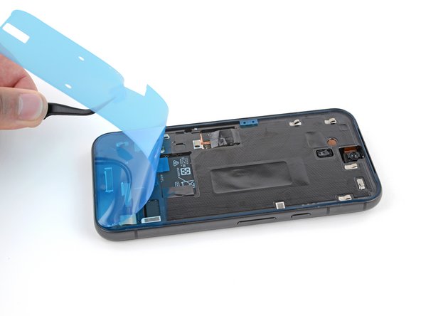

    19. Google Pixel 8a Screen Replacement, Apply new adhesives: step 20, image 1 of 2 Google Pixel 8a Screen Replacement, Apply new adhesives: step 20, image 2 of 2
      • Peel the rectangular display enclosure adhesive from its large liner.
      • Apply the adhesive to the frame in the same location as the old adhesive, just below the battery cutout.
      • Use the white line on the frame to help align the right edge.
      • Use your fingers to press down and secure the adhesive to the frame—don't remove the top liner yet.
      Ask FixBot
    20. Google Pixel 8a Screen Replacement: step 21, image 1 of 2 Google Pixel 8a Screen Replacement: step 21, image 2 of 2
      • If your screen already comes with adhesive pre-installed, remove its liner and skip down six steps to continue reassembly.
      • Before removing any liners from the screen adhesive, hold it over the frame to make sure it's oriented correctly. Use the camera cutout on the top edge to line it up correctly.
      • The blue liner should be facing up, with the larger, clear liner on the bottom.
      Ask FixBot

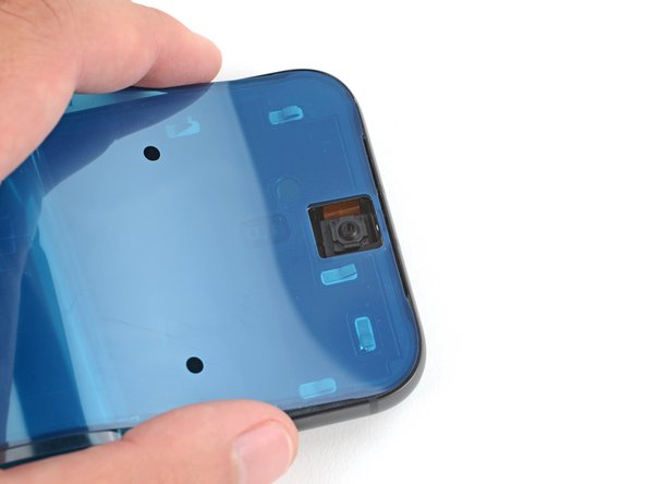

    21. Google Pixel 8a Screen Replacement: step 22, image 1 of 1
      • Peel down the top half of the larger liner (closest to the camera cutout) to expose the adhesive—don't remove the whole liner yet.
      Ask FixBot

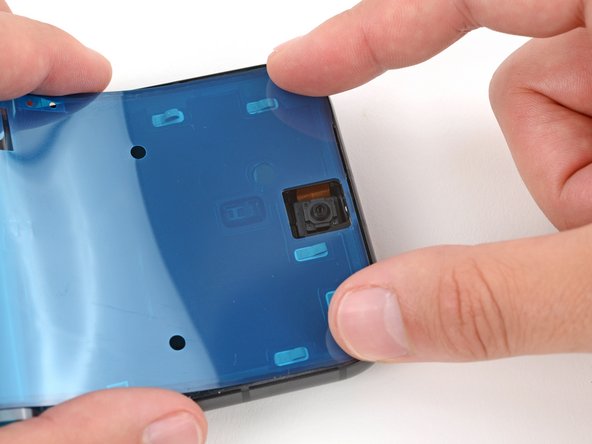

    22. Google Pixel 8a Screen Replacement: step 23, image 1 of 3 Google Pixel 8a Screen Replacement: step 23, image 2 of 3 Google Pixel 8a Screen Replacement: step 23, image 3 of 3
      • Take your time aligning the adhesive with the frame—it's very sticky and can't be moved after you apply it.
      • Keep the larger liner folded towards the bottom of the phone during this step.
      • Lay the exposed top edge of the adhesive onto the frame, using the lip to help align it.
      • Once the top edge is properly aligned, gently press down to secure it in place.
      Ask FixBot

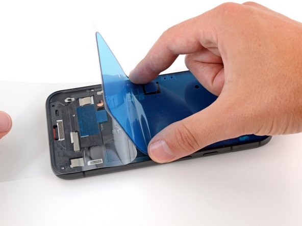

    23. Google Pixel 8a Screen Replacement: step 24, image 1 of 3 Google Pixel 8a Screen Replacement: step 24, image 2 of 3 Google Pixel 8a Screen Replacement: step 24, image 3 of 3
      • Slowly lay the rest of the adhesive onto the frame, peeling away the large liner as you go.
      Ask FixBot

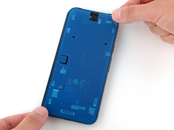

    25. Google Pixel 8a Screen Replacement: step 26, image 1 of 3 Google Pixel 8a Screen Replacement: step 26, image 2 of 3 Google Pixel 8a Screen Replacement: step 26, image 3 of 3
      • Grab the pull tab in the center of the left edge and slowly peel and remove the liner.
      • If the adhesive starts to peel up with the liner, check that you’ve pushed all of it into place with your spudger. If it continues to peel up, hold it down with the point of your spudger as you go.
      Ask FixBot

      • Hold the screen just above the frame by the suction handle.
      • Use a spudger to fold the flap of graphite film back over the screen cable.

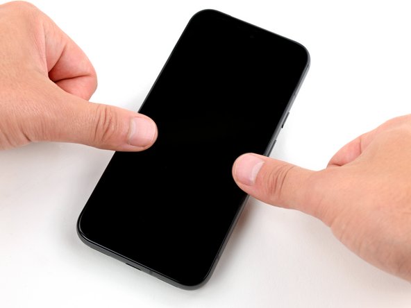

      • Remove the suction handle.
      • For a better seal, lightly warm the screen with a heated iOpener, hair dryer, heat gun, or hot plate before pressing around the perimeter.
      • Firmly press around the perimeter of the screen to secure it to the frame.
