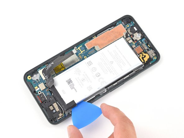

    1. Google Pixel 5a Battery Replacement, Loosen the battery: step 28, image 1 of 3 Google Pixel 5a Battery Replacement, Loosen the battery: step 28, image 2 of 3 Google Pixel 5a Battery Replacement, Loosen the battery: step 28, image 3 of 3
      • If you are using adhesive remover, follow these preparation steps first.
      • Apply 2-3 drops of high concentration (90% or higher) isopropyl alcohol under each corner of the battery and allow it to penetrate for 2-3 minutes to help weaken the adhesive.
      Ask FixBot
    2. Google Pixel 5a Battery Replacement, Slice the adhesive: step 29, image 1 of 3 Google Pixel 5a Battery Replacement, Slice the adhesive: step 29, image 2 of 3 Google Pixel 5a Battery Replacement, Slice the adhesive: step 29, image 3 of 3
      • Insert a pick into the gap to the right of the battery and slide its tip underneath the battery.
      • Take care not to puncture or bend the battery with your tool—a punctured or bent battery may leak dangerous chemicals or cause a fire.
      • Slide the pick along the right side of the battery to slice through the adhesive securing it to the midframe.
      • Once the right side of the battery begins to separate from the midframe, leave an opening pick in the gap to keep the battery slightly raised.
      • Apply a few drops of isopropyl alcohol directly to the adhesive securing the battery to the midframe. Let the isopropyl penetrate the adhesive for 2-3 minutes.
      Ask FixBot
    3. Google Pixel 5a Battery Replacement, Remove the battery: step 30, image 1 of 3 Google Pixel 5a Battery Replacement, Remove the battery: step 30, image 2 of 3 Google Pixel 5a Battery Replacement, Remove the battery: step 30, image 3 of 3
      Tool used on this step:
      Tesa 61395 Tape
      $8.95
      Buy
      • Repeat the last step with an opening card to slice through the remaining adhesive under the right side of the battery.
      • Remove the battery.
      • Do not reuse the battery after it has been removed. The stress of removal can cause hidden damage to the battery cell, creating a potential safety hazard. Replace it with a new battery.
      • To install a new battery:
      • Remove any remaining adhesive from the phone, and clean the entire area under the battery with isopropyl alcohol. If there's any alcohol solution remaining in the phone, carefully wipe it off with a lint-free cloth or allow it to air dry before installing your new battery.
      • Apply a few new strips of pre-cut adhesive or Tesa tape.
      • If you are attaching the battery with a custom-cut adhesive, follow this guide.
      • Press the new battery firmly into place for 5-10 seconds.
