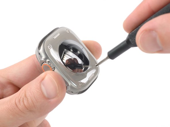

    1. Apple Watch Ultra 2 Sensor Assembly Replacement, Unfasten the sensor assembly screws: step 3, image 1 of 2 Apple Watch Ultra 2 Sensor Assembly Replacement, Unfasten the sensor assembly screws: step 3, image 2 of 2
      • Use a P5 Pentalobe driver to remove the four 2.2 mm‑long screws securing the sensor assembly.

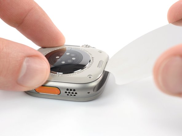

    3. Apple Watch Ultra 2 Sensor Assembly Replacement, Create a gap: step 5, image 1 of 3 Apple Watch Ultra 2 Sensor Assembly Replacement, Create a gap: step 5, image 2 of 3 Apple Watch Ultra 2 Sensor Assembly Replacement, Create a gap: step 5, image 3 of 3
      • Insert an iFlex in the seam between the watch frame and the top edge of the sensor assembly to create a gap.
      • Carefully twist the iFlex to widen the gap.
      • Don't apply too much force, or you'll cause the sensor assembly to pop off and tear the sensor assembly cables.

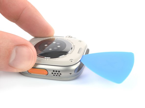

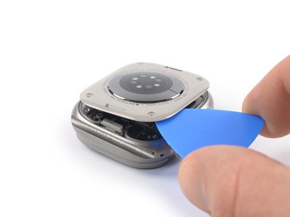

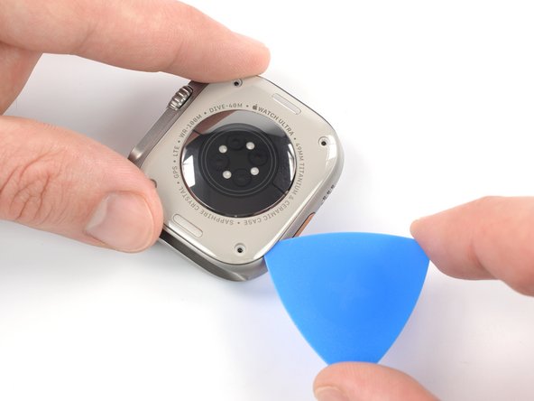

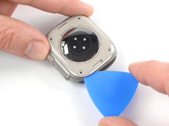

    4. Apple Watch Ultra 2 Sensor Assembly Replacement, Insert an opening pick: step 6, image 1 of 3 Apple Watch Ultra 2 Sensor Assembly Replacement, Insert an opening pick: step 6, image 2 of 3 Apple Watch Ultra 2 Sensor Assembly Replacement, Insert an opening pick: step 6, image 3 of 3
      • Insert an opening pick into the gap you created.
      • Do not insert the opening pick deeper than 3 mm to avoid tearing the sensor assembly cables.
      • Remove the iFlex.
      Ask FixBot

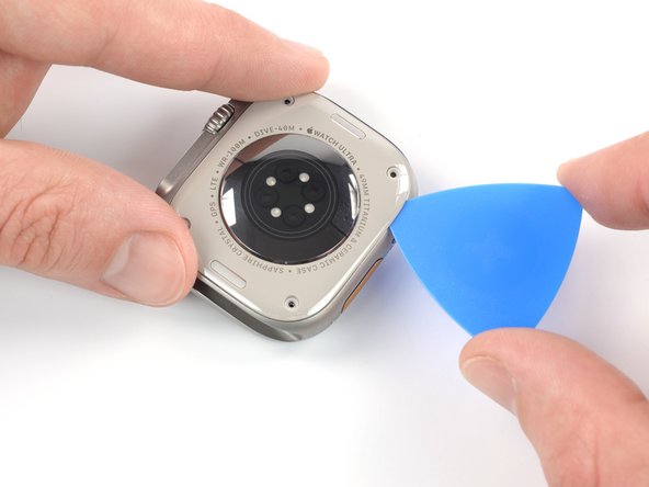

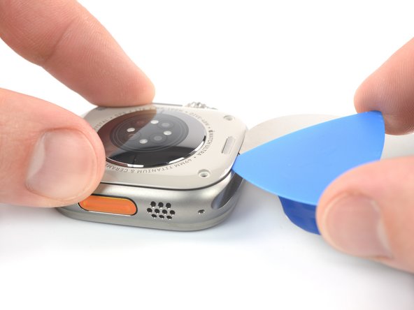

    5. Apple Watch Ultra 2 Sensor Assembly Replacement, Slice the sensor assembly adhesive: step 7, image 1 of 3 Apple Watch Ultra 2 Sensor Assembly Replacement, Slice the sensor assembly adhesive: step 7, image 2 of 3 Apple Watch Ultra 2 Sensor Assembly Replacement, Slice the sensor assembly adhesive: step 7, image 3 of 3
      • Slide the opening pick around the top right corner of the sensor assembly and along the right edge to slice its adhesive.

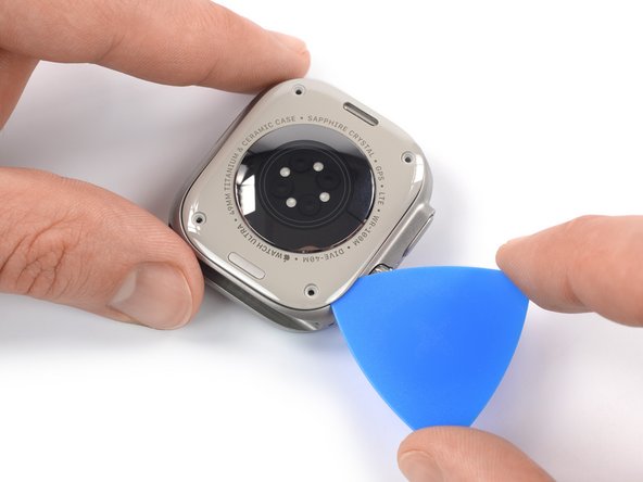

    6. Apple Watch Ultra 2 Sensor Assembly Replacement: step 8, image 1 of 2 Apple Watch Ultra 2 Sensor Assembly Replacement: step 8, image 2 of 2
      • Slide the opening pick around the bottom right corner and along the bottom edge to slice the rear assembly adhesive.

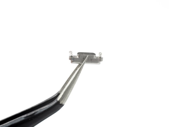

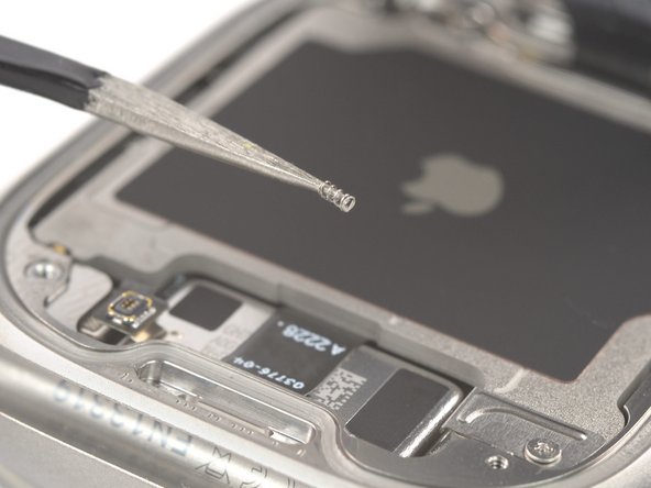

    8. Apple Watch Ultra 2 Sensor Assembly Replacement, Band release button information: step 10, image 1 of 3 Apple Watch Ultra 2 Sensor Assembly Replacement, Band release button information: step 10, image 2 of 3 Apple Watch Ultra 2 Sensor Assembly Replacement, Band release button information: step 10, image 3 of 3
      Tool used on this step:
      Buy
      • In the following steps, the band release buttons and springs may fall out. Be careful during the disassembly, as they are very easy to lose.
      • The band release buttons are equipped with a tiny spring on each end. The springs are mandatory for the buttons to function properly.
      • During reassembly, make sure each band release button has its two springs, and the buttons are repositioned in their recesses.
      • If a band release button falls out and the springs aren't on the button, they may have gotten stuck in the watch during disassembly. Use a pair of tweezers to remove them from the watch and place them upright into their recess on the button for reassembly.

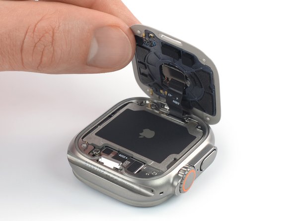

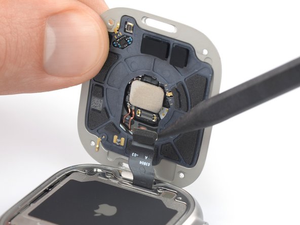

    9. Apple Watch Ultra 2 Sensor Assembly Replacement, Lift the sensor assembly: step 11, image 1 of 2 Apple Watch Ultra 2 Sensor Assembly Replacement, Lift the sensor assembly: step 11, image 2 of 2
      • The sensor assembly is connected to the watch body with two cables. One of the cables is extremely short and its connector will automatically disconnect when lifting the sensor assembly.
      • To reconnect the short press connector during reassembly, line up the sensor assembly to the frame and squeeze gently.
      • Carefully lift the top edge of the sensor assembly with your opening pick until you can get a good grip with your fingers.
      • Don't try to remove the sensor assembly all the way yet. It's still connected to the watch body.
      Ask FixBot

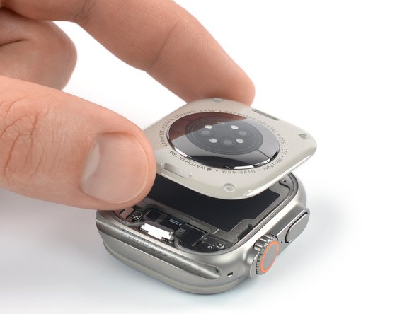

    10. Apple Watch Ultra 2 Sensor Assembly Replacement, Swing open the sensor assembly: step 12, image 1 of 3 Apple Watch Ultra 2 Sensor Assembly Replacement, Swing open the sensor assembly: step 12, image 2 of 3 Apple Watch Ultra 2 Sensor Assembly Replacement, Swing open the sensor assembly: step 12, image 3 of 3
      • Be careful not to strain the sensor assembly cable when you lift the assembly up.
      • Lift the sensor assembly and carefully pull it towards the bottom edge of the watch.
      • Swing the sensor assembly open to an upward position.
      Ask FixBot
    11. Apple Watch Ultra 2 Sensor Assembly Replacement, Disconnect the sensor assembly cable: step 13, image 1 of 2 Apple Watch Ultra 2 Sensor Assembly Replacement, Disconnect the sensor assembly cable: step 13, image 2 of 2
      • The band release button near the sensor assembly cable is equipped with a tiny spring on each end. Be careful not to lose the button or its springs.
      • Use a spudger to pry and disconnect the sensor assembly cable from its socket.
      Ask FixBot
