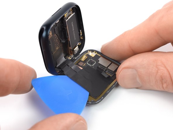

    9. Apple Watch - Series 8 Screen Replacement, Swing open the display: step 9, image 1 of 3 Apple Watch - Series 8 Screen Replacement, Swing open the display: step 9, image 2 of 3 Apple Watch - Series 8 Screen Replacement, Swing open the display: step 9, image 3 of 3
      • Be careful not to strain the display cables when you open the display.
      • Lift the display and carefully pull it towards the watch crown.
      • Swing the display open to an upright position.

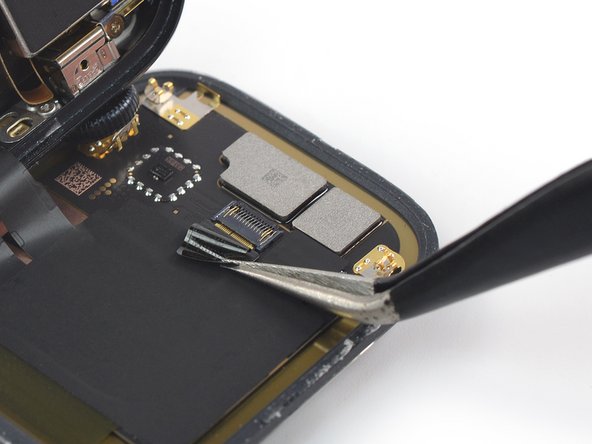

    1. Apple Watch - Series 8 Screen Replacement, Expose the ZIF connectors: step 17, image 1 of 3 Apple Watch - Series 8 Screen Replacement, Expose the ZIF connectors: step 17, image 2 of 3 Apple Watch - Series 8 Screen Replacement, Expose the ZIF connectors: step 17, image 3 of 3
      Tool used on this step:
      Buy
      • Use a pair of tweezers to peel the black protective tape off both display connectors.

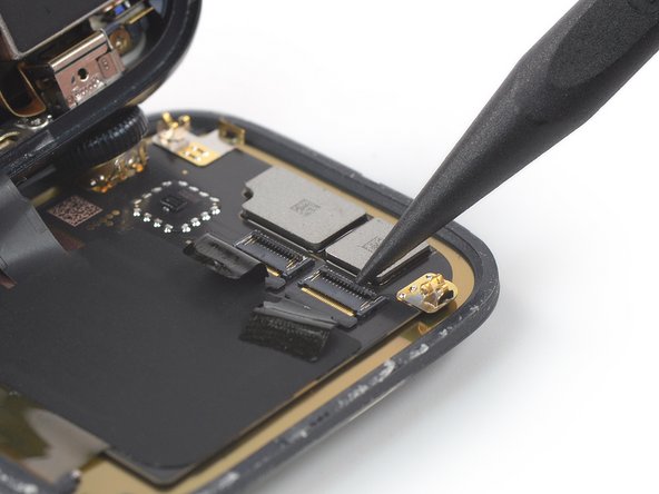

    2. Apple Watch - Series 8 Screen Replacement, Unlatch the ZIF connectors: step 18, image 1 of 3 Apple Watch - Series 8 Screen Replacement, Unlatch the ZIF connectors: step 18, image 2 of 3 Apple Watch - Series 8 Screen Replacement, Unlatch the ZIF connectors: step 18, image 3 of 3
      • Use the tip of a spudger to flip up the small, hinged locking flap on the display ZIF connectors.

    3. Apple Watch - Series 8 Screen Replacement, Loosen the heat dissipation tape: step 19, image 1 of 1
      • Prepare an iOpener and apply it to the screen for two minutes to loosen the heat dissipation tape underneath.
      • A hair dryer, heat gun, or hot plate may also be used, but be careful not to overheat the watch—the display and internal battery are both susceptible to heat damage.
      Ask FixBot

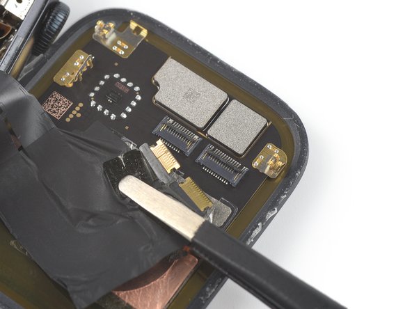

    4. Apple Watch - Series 8 Screen Replacement, Separate the display cables: step 20, image 1 of 3 Apple Watch - Series 8 Screen Replacement, Separate the display cables: step 20, image 2 of 3 Apple Watch - Series 8 Screen Replacement, Separate the display cables: step 20, image 3 of 3
      • Slide an opening pick underneath the display cables to separate them from the screen.
      Ask FixBot
    5. Apple Watch - Series 8 Screen Replacement, Disconnect the display cables: step 21, image 1 of 2 Apple Watch - Series 8 Screen Replacement, Disconnect the display cables: step 21, image 2 of 2
      • Use a pair of blunt nose tweezers to pull both display cables out of the ZIF connectors.
      • Avoid pulling on the watch assembly, or you may rip the display cables.
      • During reassembly, you can reuse your old heat dissipation tape if it's in good condition. Otherwise, replace it with new tape.
