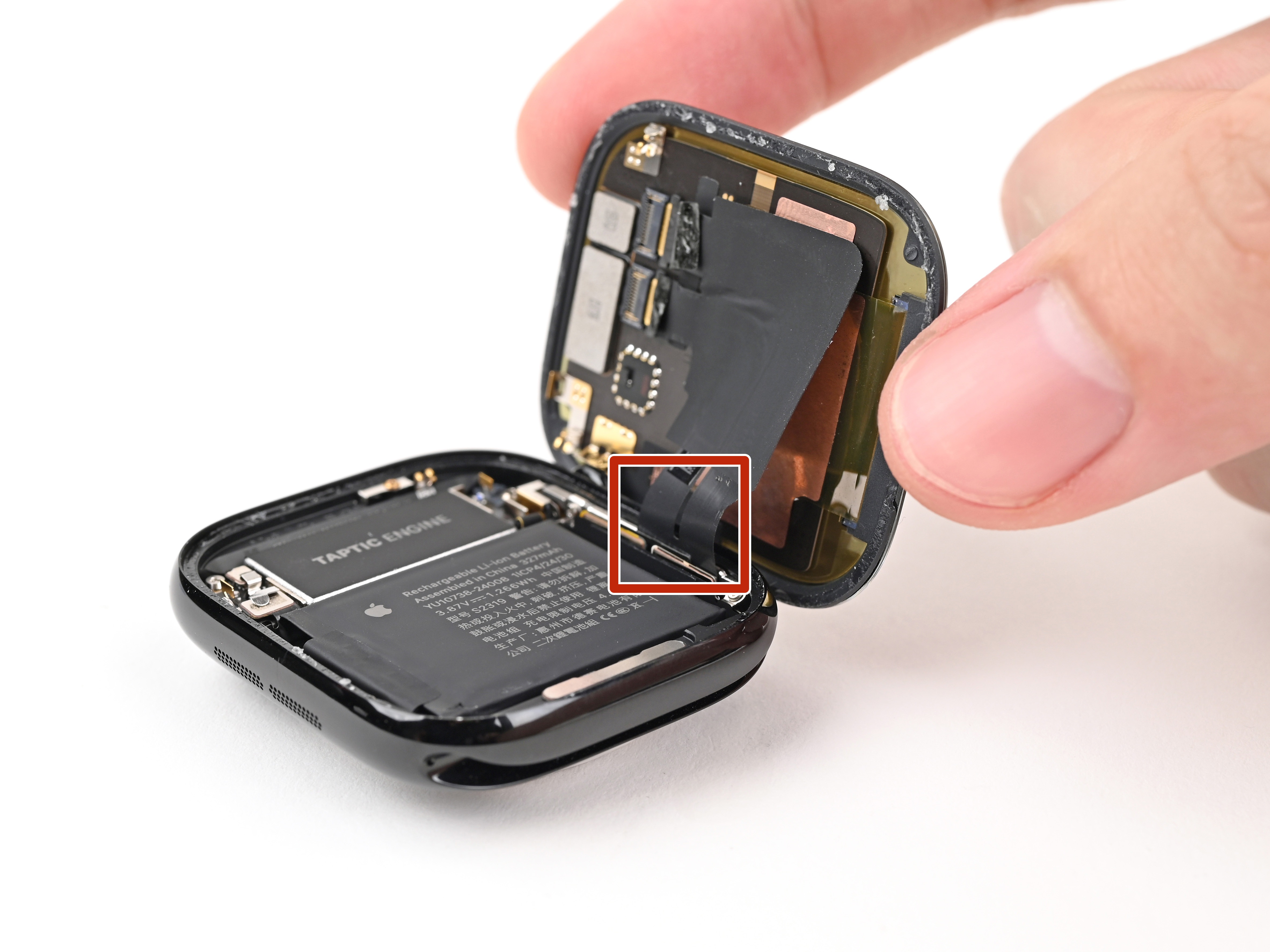

  11. Apple Watch - Series 10 (46mm) Battery Replacement, Swing open the screen: step 11, image 1 of 3 Apple Watch - Series 10 (46mm) Battery Replacement, Swing open the screen: step 11, image 2 of 3 Apple Watch - Series 10 (46mm) Battery Replacement, Swing open the screen: step 11, image 3 of 3
    • Pull the right edge of the screen over the digital crown.
    • If the screen feels stuck, go back around it with an opening pick to separate any adhesive.
    • Swing up the left edge of the screen so it's upright. The screen should be to the right of the digital crown.
    • During reassembly:
    • This is a good point to plug in your watch and test all functions before sealing it up. Be sure to power it back down completely before you continue working.
    • Follow this guide to apply new screen adhesive and reseal your watch.
  12. Apple Watch - Series 10 (46mm) Battery Replacement, Remove the battery connector screw: step 12, image 1 of 2 Apple Watch - Series 10 (46mm) Battery Replacement, Remove the battery connector screw: step 12, image 2 of 2
    • Use a tri‑point Y000 screwdriver to remove the 1.1 mm‑long screw securing the battery connector bracket.
  13. Apple Watch - Series 10 (46mm) Battery Replacement, Remove the bracket: step 13, image 1 of 2 Apple Watch - Series 10 (46mm) Battery Replacement, Remove the bracket: step 13, image 2 of 2
    • Use tweezers to remove the battery connector bracket.
    • During reassembly, make sure the longer section of the bracket goes over the battery press connector.
  14. Apple Watch - Series 10 (46mm) Battery Replacement, Disconnect the battery: step 14, image 1 of 2 Apple Watch - Series 10 (46mm) Battery Replacement, Disconnect the battery: step 14, image 2 of 2
    • Use the point of a spudger to pry up and disconnect the battery press connector.
