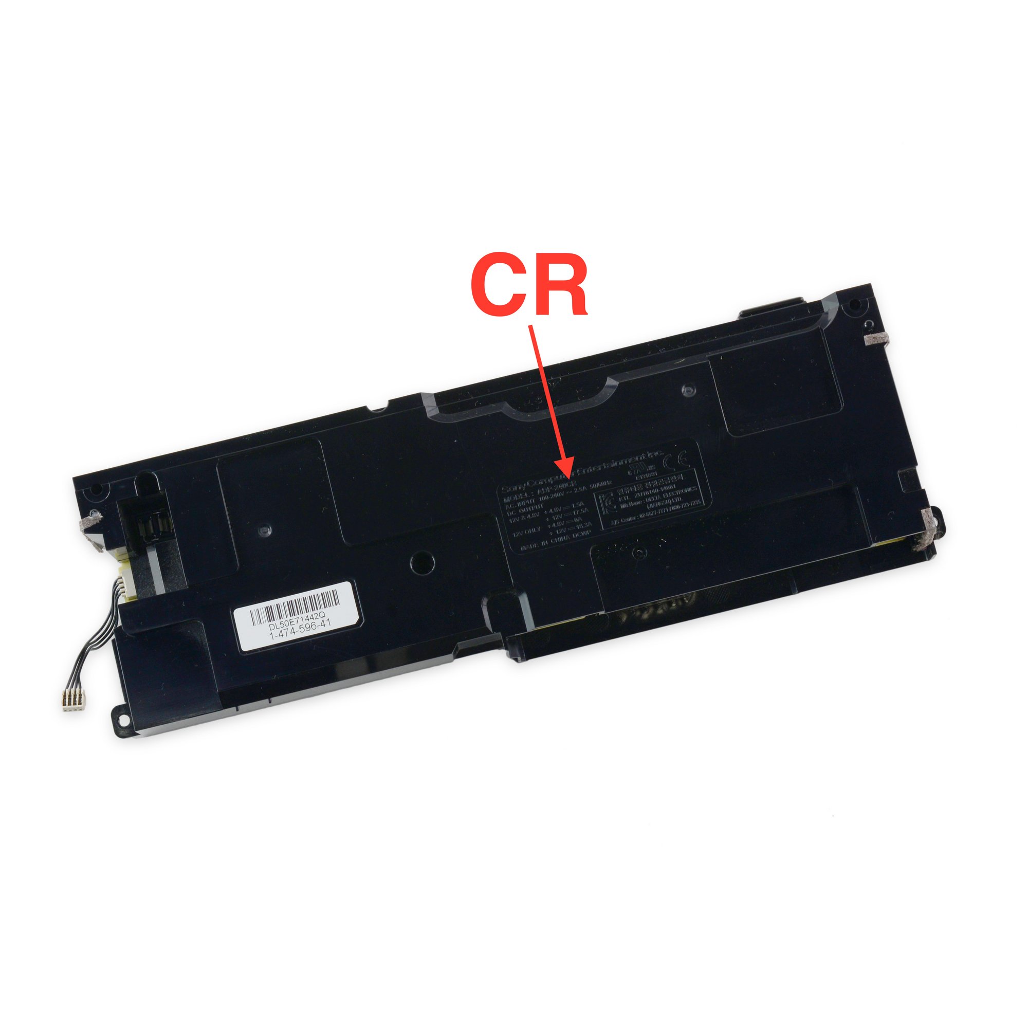

Since you can only power the console for a moment (1 second) it sounds like the power supply has gone bad rather than loose solder joints under the APU (processor chip) as explained below:
Try this fix if a replacement power supply does not work, if it works you’ll know whether or not the APU (main processor chip) on the board has loose solder joints to the board or not.

Refer to this guide on power supply replacement:
PlayStation 4 Power Supply Replacement
Note: To order the right power supply, take the power supply out of your system and note the part model number engraved / printed on the power supply unit itself.
Image of where power supply model number is for example:
https://da2lh5cs8ikqj.cloudfront.net/car...
PlayStation 4 Power Supply Image

I actually got it to power back on after two days of messing with it. Turns out it was the power supply. I pulled it out yet again and actually went into detail of taking it apart and putting it back together and sure enough boom. Powered on and hasn't gave me a problem yet. But I'm still probably going to buy a replacement power supply for it to be safe.
