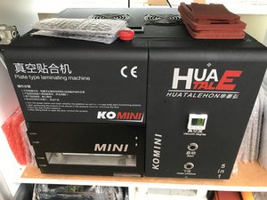

Hi
I have purchased the bubble remover
it's the mini bubble remover.I have tried removing the bubbles from LCD obviously using OCA. However the temperature is set to 60 degree's and time 10 mine still not much of result. I have tried 8 minutes and 40 degrees won't have it.Really need some advise as that's the last thing needed for refurbished LCD ,it take me 60 second to remove glass honesty and cleaning 2 minutes ,just the OCA is taking step back would appreciate advise thank you
Was this answer helpful?
Score 0
3 Comments:
I use 45-60C max for 20-40 minutes. Sometimes if more bubbles, repeatt cycle!
by
@ Edgar 5 thank you for advise seems a very long time for 1 LCD,40 minutes il try 20 as not as many bubbles appear when iv done 10 minutes cycle :-)
by
Today discovered with IP6:
1. OCA to glass with hand silicone-roll,
2. OCA+glass to autoclave for 10 min 45C
3. again rolling
4. OCA+glass to LCD in mold
5. finally LCD+OCA+glass to vacuum press for 4min and vacuum time 1min / no bubbles
6. back to autoclave(for sure) for 20min/ 0.5-0.6Mpa
by

I've done screen refurb first with loca and now using oca with a komag machine
Loca:
Has anyone tried sealing the backlight? I used to use silicone sealant around the edges of the lcd where the backlight meets the glass. You can also use copydex latex adhesive. iPhone 6 is tricky though because there's very little bezel around the backlight to absorb the glue.
When squeezing the glue out to the edges, use central pressure only and watch the glue flow itself right to the edges. To do the corners, apply pressure to the top centre / bottom centre for a few seconds so the glue flows back inward toward the centre, then release. It'll flow perfectly into the corners with minimal seep.
Use xfactor or aps loca only.
Uv light fur 10 secs
Use a paintbrush and a baby wipe to sweep up the excess round the edges while it's still wet, then cure for 5 mins
Oca
Best results with Mitsubishi sheets and polarisers
Cheap ones cause bubbles and low touch sensitivity
Sometimes small bubbles after autoclave disappear on their own overnight
The rest of my knowledge is secret

I tried LOCA first and you can forget that junk! Too messy, too time consuming. I got the OCA sheets and ran into the bubble issues. No matter how careful I was it seems I always have bubbles. Now I have the autoclave and with no success. The machine comes with instructions all in Chinese and I'm wondering if there's a setting that I have set wrong. I'm not sure if I have the temp right or wrong. I was under the impression you need 60 psi at 20 mins. The first 2 or so seemed to work but the longer they sat after being in the autoclave small tiny bubbles seam to appear out of no where. I'm thinking the temp may be wrong. It was preset at 100. I'm thinking maybe it's not getting hot enough to remove the bubbles. I think someone posted around 140 is the right temp. So I guess I'll try that. Any help would be greatly appreciated.
Score 0
4 Comments:
I do this way:
1. OCA to glass with hand silicone-roll, 2. OCA+glass to autoclave for 10 min 45C(full pressure) 3. again rolling 4. OCA+glass to LCD in mold 5. finally LCD+OCA+glass to vacuum press for 4min and vacuum time 1min / no bubbles 6. back to autoclave(for sure) for 15-20min/ 0.5-0.6Mpa
NB!
Pay attention to nr.1 item!
Dont press too much upper and bottom edges of oca sheet! Mbye dont press at all (ca 0,5cm).
As you see there is a very tiny edging border around the transparent area of the glass. If you seal the OCA aginst this edging - bubbles can not go out over this. This will fixed in autoclave!
by
Just so you know. Yes it will be easy to remove bubbles with the LCD to glass laminator. BUT! If you do small scale 5 to 15 screens a day you do not need the laminator at all it is just an expensive machine. Use a mold at all times.. Work your way up the screen and you can squeeze something on top of the screen to make sure you do not have the top sticking first. If it does stick before you get to it, you will not be able to remove the bubbles in the autoclave. And autoclave should be 120 psi at 60 degree Celsius. This works good for iPhone 5 series and 6.
by
Ok. So we got a more powerful air compressor. Now when we use 120 psi on 60 degrees for 15 mins it works. Some of the tougher ones we cut the temp up and it gets those out better.
by
Could one of you that have a good machine and is real good at this please share a youtube video with me on the whole process? We're thinking of purchasing an autoclave (around 5,000$ or so). I read some people use molds, some don't. I wanted to see a full video of someone with a decent machine doing the whole process, using the OCA, not the LOCA.
Thanks.
by
Add a comment

Sealing the backlight with silicone is effective for iPhone 4, semi effective for 5 series and useless for the 6.
Loca is too messy to really be practical these days, except for Samsung panels where it's more preferable as the panel is more fragile (they can break if you laminate oca sheets on them)
Therefore I use a 5 in 1 laminate and autoclave machine (it's called a ko mag) for iPhone and other LCD based phones and loca for the Samsung stuff.
The 5 in 1 machines have an air compressor and vacuum pump built in and require little maintenance.
Oca is best applied to glass first, then to the LCD. You can buy now the glass with oca attached, which minimise dust problems.
Autoclave temperature should be 40 degrees and for 16 minutes
Score 0
3 Comments:
there are no bubble after i put it in the KO MAG...but after some time...small spots appear in the borders...usually 1 or 2 borders
by
pls help me...i am unable to continue my business
by
Hi. I have the same problem. Have you solved that?
by
Add a comment
Sounds like too high a temperature and / or incorrect position of the oca sheet
Temperature should be 40 ish degrees, but because air is compressed in there you might find it as high as 60-70, so reduce the thermostat to 30-35 and check again.
The oca sheet I've found is better being applied to the glass so you can check there's enough overlap on the borders before bonding.
1/2mm all the way round is best
Score 0
1 Comment:
these bubble which appear....strangely appear after 0.5-1 hrs of the de bubbling process some disappear after 7-8 hrs....reducing the temperature would solve the issue???
by

Hello
I have to buy the machine Komax 12 inch
I did all the steps before tournament of use
I separated the lcd then I change the polarized then I glue the OCA on the glass
I assemble all
I press for 3 minutes at 95 degrees%
Then I put on my screen in the autoclave for 45 minutes at 82 psi
once I finished out the screen is nickel but a few minutes later there are plenty of micro bubbles especially at the edges
Or can come to my problem?
Maybe the oca movie that I have to buy on aliexpress?
can you told me a place where I can buy very good quality of oca?
What the best brand oca?
Or if you know the problem and think you know the resolve
ECLSG'd be nice to m helped because I am in distress
I appealed to specialists
Thank you thank you thank you very much

Hi Xterminal,
Are you familiar with the 2015 AK 2 in 1 laminating machine? I have run a couple sample screens and so far so good except for a few bubbles. The instructions I got don't say anything about settings ect. All they say is hit the start button and it should work ha ha
Any help here with the settings would be appreciated
Score 0
7 Comments:
What do you have on your settings?
by
Vacuum time : 15s
Lamination time: 14s
Debubbling time:720
Temp: 40c
Have also noticed that when the pressure first builds up it stops at 90 psi, after 6 mins it has already dropped to 60.
I'm assuming it's suppose to stay constant?
by
First of all try these settings:
Vaccum Time: 17s
Lamination Time: 30s
Debubbling Time: 845
Temp: 47c
When you have these settings right, everytime your going to used it you must warm up the machine so close the lid and run it to warm it up and then try putting 1-3 screens and give it a try.
For The Psi is normal it runs automatic so don't adjust that
by
I understand the psi is automatic but should it not stay at 90 for the whole ten mins? Sometimes it stays at 90 for the whole time. Other times it's down to 50psi after 5 mins

I have questions about the Al 2 in 1 plate type laminating machine. It continues to leave bubbles? Have tried different settings and nothing seems to remvoe them
by
@jlprs try 60 seconds laminating time and 13 minutes debubbling.
If this doesnt work you must not be installing the OCA sheet right or your pressing on the glass to stick the OCA to lcd alot all you have to do is press the middle one time and throw it on the machine.
by
I find the plastic on one side of the oca comes off very easy, the other side is hard to pull off.which side do you put on the glass? Or does it matter?
by
@mayer I will make up for the lost time! hahah :)

I had issues with bubbles for such a long time, after tinkering with the settings for what seemed like an eternity I finally found the right settings which left no bubbles. So I have a 5in1 TBK408 and my settings are as follows;
Pressure 0.5
Vacuum Time 30 seconds
Laminating Time 30 seconds
Temperature 60 degrees Celsius
bubble remover 10 minutes
I hope this helped :)
Score 0
2 Comments:
I'm glad you found the right settings. Wow I was using a laminating pressure of 7 but keep getting bubbles on my iPhone x/xs/xs max screens! 0.5 seems very low but ill try it.
by
