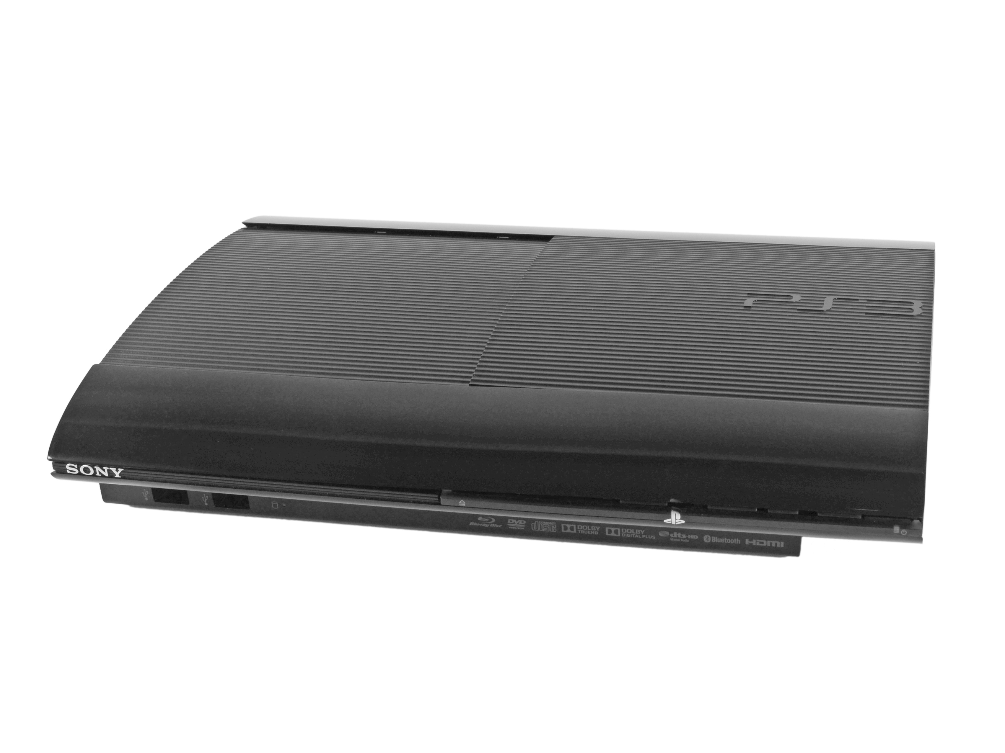

  2. PlayStation 3 Super Slim Teardown: step 2, image 1 of 3 PlayStation 3 Super Slim Teardown: step 2, image 2 of 3 PlayStation 3 Super Slim Teardown: step 2, image 3 of 3
    • Not that we're complaining, but we had to get our PlayStation 3 Super Slim in a bundle. It seems that after countless adventures, Nathan Drake finally found a treasure worthy of praise.
    • What exactly is included in this bundle? Glad you asked:
    • 250 GB PlayStation 3 Super Slim System
    • DualShock 3 Wireless Controller
    • AV Composite Cable (sadly no HDMI cable is included in this bundle)
    • AC Power Cord
    • USB Cable (required for charging the DualShock controller)
    • Uncharted 3: Drake's Deception (Game of the Year Edition) + Dust 514 (Downloadable content included)

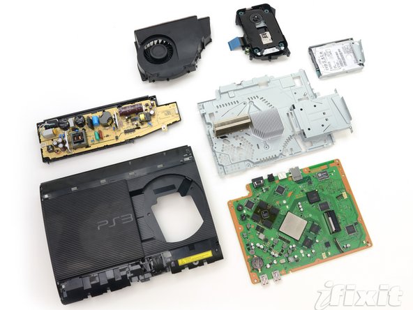

  17. PlayStation 3 Super Slim Teardown: step 17, image 1 of 2 PlayStation 3 Super Slim Teardown: step 17, image 2 of 2
    • The Super Slim loses its cool as we remove the squirrel cage fan and two heatsinks.
    • The Super Slim has definitely dropped some size and weight in the fan since the Slim.
    • For this (final?) iteration of the PS3, Sony has leveraged new technology to make the same console smaller, lighter, and quieter, rather than significantly improving performance.
