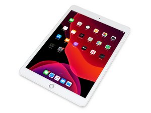

iPad 7
2019
CONS
  • As with all iPads, a solid barrier of very strong adhesive hinders all repairs.
  • The Lightning port, a common point of failure, is soldered to the logic board.
  • More adhesive holds nearly everything else in place. Battery and logic board replacements are particularly obnoxious.

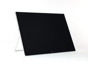

HP Elite x2 G4
2019
PROS
  • All screws are standard Torx or Phillips—only three drivers are needed for complete disassembly.
  • A modular and flat construction allows access to most components early on.
NOTES
  • The display is fused to the front panel, simplifying repair but increasing the cost of an LCD or front glass replacement.

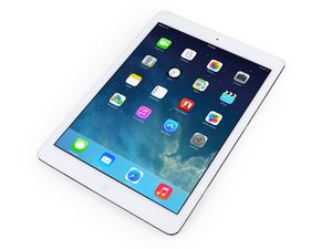

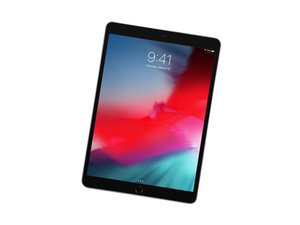

iPad Air 3
2019
CONS
  • Battery replacement is possible, but still unnecessarily difficult.
  • Gobs of adhesive hold many parts and cables in place, complicating all repairs.
NOTES
  • Many components are modular and can be replaced independently, but the Lightning port is soldered to the logic board.

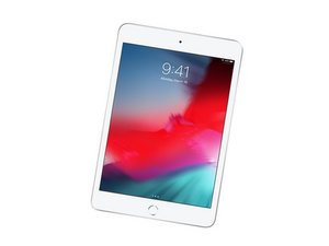

iPad Mini 5
2019
CONS
  • Removing the home button is tough, and will be required for display replacement if you want to keep Touch ID functionality.

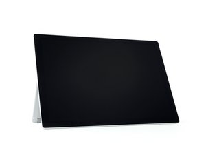

Microsoft Surface Pro 6
2018
CONS
  • All repairs require first removing the display assembly—which is stubbornly glued in place, expensive, and prone to shattering.
  • The battery is firmly glued in place, with its connector pinned under the motherboard—requiring near-total disassembly for service.
  • Once upon a time, Surface Pro storage was removable—but not in this version.

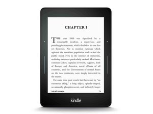

Kindle Paperwhite 3rd Generation
2017
PROS
  • The display is easily removed from the simple clips holding it to the body, simplifying repairs
CONS
  • The battery is extremely difficult to remove, even with heat and prying.
  • The charging port is soldered to the motherboard, making replacement of this high-use component expensive.

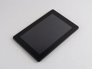

Amazon Fire 5th Generation
2017
PROS
  • The plastic case assembly is held together by clips and no adhesive, and opening only requires prying with an iFixit opening tool.
CONS
  • Removing the digitizer and LCD panel requires fighting through some very resilient adhesive.
NOTES
  • The battery is modular, but it’s held in place by somewhat stubborn adhesive.

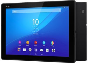

Sony Xperia Z4 Tablet
2017
PROS
  • Many parts are modular and can be replaced independently.
CONS
  • The delicate and arduous opening procedure leaves no room for mistakes, and must be completed to access any other component.
  • The display assembly consists of a thin fused glass panel and LCD, and is extremely difficult to remove and replace.

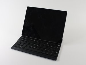

Microsoft Surface Pro 5
2017
CONS
  • Adhesive holds many components in place, including the display and battery.
  • Replacement of any part requires removal of the display assembly, an easy part to damage.
  • The SSD is no longer replaceable.
