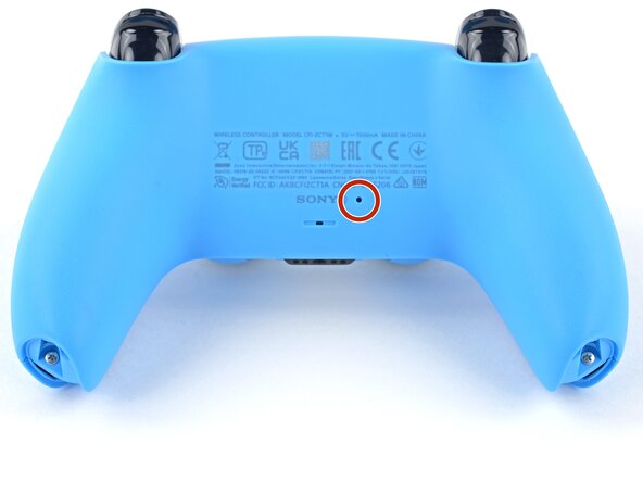

  1. Turn off your PlayStation 5.
  2. Unplug the controller and flip it over.
  3. While it is upside down, locate the recessed reset button in the small hole on the back of the controller, and use your paper clip or similar tool to press and hold it for at least 6 seconds.
  4. Release the reset button and wait a few more seconds. Then, plug in the controller using a 2.0 USB-C cable.
  5. Press the PS button on the front of your controller. When the light bar on the controller turns blue, it should be paired, and you can log on to your PS5.
