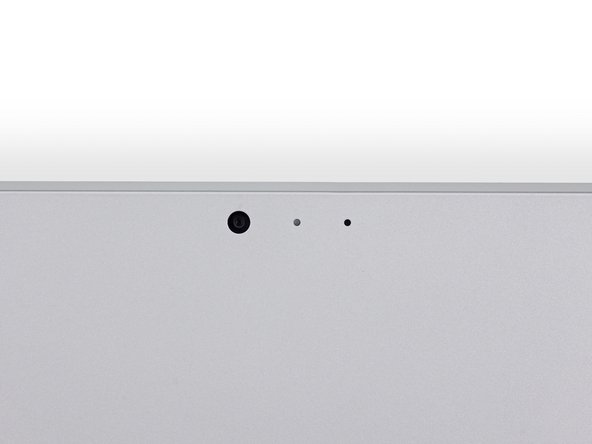

Image 1/3: Arrayed across the back, we find the  rear-facing camera, accompanied by two additional specks—a status LED and a microphone. Image 2/3: And along the edge, another trio, this one for connectivity: a full-size USB 3.0 port, Mini DisplayPort, and the charging port. Image 3/3: Hiding beneath the kickstand is the microSD card slot, good for up to 128 GB of additional storage.

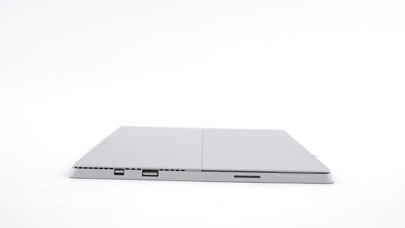

  • True to its name, this threequel brings its hardware in triplicate:
    • Arrayed across the back, we find the rear-facing camera, accompanied by two additional specks—a status LED and a microphone.
    • And along the edge, another trio, this one for connectivity: a full-size USB 3.0 port, Mini DisplayPort, and the charging port.
  • Hiding beneath the kickstand is the microSD card slot, good for up to 128 GB of additional storage.

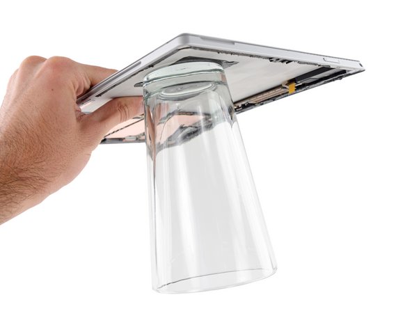

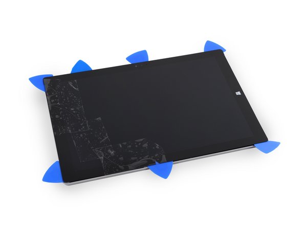

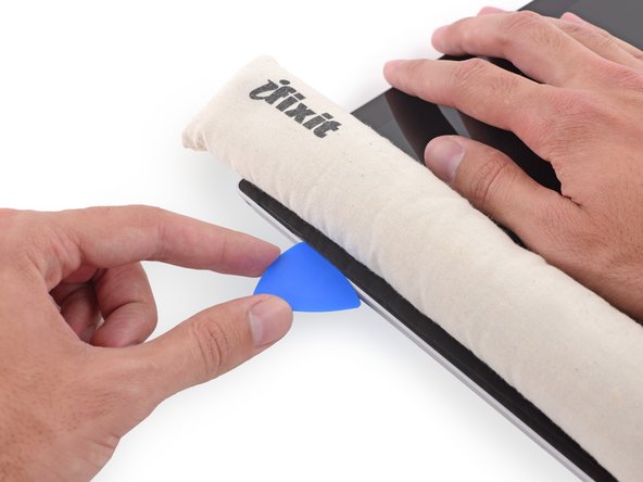

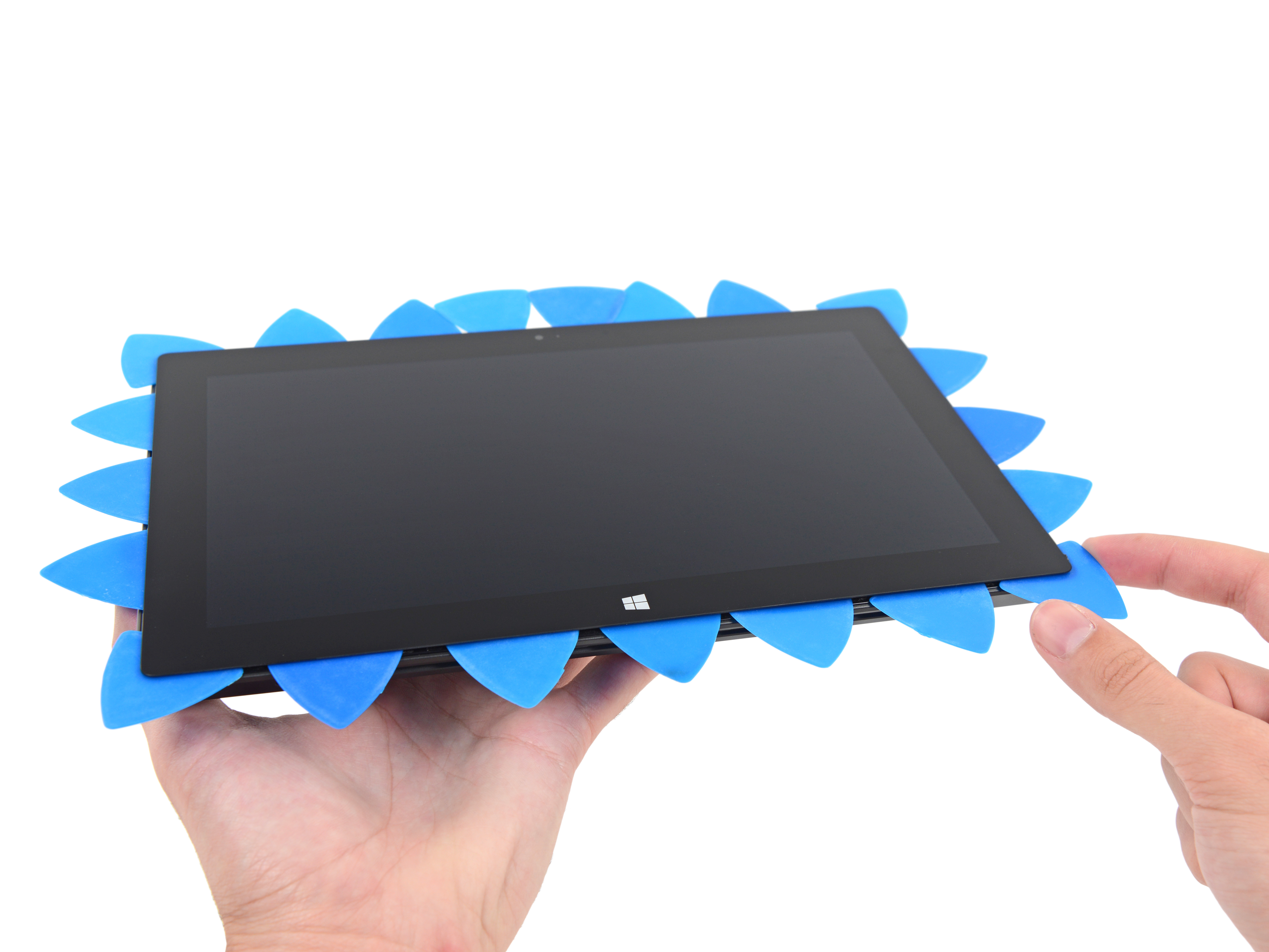

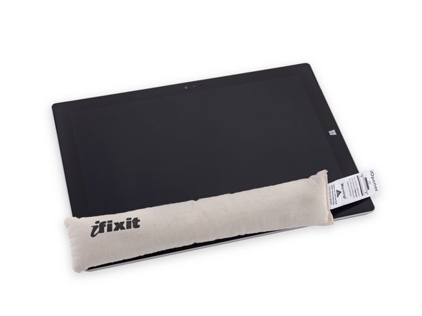

Image 1/3: If the old Surface Pro 2 is anything to go by, we're gonna need picks—[https://d3nevzfk7ii3be.cloudfront.net/igi/Z6GM2yRAedPLgmIV|oodles and oodles of picks]. Image 2/3: These speaker cutouts give us a handy point of access. Image 3/3: Picks, away!
  • A cursory look is all it takes to tell us we're gonna need to bring the heat for a display-first invasion. Out comes the trusty iOpener.
  • These speaker cutouts give us a handy point of access.
  • Picks, away!

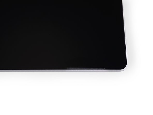

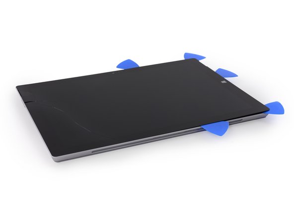

Image 1/2: Unfortunately, the Pro 3's weak point is just that—a point of weakness. Image 2/2: Our teardown engineer carefully heated and pried up the glass at the edge of this device, but the cooling adhesive alone was enough to crack the glass on our photo table.
  • Whoops.
  • Unfortunately, the Pro 3's weak point is just that—a point of weakness.
  • Our teardown engineer carefully heated and pried up the glass at the edge of this device, but the cooling adhesive alone was enough to crack the glass on our photo table.
    • Microsoft went to great lengths to make the Surface Pro 3 super portable, thinning it down from the Pro 2's 0.53" to a mere 0.36" thick—but it seems the thinner glass does not bode well for ruggedness, or repair.
  • We'll just work down here as that crack spreads quicker than an army across Westeros...
parsing very difficult(((
VISION463 - Reply
Did the crack occur as a result of the pick being inserted and the glass cooling too quickly, or was it strictly a result of the thermal expansion of the screen cooling? i.e. if I had someone standing there with a heat gun till I`d gotten the screen loose or some such...
variable - Reply
The crack appeared spontaneously after the prying picture in step 5, so we're assuming it was a result of the adhesive cooling and pulling the screen down against the lodged-in pick. Keeping heat on the device the entire time would probably have prevented it, but it was certainly markedly more difficult to pull off an intact screen than it was with the previous surface pro.
Andrew Optimus Goldberg -

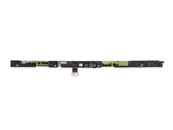

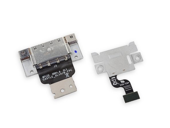

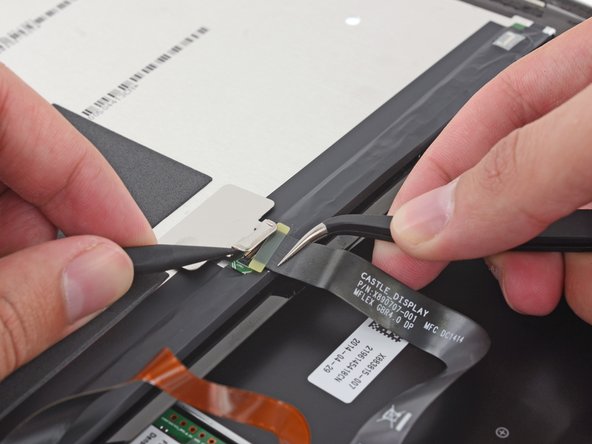

Image 1/3: At the other end of the cable, another dubious connector with a sliver of a contact board in tow. Because, why not? Image 2/3: But really, we theorize that this is a thinner, cheaper connector than something utilizing a physical snap. We first saw this sort of contact on the [guide|11225|13" MacBook Pro Retina|stepid=40188]. Image 3/3: Hugging the back of the display is an N-trig [http://www.n-trig.com/Content.aspx?Page=DuoSenseControllerChipset|DS-P4196|new_window=true] touch controller, providing the necessary tech to go with the pressure-sensitive Surface Pen.
  • While we're storming the castle—er, display, we find something new: a springy metal bracket pinning the display connector in place. It's not the friendliest of chums, but with a little convincing from our spudger, it agrees to let the connector go.
  • At the other end of the cable, another dubious connector with a sliver of a contact board in tow. Because, why not?
    • But really, we theorize that this is a thinner, cheaper connector than something utilizing a physical snap. We first saw this sort of contact on the 13" MacBook Pro Retina.
  • Hugging the back of the display is an N-trig DS-P4196 touch controller, providing the necessary tech to go with the pressure-sensitive Surface Pen.

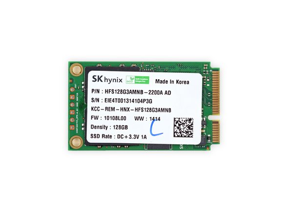

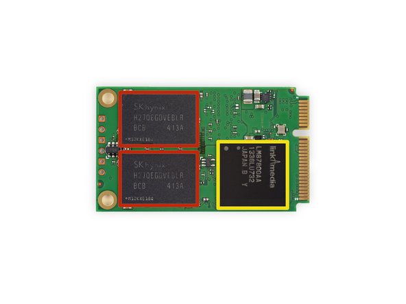

Image 1/2: Next, we Ring Pop this surficial SSD up off the back case for a closer look. Image 2/2: You may be asking yourself, why a Ring Pop? [http://en.wikipedia.org/wiki/Diamond#Electrical_conductivity|As you well know|new_window=true], except for most natural blue diamonds, which are semiconductors due to substitutional boron impurities replacing carbon atoms, diamonds are a great electrical insulator, having a resistivity of 10^11 to 10^18 Ω·m. So really, we're just being careful.
  • Safety first! We disconnect the battery before charging forth. This battery connector requires a relatively uncommon T3 Torx bit. Lucky for us, our 54 Bit Driver Kit is never out of reach.
  • Next, we Ring Pop this surficial SSD up off the back case for a closer look.
  • You may be asking yourself, why a Ring Pop? As you well know, except for most natural blue diamonds, which are semiconductors due to substitutional boron impurities replacing carbon atoms, diamonds are a great electrical insulator, having a resistivity of 10^11 to 10^18 Ω·m. So really, we're just being careful.
Hi,
You might want to add a note about the interposer board between the battery flex (which is just copper pads) and the motherboard (which is also copper pads). The interposer has the springy contacts on it. It tends to stick to one side or the other pretending to be part of the connector, and then falls down the side of your workbench when you're not looking. Then the 'battery not found' errors start.....
Cheers,
Mark.
Mark Connor - Reply

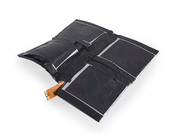

Image 1/3: All batteries die, making battery replacement a necessary repair for any device. Before we take a stab at disarming the bomb, we read all the warnings that we plan to ignore, including the very clear instruction that we are '''not to replace this battery'''. Well isn't that just [http://i.imgur.com/VZe0dL5.jpg|swell|new_window=true]. Image 2/3: At first pry, we notice lots of resistance, leaving us with the feeling there's a~~n off-chance~~ high likelihood we'll destroy this battery during removal—which makes us as nervous as the wicked witch around a bucket of water (that she has to pry open). Image 3/3: Time to get our pry on *insert high-brow joke about [http://en.wikipedia.org/wiki/Prion|prions|new_window=true]*
  • We have reached the battery. This Surface is packing a 42.2 Wh, 7.6 V, lithium ion time bomb.
  • All batteries die, making battery replacement a necessary repair for any device. Before we take a stab at disarming the bomb, we read all the warnings that we plan to ignore, including the very clear instruction that we are not to replace this battery. Well isn't that just swell.
  • At first pry, we notice lots of resistance, leaving us with the feeling there's an off-chance high likelihood we'll destroy this battery during removal—which makes us as nervous as the wicked witch around a bucket of water (that she has to pry open).
  • Time to get our pry on *insert high-brow joke about prions*
Image 1/3: The tar-like adhesive makes removing the battery without severe warping nigh impossible. Image 2/3: The battery is out, but it looks like it passed through a [http://www.nofrackingway.us/wp-content/uploads/2013/04/funhouse-mirror.jpg|fun house mirror|new_window=true] to get free. We're not so fond of clowns who believe in glued-in batteries. Image 3/3: Think we're joking about the cling factor of this adhesive? Think again. This little party trick is what we call a [http://jokesareawesome.com/tag/stick|sticky situation|new_window=true].
  • This battery is stuck like a mastodon in a tar pit.
  • The tar-like adhesive makes removing the battery without severe warping nigh impossible.
  • The battery is out, but it looks like it passed through a fun house mirror to get free. We're not so fond of clowns who believe in glued-in batteries.
  • Think we're joking about the cling factor of this adhesive? Think again. This little party trick is what we call a sticky situation.

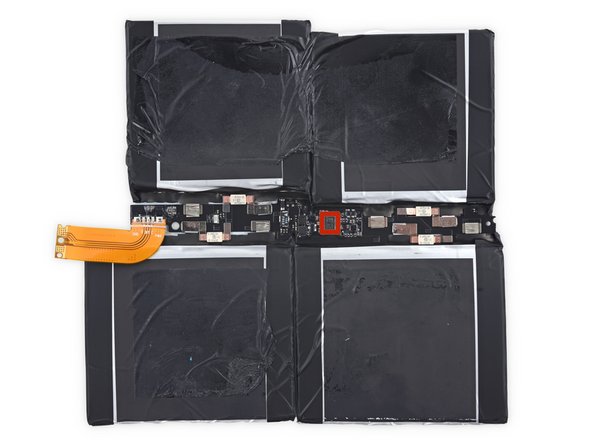

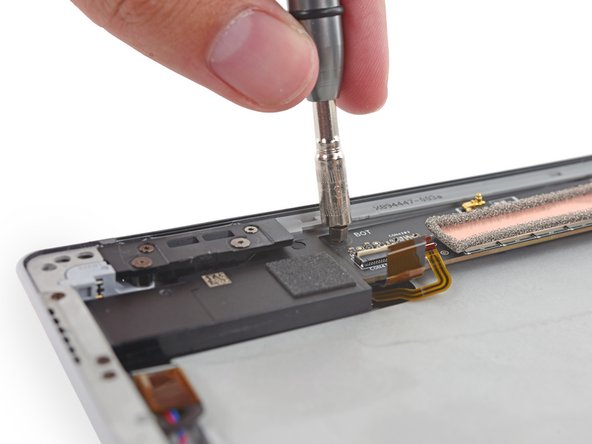

Image 1/2: This hidden battery board contains a Maxim Integrated MAX17817 battery management IC. Image 2/2: This hidden battery board contains a Maxim Integrated MAX17817 battery management IC.
  • We begin excavating, and find that this Surface keeps a few secrets in between its battery cells.
  • This hidden battery board contains a Maxim Integrated MAX17817 battery management IC.

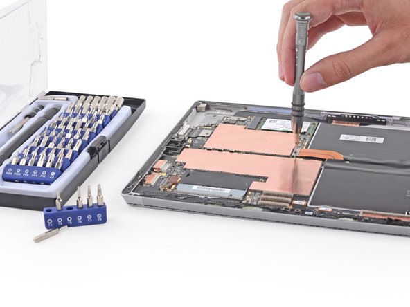

Image 1/2: ''Accio bolt!'' Fortunately, we come prepared: with our [product|IF145-072|Pro Tech Toolkit|new_window=true], any hex is quickly lifted. Image 2/2: We have to keep working our magic to free the motherboard. Not only is it captive to the case, but it's covered in copper shielding, a counter-curse to outside magic.
  • Working our way towards the motherboard, we encounter some strange magic: a random hex bolt standoff.
  • Accio bolt! Fortunately, we come prepared: with our Pro Tech Toolkit, any hex is quickly lifted.
  • We have to keep working our magic to free the motherboard. Not only is it captive to the case, but it's covered in copper shielding, a counter-curse to outside magic.

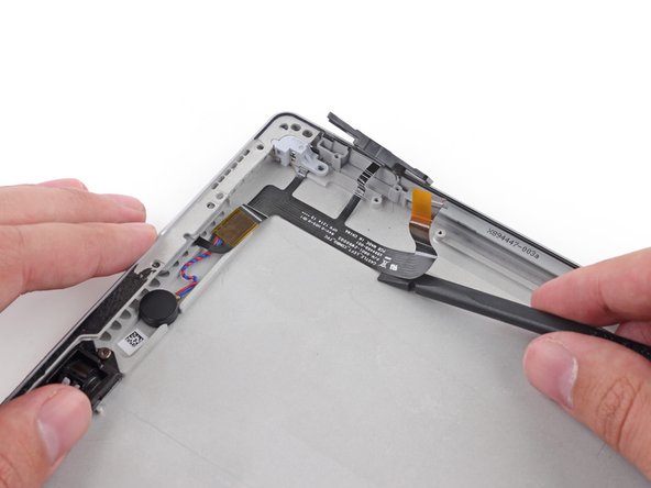

Image 1/2: While the [http://www.theverge.com/2014/5/23/5743416/microsoft-surface-pro-3-review|myriad|new_window=true] of  [http://www.zdnet.com/how-microsofts-surface-pro-3-marketing-push-backfired-7000030723/|reviews|new_window=true] focused on the identity crisis of this laplet and whether or not it could replace your tablet and laptop, [http://www.penny-arcade.com/news/post/2014/06/16/surface-pro-3-update|Gabe over at Penny Arcade|new_window=true] found some of the issues with the hardware. It would seem that if you are drawing with the included Premium pen, you bump into problems with the home button, literally. Perhaps there's a software fix in the offing? Image 2/2: While the [http://www.theverge.com/2014/5/23/5743416/microsoft-surface-pro-3-review|myriad|new_window=true] of  [http://www.zdnet.com/how-microsofts-surface-pro-3-marketing-push-backfired-7000030723/|reviews|new_window=true] focused on the identity crisis of this laplet and whether or not it could replace your tablet and laptop, [http://www.penny-arcade.com/news/post/2014/06/16/surface-pro-3-update|Gabe over at Penny Arcade|new_window=true] found some of the issues with the hardware. It would seem that if you are drawing with the included Premium pen, you bump into problems with the home button, literally. Perhaps there's a software fix in the offing?
  • The everything cable—home to the headphone jack, volume and power buttons, and vibrator.
  • While the myriad of reviews focused on the identity crisis of this laplet and whether or not it could replace your tablet and laptop, Gabe over at Penny Arcade found some of the issues with the hardware. It would seem that if you are drawing with the included Premium pen, you bump into problems with the home button, literally. Perhaps there's a software fix in the offing?

Image 1/2: The SSD can be replaced, but not without first risking damage to the tablet simply by opening it. Image 2/2: The battery is not soldered to the motherboard, but very strong adhesive makes removal and replacement a hazardous chore.
  • Microsoft Surface Pro 3 Repairability Score: 1 out of 10 (10 is easiest to repair).
    • The SSD can be replaced, but not without first risking damage to the tablet simply by opening it.
