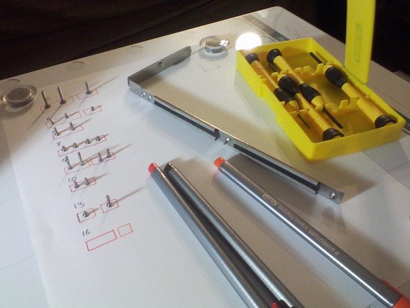

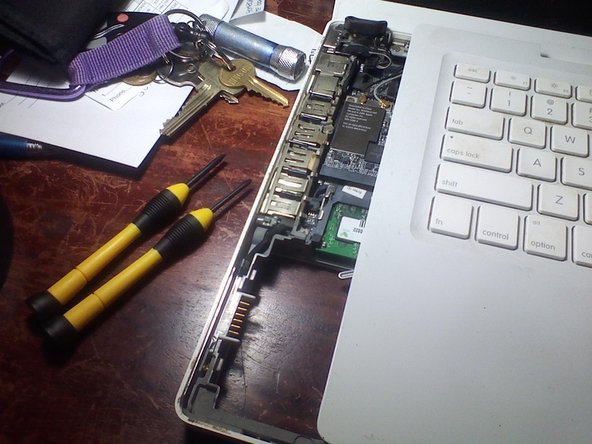

Now, I'm not new to computer hardware; I've taken apart/upgraded every desktop computer I've ever owned. But I had never touched a laptop's innards before, so I was a tad nervous. The repair went smoothly enough. I used a magnetic dry-erase calendar and some paper to draw color-coded boxes for the screws/parts of each step. It took maybe an hour and a half, tops (taking the time to airblast/scrape off dried sand that was inside EVERYTHING). The results were a perfectly charging macbook and a very happy brother-in-law. Success!

It definitely helps to already have a plan for where you're going to dump the screws. I would suggest a magnetic dry-erase board (mine was a calendar, but it worked just the same) and colored markers that match the colors used in the photographic step-by-step manual. And like the instructions say, be VERY careful removing the topcase. I chipped some of the plastic near the right palm rest trying to remove it. That seems to be a weak point for the case in general, but be extra careful not to do more damage than necessary.
