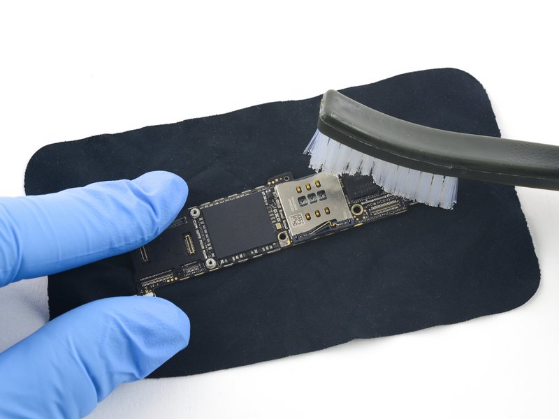

    9. iPhone Liquid Damage Repair: step 9, image 1 of 1
      Tool used on this step:
      Detailing Brush
      $2.99
      Buy
      • Use a soft brush (like a toothbrush or detailing brush) to gently scrub away any corrosion and liquid residue on the logic board and other components.
      • It's possible to break small solder joints with too much force from the brush. Use just enough force to remove the corrosion and residue.
      • Pay special attention to cable ends, battery contacts, connectors, pins, and fuses, as these parts are prone to corrosion and can easily cause the phone to malfunction.
      • Keep the logic board and any other alcohol-covered components over a cloth. There's a chance the alcohol can damage or mark your work surface.
      • If needed, repeat steps 8 and 9 until all corrosion and residue is gone.
