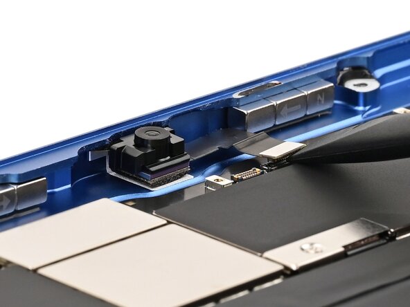

    1. iPad 10 Front Camera Replacement, Disconnect the front camera: step 25, image 1 of 2 iPad 10 Front Camera Replacement, Disconnect the front camera: step 25, image 2 of 2
      • Use the flat end of a spudger to pry up and disconnect the front camera press connector.
      Ask FixBot

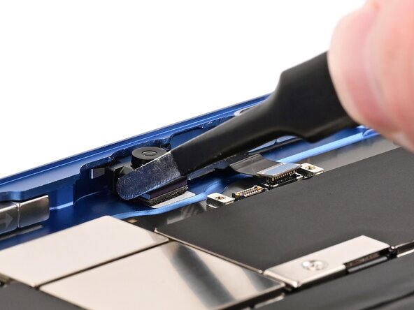

    2. iPad 10 Front Camera Replacement, Remove the front camera: step 26, image 1 of 2 iPad 10 Front Camera Replacement, Remove the front camera: step 26, image 2 of 2
      • Be careful not to damage the spring contacts behind the front camera during removal.
      • Use tweezers or your fingers to remove the front camera.
      Ask FixBot
