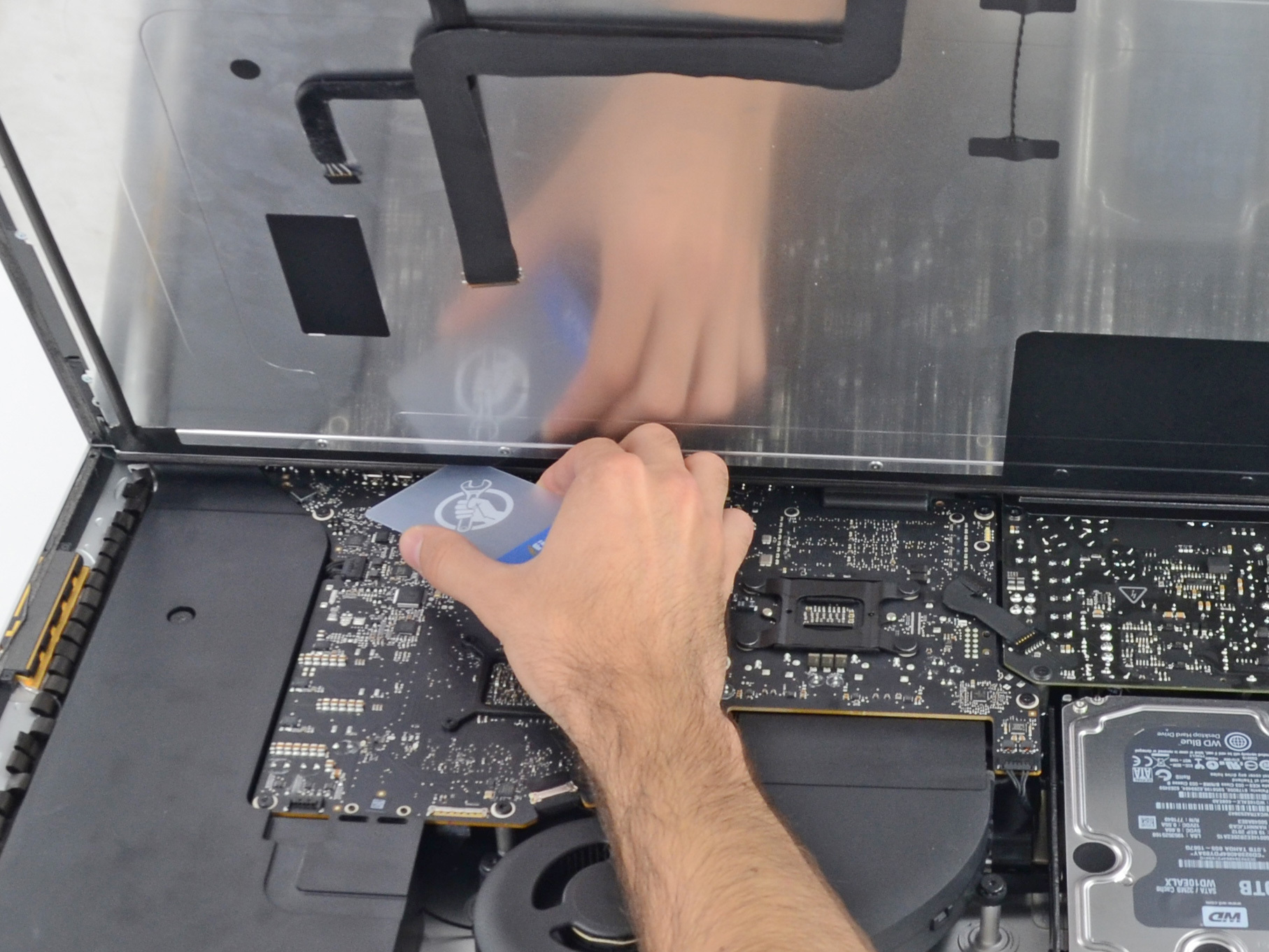

      • Lift the display up to a near-vertical position.
      • At this point there is still a strip of adhesive along the bottom of the display, that will hold the display to the frame like a hinge. You can loosen this adhesive by working the display up and down a few times.
      • Remove as much of the adhesive as possible by grabbing it at the outer edges, and then pulling or rolling it towards the middle.
      Ask FixBot
    22. iMac Intel 27" EMC 2546 Display Replacement: step 22, image 1 of 3 iMac Intel 27" EMC 2546 Display Replacement: step 22, image 2 of 3 iMac Intel 27" EMC 2546 Display Replacement: step 22, image 3 of 3
      • Be very careful not to touch the capacitor leads or any exposed solder joints on the back of the power supply (boxed in red).
      • If necessary, a plastic card can be used to cut any remaining sections of the bottom adhesive strip.
      Ask FixBot
