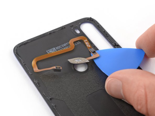

  9. Xiaomi Redmi Note 8T Rear Glass Replacement, Fingerprint Sensor: step 9, image 1 of 1
    • Apply a heated iOpener to the back of the phone where the fingerprint reader is located to loosen the adhesive underneath. Apply the iOpener for at least two minutes.
  10. Xiaomi Redmi Note 8T Rear Glass Replacement: step 10, image 1 of 3 Xiaomi Redmi Note 8T Rear Glass Replacement: step 10, image 2 of 3 Xiaomi Redmi Note 8T Rear Glass Replacement: step 10, image 3 of 3
    • Slide an opening pick underneath the edge of the fingerprint reader.
    • Slide the opening pick around the edge of the fingerprint reader to cut the adhesive underneath.
    • Use the opening pick to carefully cut the adhesive underneath the fingerprint flex cable.
  11. Xiaomi Redmi Note 8T Rear Glass Replacement: step 11, image 1 of 2 Xiaomi Redmi Note 8T Rear Glass Replacement: step 11, image 2 of 2
    • Remove the fingerprint reader.
To reassemble your device, follow these instructions in reverse order. Apply new adhesive where necessary after cleaning the relevant areas with isopropyl alcohol (>90%).
