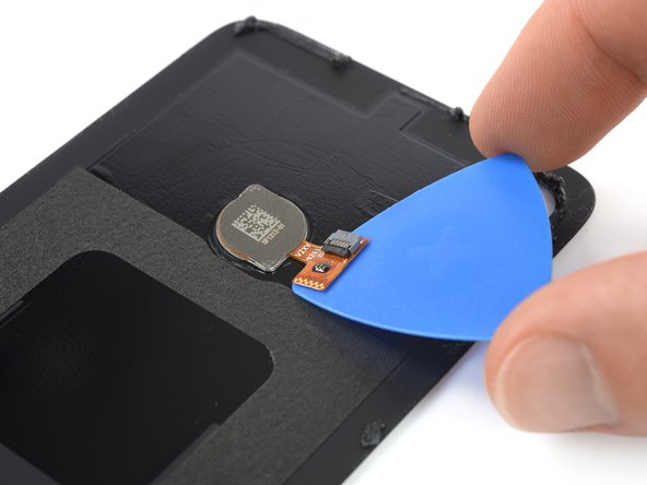

  15. Xiaomi Redmi Note 7 Rear Glass Replacement, Cut the adhesive: step 15, image 1 of 3 Xiaomi Redmi Note 7 Rear Glass Replacement, Cut the adhesive: step 15, image 2 of 3 Xiaomi Redmi Note 7 Rear Glass Replacement, Cut the adhesive: step 15, image 3 of 3
    • Carefully slide an opening pick underneath the orange flex cable with the ZIF connector to separate it from the rear glass.
  16. Xiaomi Redmi Note 7 Rear Glass Replacement, Pry up the fingerprint sensor: step 16, image 1 of 2 Xiaomi Redmi Note 7 Rear Glass Replacement, Pry up the fingerprint sensor: step 16, image 2 of 2
    • Slide the tip of an opening pick underneath the edge of the fingerprint sensor.
    • Use the opening pick to pry up the fingerprint sensor.
  17. Xiaomi Redmi Note 7 Rear Glass Replacement, Remove the fingerprint sensor: step 17, image 1 of 3 Xiaomi Redmi Note 7 Rear Glass Replacement, Remove the fingerprint sensor: step 17, image 2 of 3 Xiaomi Redmi Note 7 Rear Glass Replacement, Remove the fingerprint sensor: step 17, image 3 of 3
    • Remove the fingerprint sensor.
To reassemble your device, follow these instructions in reverse order. Apply new adhesive where necessary after cleaning the relevant areas with isopropyl alcohol (>90%).
