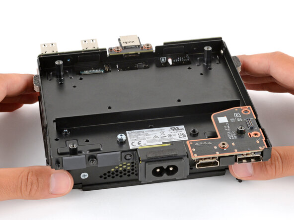

    1. Steam Machine (2026) Power Supply Replacement, Reposition the inner assembly: step 28, image 1 of 1
      • Reposition the inner assembly so the microSD reader and two USB ports are facing up at the top edge farthest from you.
      Ask FixBot

    11. Steam Machine (2026) Power Supply Replacement, Remove the SSD screw: step 38, image 1 of 2 Steam Machine (2026) Power Supply Replacement, Remove the SSD screw: step 38, image 2 of 2
      • Use a T8 Torx screwdriver to remove the 5.1 mm‑long screw securing the SSD.
      • With the screw removed, the SSD will pop up at a shallow angle.
      Ask FixBot
    12. Steam Machine (2026) Power Supply Replacement, Remove the SSD: step 39, image 1 of 2 Steam Machine (2026) Power Supply Replacement, Remove the SSD: step 39, image 2 of 2
      • Don't pull up on the SSD at a sharp angle, or you may damage the SSD and its socket.
      • Pull the SSD out of its socket at the angle it popped up at to remove it.
      Ask FixBot
    13. Steam Machine (2026) Power Supply Replacement, Remove the SSD board screws: step 40, image 1 of 2 Steam Machine (2026) Power Supply Replacement, Remove the SSD board screws: step 40, image 2 of 2
      • Use a T8 Torx screwdriver to remove the two 5.1 mm‑long screws securing the SSD board and its cover.
      • With the screws removed, the board is only attached by its ribbon cable.
      Ask FixBot

    9. Steam Machine (2026) Power Supply Replacement, Only the power supply remains: step 57, image 1 of 1
      • You're left with just the power supply.
      Ask FixBot
