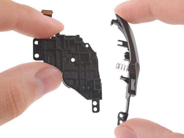

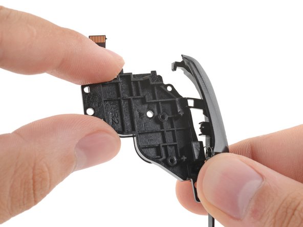

    1. Steam Deck Right Bumper Button Replacement, Remove the bumper button: step 24, image 1 of 3 Steam Deck Right Bumper Button Replacement, Remove the bumper button: step 24, image 2 of 3 Steam Deck Right Bumper Button Replacement, Remove the bumper button: step 24, image 3 of 3
      • The bumper button clips into its bracket with plastic tabs.
      • Lift the button up and away from the bracket to unclip the topmost plastic tab.
      • Disconnect the rest of the plastic tabs to remove the button.
      • Take care to not lose the button spring.
      • During reassembly, hook the button in at the spring end first, then pull the topmost clip up and over into position on the bracket.
      Ask FixBot
