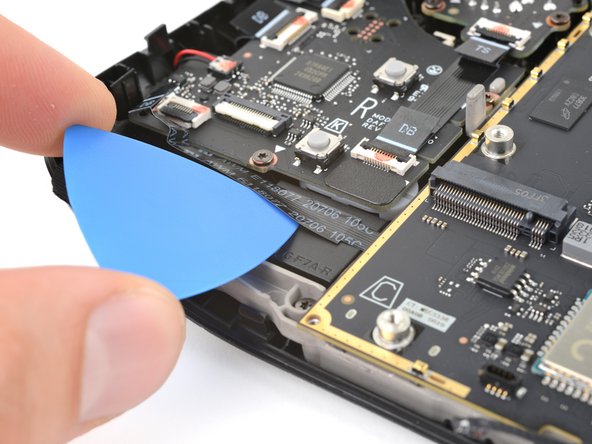

  8. Steam Deck OLED Motherboard Replacement, Separate the cable adhesive: step 8, image 1 of 3 Steam Deck OLED Motherboard Replacement, Separate the cable adhesive: step 8, image 2 of 3 Steam Deck OLED Motherboard Replacement, Separate the cable adhesive: step 8, image 3 of 3
    • The interconnect cable is adhered to the motherboard shield.
    • Insert an opening pick between the interconnect cable and the motherboard shield.
    • Be careful not to crease or tear the cable.
    • If you're having trouble inserting a pick, lightly heat the cable using an iOpener or a hair dryer.
    • Slide your pick along the shield to separate the cable.

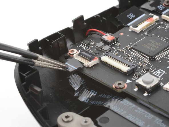

  20. Steam Deck OLED Motherboard Replacement, Separate the cable adhesive: step 20, image 1 of 3 Steam Deck OLED Motherboard Replacement, Separate the cable adhesive: step 20, image 2 of 3 Steam Deck OLED Motherboard Replacement, Separate the cable adhesive: step 20, image 3 of 3
    • Adhesive secures the right button board cable to the speaker.
    • Slide an opening pick between the left side of the cable and the speaker.
    • If the adhesive feels stubborn, lightly heat the cable with an iOpener or hair dryer.
    • Slide your pick toward the motherboard to separate the adhesive securing the cable.

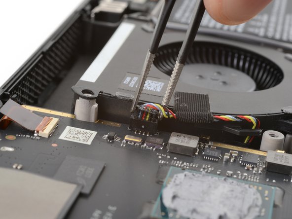

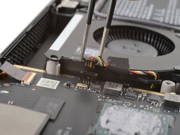

  21. Steam Deck OLED Motherboard Replacement, Disconnect the fan: step 21, image 1 of 3 Steam Deck OLED Motherboard Replacement, Disconnect the fan: step 21, image 2 of 3 Steam Deck OLED Motherboard Replacement, Disconnect the fan: step 21, image 3 of 3
    • Use blunt nose tweezers to grip the edges of the fan connector and walk it side-to-side out of its socket to disconnect it.
    • Don't pull on the cables—only pull on the connector body.
    • During reassembly, insert the connector gently. Make sure the exposed colored wires within the connector face away from the fan.
    • Don't force the connector into the socket, as you might damage the fragile internal pins.

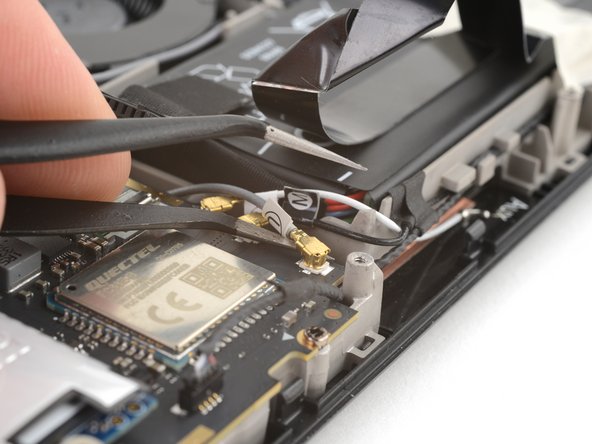

  23. Steam Deck OLED Motherboard Replacement, Disconnect the antenna cables: step 23, image 1 of 3 Steam Deck OLED Motherboard Replacement, Disconnect the antenna cables: step 23, image 2 of 3 Steam Deck OLED Motherboard Replacement, Disconnect the antenna cables: step 23, image 3 of 3
    • Slide one arm of angled tweezers under the metal neck of the gray antenna cable connector in the bottom right corner of the motherboard.
    • Gently lift the connector to disconnect it.
    • Don't lift the cables themselves—lift only on the metal necks of the connectors.

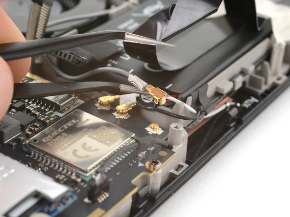

  24. Steam Deck OLED Motherboard Replacement: step 24, image 1 of 3 Steam Deck OLED Motherboard Replacement: step 24, image 2 of 3 Steam Deck OLED Motherboard Replacement: step 24, image 3 of 3
    • Repeat the previous step to disconnect the white and black antenna cable connectors.
    • During reassembly:
    • Note the correct socket for each connector—the white cable connects to the top socket, the black cable to the middle socket, and the gray cable to the bottom socket.
    • Hold each connector in place over its socket and press down with the flat end of your spudger until the connector snaps into place.

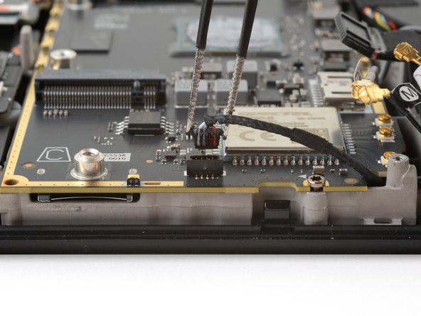

  25. Steam Deck OLED Motherboard Replacement, Disconnect the speakers: step 25, image 1 of 3 Steam Deck OLED Motherboard Replacement, Disconnect the speakers: step 25, image 2 of 3 Steam Deck OLED Motherboard Replacement, Disconnect the speakers: step 25, image 3 of 3
    • Use blunt nose tweezers to grip the edges of the speakers connector and walk it side-to-side out of its socket to disconnect it.
    • During reassembly, insert the connector gently. Make sure the exposed colored wires within the connector face away from the motherboard.

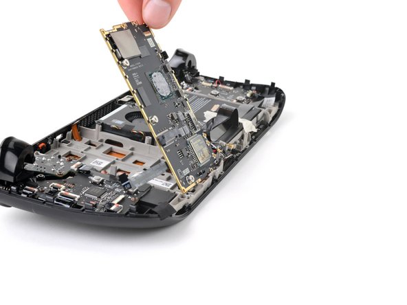

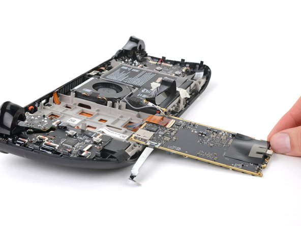

  27. Steam Deck OLED Motherboard Replacement, Flip over the motherboard: step 27, image 1 of 3 Steam Deck OLED Motherboard Replacement, Flip over the motherboard: step 27, image 2 of 3 Steam Deck OLED Motherboard Replacement, Flip over the motherboard: step 27, image 3 of 3
    • Be careful not to strain the screen cable, as it's still connected to the underside of the motherboard near the bottom right corner.
    • Lift the top edge of the motherboard and flip it over the bottom edge of the frame to access the screen cable underneath.

  29. Steam Deck OLED Motherboard Replacement, Remove the motherboard: step 29, image 1 of 1
    • Remove the motherboard.

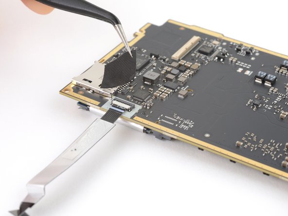

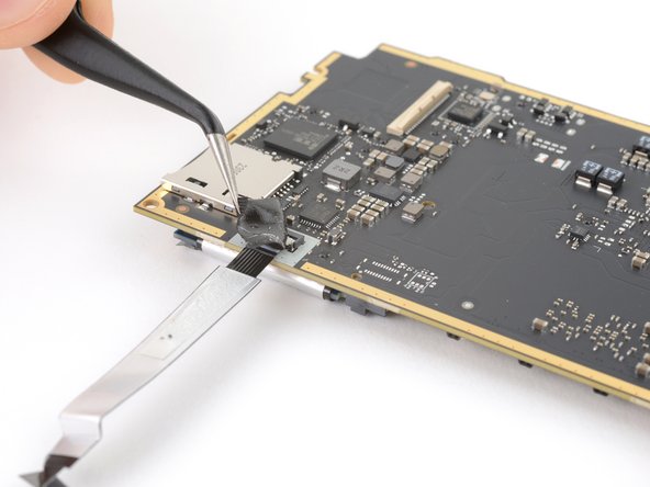

  30. Steam Deck OLED Motherboard Replacement, Remove the tape: step 30, image 1 of 3 Steam Deck OLED Motherboard Replacement, Remove the tape: step 30, image 2 of 3 Steam Deck OLED Motherboard Replacement, Remove the tape: step 30, image 3 of 3
    Tool used on this step:
    Buy
    • Use tweezers or your fingers to peel and remove the protective tape covering the motherboard cable ZIF connector.

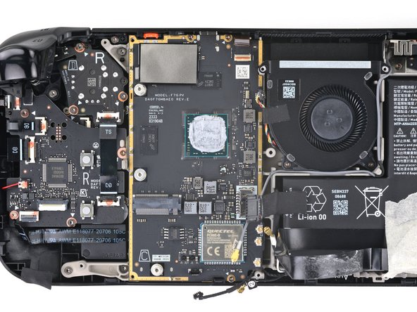

  32. Steam Deck OLED Motherboard Replacement: step 32, image 1 of 1
    • The motherboard is all that remains.
