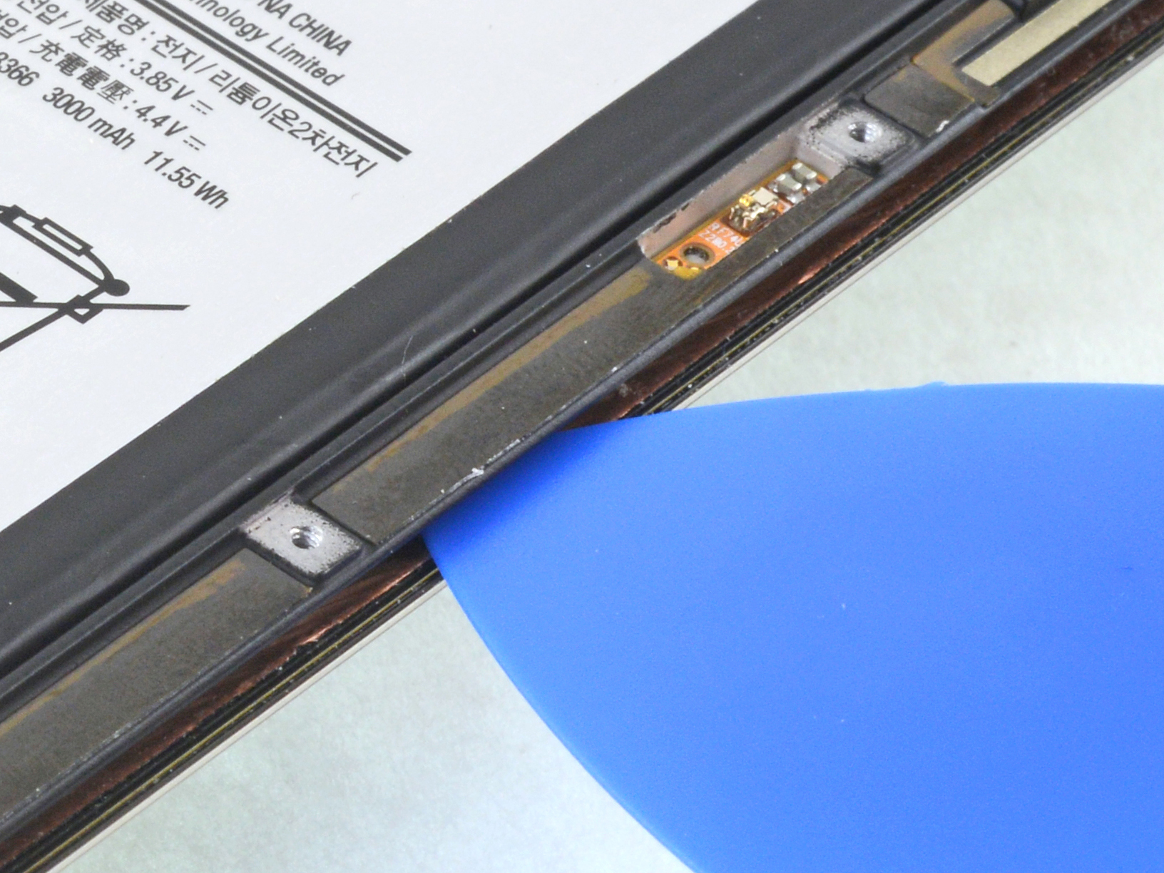

    3. Samsung Galaxy S6 Edge+ Display Replacement: step 19, image 1 of 3 Samsung Galaxy S6 Edge+ Display Replacement: step 19, image 2 of 3 Samsung Galaxy S6 Edge+ Display Replacement: step 19, image 3 of 3
      • Insert an opening pick into the small gap between the display and the display frame, near the middle of the battery-side edge of the display.
      • When you insert the pick make sure it is on top of the pink shield layer of the display to properly cut the adhesive.
      • Slide the pick along the entire edge of the display, separating the adhesive.
      • Stop before the pick gets to the daughterboard at the bottom of the phone, as there are delicate capacitive buttons adhered to the display under the daughterboard that are easily damaged.
      Ask FixBot

    5. Samsung Galaxy S6 Edge+ Display Replacement: step 21, image 1 of 3 Samsung Galaxy S6 Edge+ Display Replacement: step 21, image 2 of 3 Samsung Galaxy S6 Edge+ Display Replacement: step 21, image 3 of 3
      • Insert an opening pick no more than 0.25 inches (~6 mm) into the bottom battery-side corner of the display, near the top of the daughterboard.
      • Slide the pick around the corner of the display, stopping before you reach the "recent" button ribbon cable.
      • If you do break either of the capacitive buttons or ribbon cables, you can replace the daughterboard assembly, which includes new capacitive buttons.
      Ask FixBot

      • After removing all traces of glue and glass from the frame, clean the adhesion areas with 90% (or higher) isopropyl alcohol and a lint-free cloth or coffee filter. Swipe in one direction only, not back and forth.
      • This helps remove any remaining adhesive residue and preps the surface for the new adhesive.
      • If the frame is bent, or if any glue or glass remnants are left behind, the new display will not mount correctly and may be damaged. If necessary, replace the frame.
      • The best way to secure the new screen is with a sheet of custom-cut double-sided tape. Apply the tape to the back of the screen, then carefully feed the display cable through the frame. Align the screen and press it into place.
