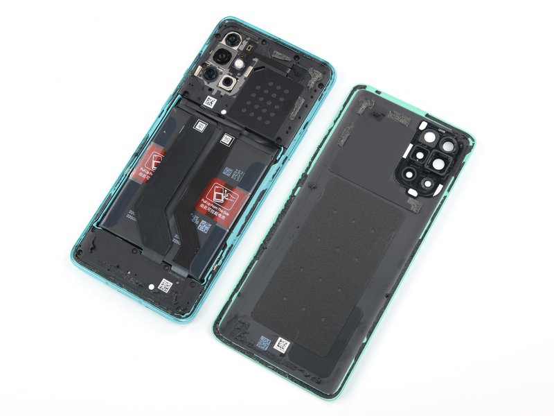

    7. OnePlus 8T Rear Glass Replacement, Remove the rear glass: step 7, image 1 of 1
      • Remove the rear glass.
      • After installing the back cover, apply strong, steady pressure to your phone for several minutes to help the adhesive form a good bond—a stack of heavy books works well.
      Ask FixBot
Secure the new rear glass cover with pre-cut adhesive or double-sided adhesive tape.
To reassemble your device, follow these instructions in reverse order. Apply new adhesive where necessary after cleaning the relevant areas with isopropyl alcohol (>90%).
