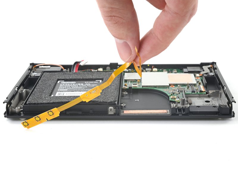

    1. Nintendo Switch OLED Model Power Button Board Replacement, Disconnect the power button board's ZIF connector: step 35, image 1 of 2 Nintendo Switch OLED Model Power Button Board Replacement, Disconnect the power button board's ZIF connector: step 35, image 2 of 2
      • Use an opening tool, spudger, or your fingernail to flip up the small, hinged locking flap on the power button board's ZIF connector.
      Ask FixBot
    2. Nintendo Switch OLED Model Power Button Board Replacement: step 36, image 1 of 2 Nintendo Switch OLED Model Power Button Board Replacement: step 36, image 2 of 2
      Tool used on this step:
      Buy
      • Use a pair of tweezers to pull the power button board cable straight out of its connector on the motherboard.
      Ask FixBot
    3. Nintendo Switch OLED Model Power Button Board Replacement, Separate the power board button's adhesive: step 37, image 1 of 3 Nintendo Switch OLED Model Power Button Board Replacement, Separate the power board button's adhesive: step 37, image 2 of 3 Nintendo Switch OLED Model Power Button Board Replacement, Separate the power board button's adhesive: step 37, image 3 of 3
      • Use your fingers to gently peel back the power board button's cable from the frame.
      Ask FixBot
    4. Nintendo Switch OLED Model Power Button Board Replacement, Remove the power button board: step 38, image 1 of 3 Nintendo Switch OLED Model Power Button Board Replacement, Remove the power button board: step 38, image 2 of 3 Nintendo Switch OLED Model Power Button Board Replacement, Remove the power button board: step 38, image 3 of 3
      • Use your fingers to pull the power button board out from its plastic slots in the frame.
      • Remove the power button board.
      Ask FixBot
