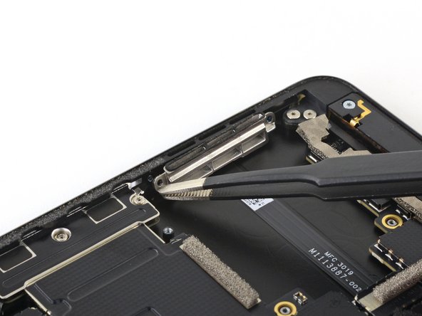

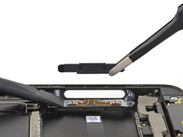

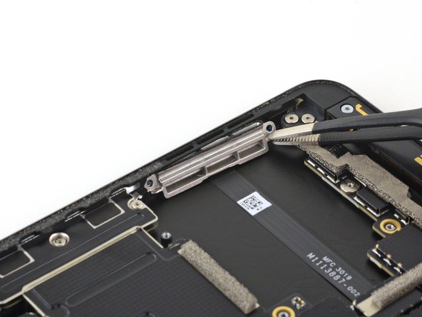

    1. Microsoft Surface Pro X Volume Button Cover Replacement, Disconnect the left speaker: step 34, image 1 of 2 Microsoft Surface Pro X Volume Button Cover Replacement, Disconnect the left speaker: step 34, image 2 of 2
      • Use the pointed end of a spudger to disconnect the left speaker's press connector from its socket.
      Ask FixBot

      • Use a pair of blunt tweezers to pull the right side of the volume button bracket straight out of the frame.
      Ask FixBot
    3. Microsoft Surface Pro X Volume Button Cover Replacement: step 41, image 1 of 2 Microsoft Surface Pro X Volume Button Cover Replacement: step 41, image 2 of 2
      • Repeat the previous step for the left side of the volume button bracket.

    4. Microsoft Surface Pro X Volume Button Cover Replacement: step 42, image 1 of 2 Microsoft Surface Pro X Volume Button Cover Replacement: step 42, image 2 of 2
      • Flip the volume button bracket's top edge 90° away from the edge of the Surface.
      Ask FixBot
    5. Microsoft Surface Pro X Volume Button Cover Replacement, Remove the volume button cover: step 43, image 1 of 2 Microsoft Surface Pro X Volume Button Cover Replacement, Remove the volume button cover: step 43, image 2 of 2
      • While holding the volume button bracket away from the edge of the Surface, use the pointed end of a spudger to push the volume button cover into the Surface.
      Ask FixBot
    6. Microsoft Surface Pro X Volume Button Cover Replacement: step 44, image 1 of 3 Microsoft Surface Pro X Volume Button Cover Replacement: step 44, image 2 of 3 Microsoft Surface Pro X Volume Button Cover Replacement: step 44, image 3 of 3
      • Remove the volume button cover from the Surface.
      • During reassembly, make sure the volume button cover is oriented correctly when you replace it. The long edge of the cover with the shorter tab should be facing up.
