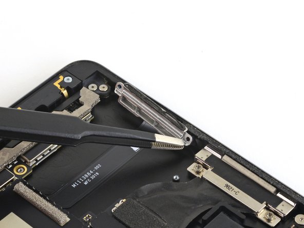

    4. Microsoft Surface Pro X Power Button Cover Replacement: step 42, image 1 of 2 Microsoft Surface Pro X Power Button Cover Replacement: step 42, image 2 of 2
      • Flip the power button bracket's top edge 90° away from the edge of the Surface.

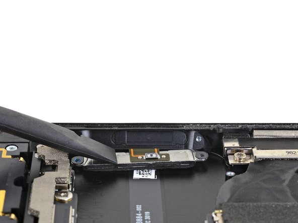

    5. Microsoft Surface Pro X Power Button Cover Replacement, Remove the power button cover: step 43, image 1 of 2 Microsoft Surface Pro X Power Button Cover Replacement, Remove the power button cover: step 43, image 2 of 2
      • While holding the power button bracket away from the edge of the Surface, use the pointed end of a spudger to push the power button cover into the Surface.

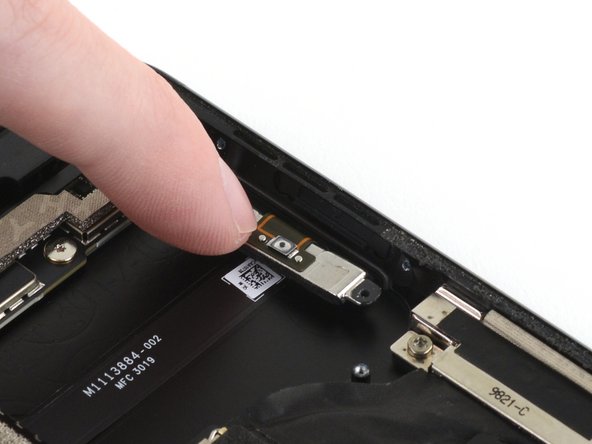

    6. Microsoft Surface Pro X Power Button Cover Replacement: step 44, image 1 of 3 Microsoft Surface Pro X Power Button Cover Replacement: step 44, image 2 of 3 Microsoft Surface Pro X Power Button Cover Replacement: step 44, image 3 of 3
      • Remove the power button cover from the Surface.
      • During reassembly, make sure the power button cover is oriented correctly when you replace it. The left and right tabs on the cover should be angled down.
