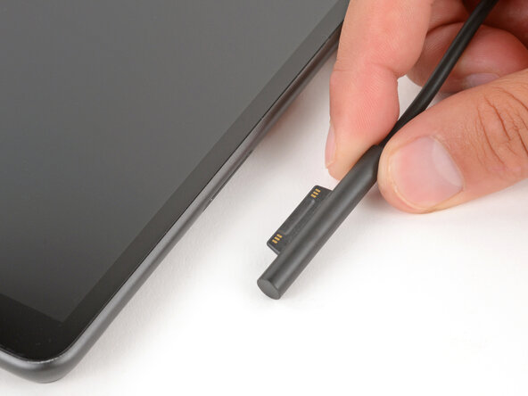

      • Before starting this repair, allow your Surface Pro's battery to drain below 25%. A charged battery may catch fire if damaged.
      • Unplug all cables and fully shut down your tablet.
      • If you have a keyboard attached, remove it.

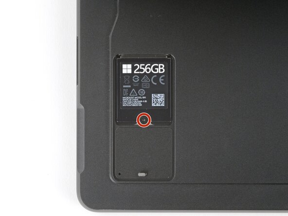

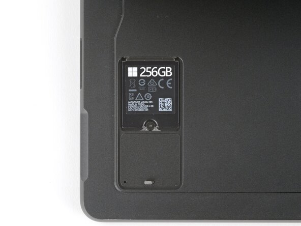

    1. Microsoft Surface Pro 8 Screen Replacement, Remove the SSD door: step 3, image 1 of 3 Microsoft Surface Pro 8 Screen Replacement, Remove the SSD door: step 3, image 2 of 3 Microsoft Surface Pro 8 Screen Replacement, Remove the SSD door: step 3, image 3 of 3
      • Firmly press a SIM eject tool into the small hole in the corner of the SSD door until it pops up.
      • Alternatively, you can also use a small, straightened paper clip.
      • Remove the SSD door.
      Ask FixBot
    1. Microsoft Surface Pro 8 Screen Replacement, Remove the SSD screw: step 4, image 1 of 2 Microsoft Surface Pro 8 Screen Replacement, Remove the SSD screw: step 4, image 2 of 2
      • Removing the SSD also functions as a battery disconnect and should be done before all major repairs.
      • Use a Torx Plus 3IP screwdriver to remove the 2.3 mm‑long screw securing the SSD.

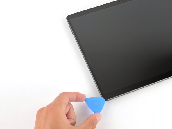

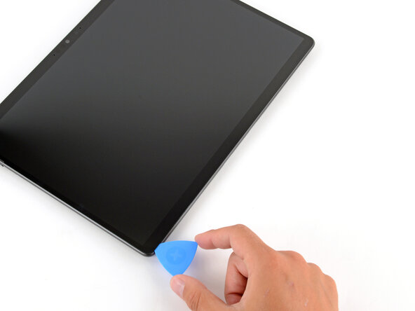

    3. Microsoft Surface Pro 8 Screen Replacement, Adhesive information: step 8, image 1 of 2 Microsoft Surface Pro 8 Screen Replacement, Adhesive information: step 8, image 2 of 2
      • Don't insert your pick more than 8 mm when separating the screen adhesive. Otherwise, you may damage your device's internals.
      • When separating the top edge adhesive, follow instructions carefully to avoid damaging the front camera.
      • To prevent inserting your pick too far, measure 8 mm from the tip and mark the opening pick with a permanent marker.
      • Alternatively, tape a coin to a pick 8 mm from the tip.

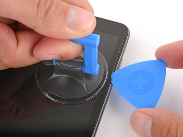

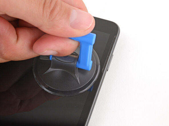

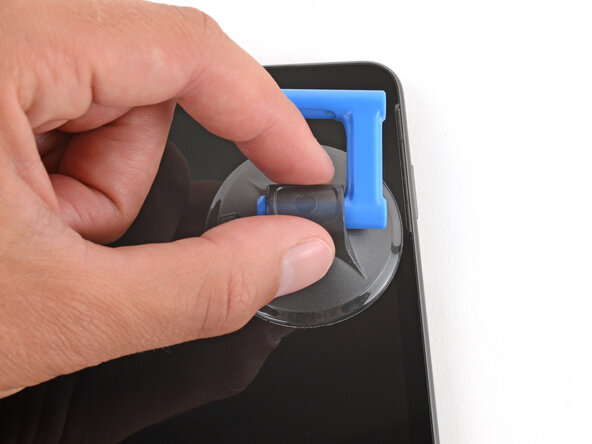

    4. Microsoft Surface Pro 8 Screen Replacement, Apply a suction handle: step 9, image 1 of 3 Microsoft Surface Pro 8 Screen Replacement, Apply a suction handle: step 9, image 2 of 3 Microsoft Surface Pro 8 Screen Replacement, Apply a suction handle: step 9, image 3 of 3
      • Apply a suction handle to the top right corner of the screen, near the bottom of the speaker cutout.
      Ask FixBot
    5. Microsoft Surface Pro 8 Screen Replacement, Insert an opening pick: step 10, image 1 of 3 Microsoft Surface Pro 8 Screen Replacement, Insert an opening pick: step 10, image 2 of 3 Microsoft Surface Pro 8 Screen Replacement, Insert an opening pick: step 10, image 3 of 3
      • Pull up on the suction handle with strong, steady force until a gap forms between the screen and frame.
      • If you're having trouble, try using an iOpener to heat the screen.
      • Insert the tip of an opening pick in the gap you just created.
      Ask FixBot
    6. Microsoft Surface Pro 8 Screen Replacement, Separate the right edge adhesive: step 11, image 1 of 3 Microsoft Surface Pro 8 Screen Replacement, Separate the right edge adhesive: step 11, image 2 of 3 Microsoft Surface Pro 8 Screen Replacement, Separate the right edge adhesive: step 11, image 3 of 3
      • Depending on the age of your device and condition of the screen adhesive, you may need to use an iOpener to heat the screen if you're having trouble separating the adhesive.
      • Slide the opening pick down the right edge and around the bottom right corner to separate the adhesive.

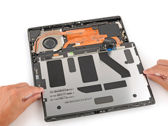

    10. Microsoft Surface Pro 8 Screen Replacement, Flip the screen over: step 15, image 1 of 3 Microsoft Surface Pro 8 Screen Replacement, Flip the screen over: step 15, image 2 of 3 Microsoft Surface Pro 8 Screen Replacement, Flip the screen over: step 15, image 3 of 3
      • Once the screen is fully separated, slightly lift the top edge and flip the screen so it can lay flat.
      • Be careful not to strain the screen cables.
      • During reassembly:
      • Remove all the remaining adhesive liners, carefully holding the screen above your device as necessary.
      • Flip the screen over and align the bottom edge, using the frame's lip to properly orient it.
      • Once the bottom edge is properly aligned, lay the screen onto the frame.
      • Use your fingers to press down on the entire perimeter of the screen to secure it in the frame.
      • Optionally, you can lay the device screen side down on a clean surface and stack 4–5 heavy books squarely on top of your device. Leave the books in place for at least thirty minutes. The lighter the books, the longer they should be left. Ideally, leave them stacked overnight.
