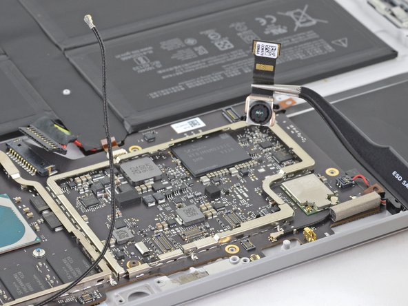

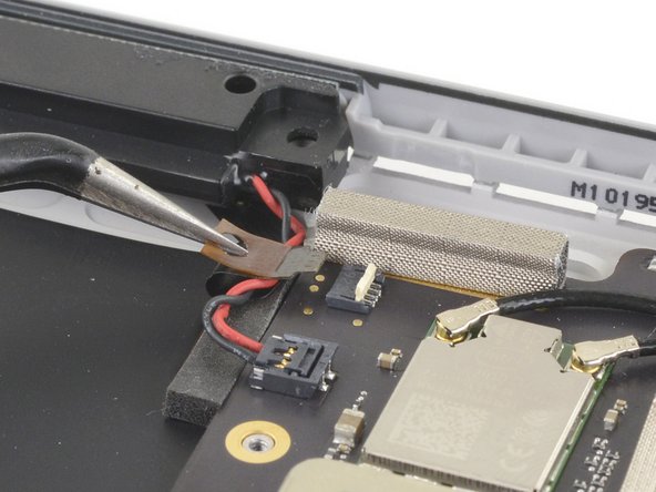

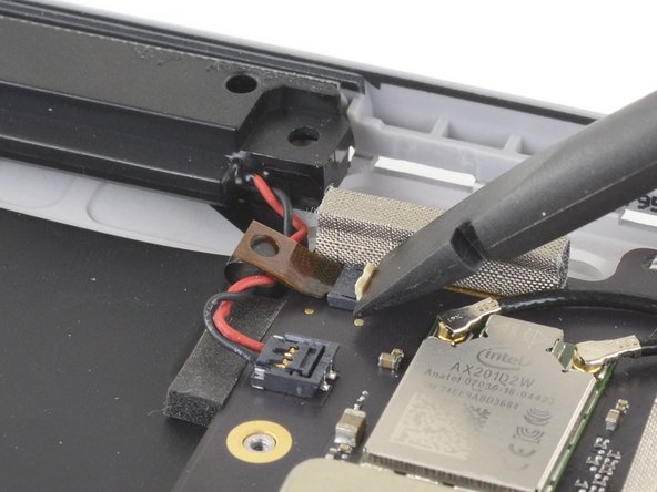

  35. Microsoft Surface Pro 7 Motherboard Replacement, Disconnect the Surface Connect port: step 35, image 1 of 2 Microsoft Surface Pro 7 Motherboard Replacement, Disconnect the Surface Connect port: step 35, image 2 of 2
    • Use the flat end of a spudger to lift the flap that secures the Surface Connect port connector.
  36. Microsoft Surface Pro 7 Motherboard Replacement: step 36, image 1 of 3 Microsoft Surface Pro 7 Motherboard Replacement: step 36, image 2 of 3 Microsoft Surface Pro 7 Motherboard Replacement: step 36, image 3 of 3
    • Use the pointed tip of a spudger to carefully push on each side of the battery connector.
    • Gently “walk” the connector out of its socket by alternating from one side to the other.

  40. Microsoft Surface Pro 7 Motherboard Replacement, Remove the cameras: step 40, image 1 of 3 Microsoft Surface Pro 7 Motherboard Replacement, Remove the cameras: step 40, image 2 of 3 Microsoft Surface Pro 7 Motherboard Replacement, Remove the cameras: step 40, image 3 of 3
    • Use the flat end of a spudger to pry up and disconnect all three camera connectors from the motherboard.
  41. Microsoft Surface Pro 7 Motherboard Replacement: step 41, image 1 of 2 Microsoft Surface Pro 7 Motherboard Replacement: step 41, image 2 of 2
    • Use a T3 Torx screwdriver to remove the two 2.6 mm screws securing the rear-facing camera.
    • Remove the rear-facing camera.

  45. Microsoft Surface Pro 7 Motherboard Replacement: step 45, image 1 of 3 Microsoft Surface Pro 7 Motherboard Replacement: step 45, image 2 of 3 Microsoft Surface Pro 7 Motherboard Replacement: step 45, image 3 of 3
    • Gently slide the flat end of a spudger between the speaker wires and the motherboard until it is resting against the connector.
    • Carefully pry straight up on the connector to disconnect it from the motherboard.
    • Be gentle; the speaker wires are delicate.
    • During reassembly, place the new speaker wire harness on top of the connector on the motherboard and gently press it straight down with your finger to reconnect it.
