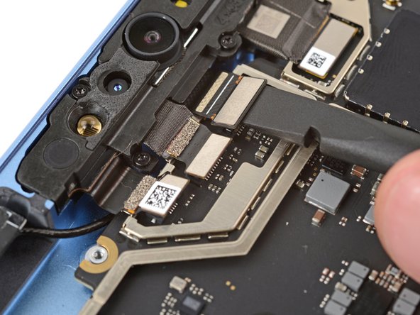

    3. Microsoft Surface Pro 11 Front Facing Camera Replacement, Disconnect the front sensor assembly: step 41, image 1 of 2 Microsoft Surface Pro 11 Front Facing Camera Replacement, Disconnect the front sensor assembly: step 41, image 2 of 2
      • Use the point of a spudger to pry up and disconnect the left microphone press connector (the farthest left one below the front camera).
      Ask FixBot
    4. Microsoft Surface Pro 11 Front Facing Camera Replacement: step 42, image 1 of 3 Microsoft Surface Pro 11 Front Facing Camera Replacement: step 42, image 2 of 3 Microsoft Surface Pro 11 Front Facing Camera Replacement: step 42, image 3 of 3
      • Use the flat end of a spudger to pry up the ambient color sensor and front facing camera press connectors, just to the right of the previous one.

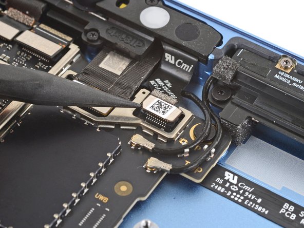

    5. Microsoft Surface Pro 11 Front Facing Camera Replacement: step 43, image 1 of 2 Microsoft Surface Pro 11 Front Facing Camera Replacement: step 43, image 2 of 2
      • Use the point of a spudger to pry up the right microphone press connector (the farthest right one below the front camera) by its notched edge and disconnect it.

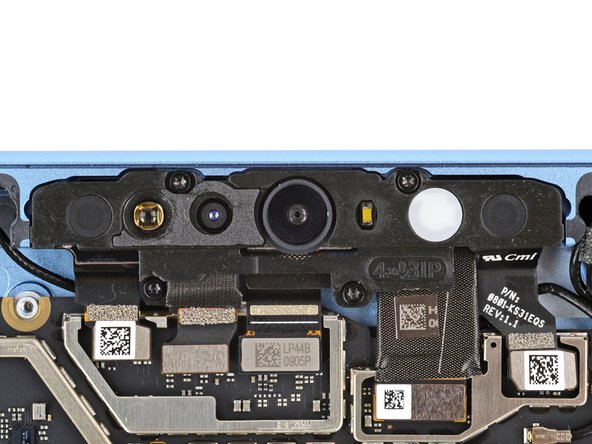

    6. Microsoft Surface Pro 11 Front Facing Camera Replacement, Remove the front sensor assembly screws: step 44, image 1 of 2 Microsoft Surface Pro 11 Front Facing Camera Replacement, Remove the front sensor assembly screws: step 44, image 2 of 2
      • Use a Torx Plus 3IP screwdriver to remove the four 3.3 mm‑long screws securing the front sensor assembly.
      Ask FixBot

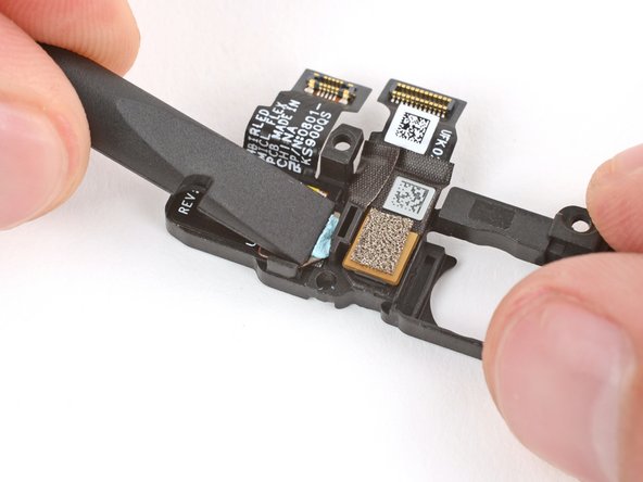

    8. Microsoft Surface Pro 11 Front Facing Camera Replacement, Thermal paste information: step 46, image 1 of 3 Microsoft Surface Pro 11 Front Facing Camera Replacement, Thermal paste information: step 46, image 2 of 3 Microsoft Surface Pro 11 Front Facing Camera Replacement, Thermal paste information: step 46, image 3 of 3
      • During reassembly:
      • Check for any thermal paste on the frame (to the left of the front facing camera) and the corresponding spot on the back of the front sensor assembly.
      • Use the flat end of a spudger to scrape up any large chunks of paste.
      • Apply a few drops of isopropyl alcohol to a lint‑free cloth (or coffee filter) to clean up the area.
      • Allow the isopropyl alcohol to dry completely before continuing.
      • Apply a very small amount of thermal putty or viscous thermal paste where the old paste was on the frame.

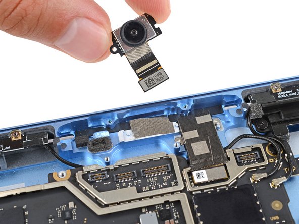

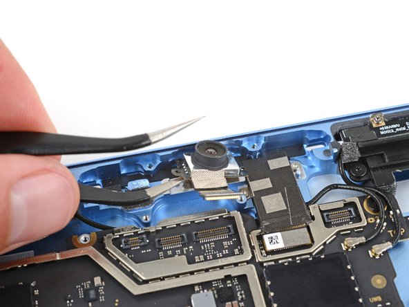

    9. Microsoft Surface Pro 11 Front Facing Camera Replacement, Remove the front facing camera: step 47, image 1 of 3 Microsoft Surface Pro 11 Front Facing Camera Replacement, Remove the front facing camera: step 47, image 2 of 3 Microsoft Surface Pro 11 Front Facing Camera Replacement, Remove the front facing camera: step 47, image 3 of 3
      • Mild adhesive secures the front facing camera to the frame.
      • Slide an arm of your angled tweezers under the front facing camera and pry it up to separate the adhesive.
      • If you're having trouble, you can use an iOpener, hair dryer, or heat gun to lightly heat the camera.
      • Remove the front facing camera.
      • Check your replacement camera for any liners or lens caps. If there are any, remove them.
      • Put the camera into place lens up on the frame, making sure the cutouts on the edges of the camera go over their alignment posts.
