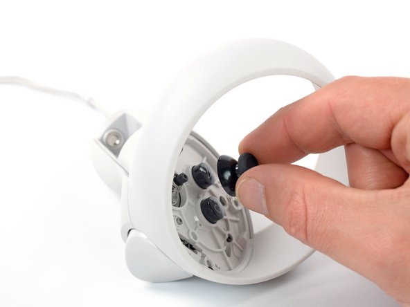

    1. Meta Quest 2 Controller Thumbgrip Replacement, Remove the thumbgrip: step 7, image 1 of 2 Meta Quest 2 Controller Thumbgrip Replacement, Remove the thumbgrip: step 7, image 2 of 2
      • Use your fingers to pull the thumbgrip straight off of the thumbstick and remove it.
