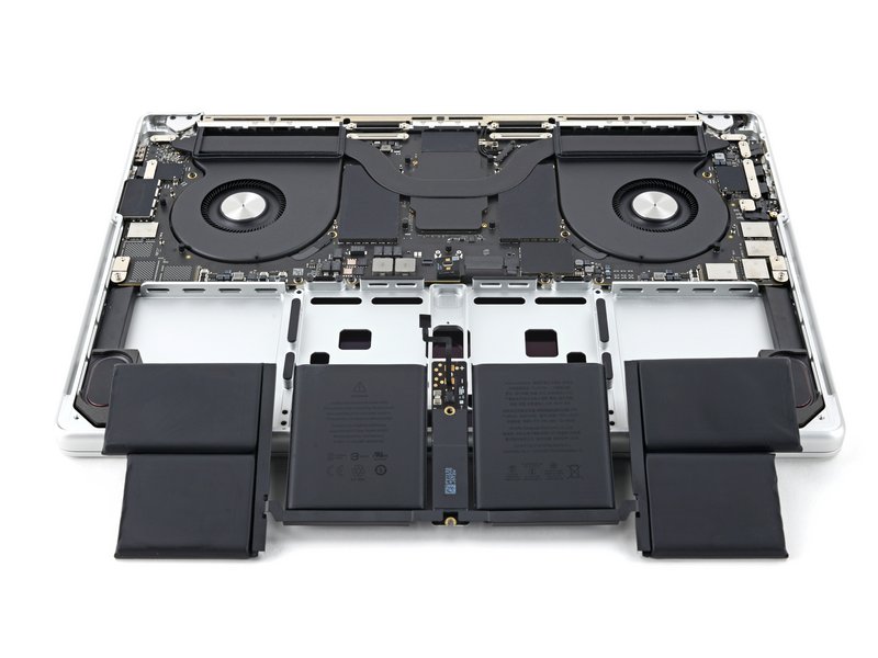

    1. MacBook Pro 16" 2021 Battery Replacement, Unfasten the battery board: step 23, image 1 of 2 MacBook Pro 16" 2021 Battery Replacement, Unfasten the battery board: step 23, image 2 of 2
      • Use a T5 Torx driver to remove the two screws securing the battery board:
      • One 4.4 mm screw
      • One 3.8 mm screw
      Ask FixBot
    2. MacBook Pro 16" 2021 Battery Replacement, Battery removal information: step 24, image 1 of 2 MacBook Pro 16" 2021 Battery Replacement, Battery removal information: step 24, image 2 of 2
      • There are 14 total stretch release adhesive strips that secure the battery to the frame:
      • There are eight adhesive strips that are accessed from the bottom of the device.
      • There are six more adhesive strips accessed from the trackpad's location on the frame.
      Ask FixBot
    3. MacBook Pro 16" 2021 Battery Replacement, Remove the stretch release adhesive: step 25, image 1 of 1
      Tool used on this step:
      Buy
      • Use tweezers, or your fingers, to grasp the black pull-tab on one of the adhesive strips.
      Ask FixBot
    4. MacBook Pro 16" 2021 Battery Replacement: step 26, image 1 of 1
      • Pull the strip out slowly and steadily at a low angle. Give it plenty of time to stretch and un-stick from under the battery.
      • If the adhesive strip breaks off, try to retrieve it using your fingers or blunt tweezers, and continue pulling—but do not pry under the battery.
      • Repeat the process for all 14 stretch release adhesive strips.
      Ask FixBot
