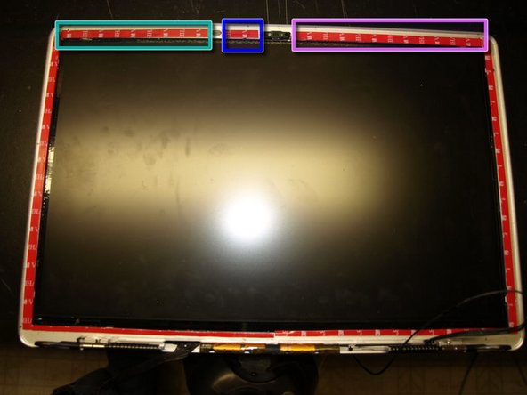

    • On the display assembly, apply the 6mm x 230mm strips, red side up, to the flange between the bumper and screen on the left and right sides.
    • Tip: Unpeel about an inch of the white backing from the adhesive and fold the backing to the side. Apply this exposed adhesive carefully to the lower corner. Then, with the rest of the white backing on the adhesive, locate the position of the upper corner. Hold that position with one hand while peeling the backing off with the other.

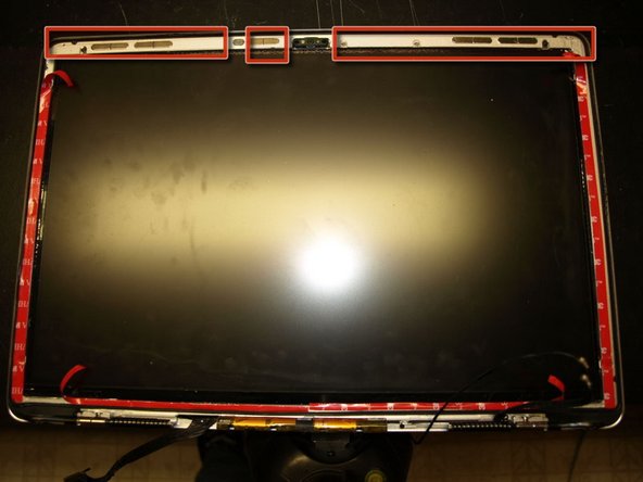

    • Apply the two 3mm x 170mm strips on the flange, red side up, between the bumper and screen at the bottom of the display assembly.
  31. MacBook Pro 15" Unibody Mid 2010 Matte Finish LCD Replacement: step 31, image 1 of 2 MacBook Pro 15" Unibody Mid 2010 Matte Finish LCD Replacement: step 31, image 2 of 2
    • Avoid placing any portion of the adhesive over the following areas:
    • Tooling holes on the left and right upper corners.
    • Camera.
    • EMI Pad
    • On the flange of the display assembly:
    • Apply the 6mm x 120mm strip, red side up, to the area on the flange between the EMI pad and the adhesive strip on the left side.
    • Apply the 6mm x 30mm strip, red side up, to the area on the flange between the EMI pad and the camera.
    • Apply the 6mm x 155mm strip, red side up, to the area on the flange between the camer and the adhesive strip on the right side.
