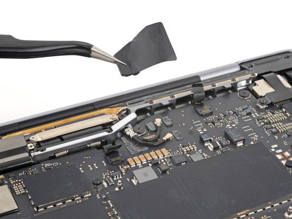

Peel and remove the plastic cover from the antenna cables.

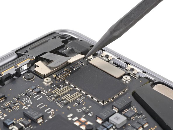

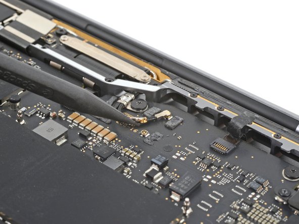

Use the point of your spudger to pry up and disconnect the antenna cables from the logic board.
Use your T5 Torx driver to remove the 3.4 mm screw securing the antenna cables to the logic board.

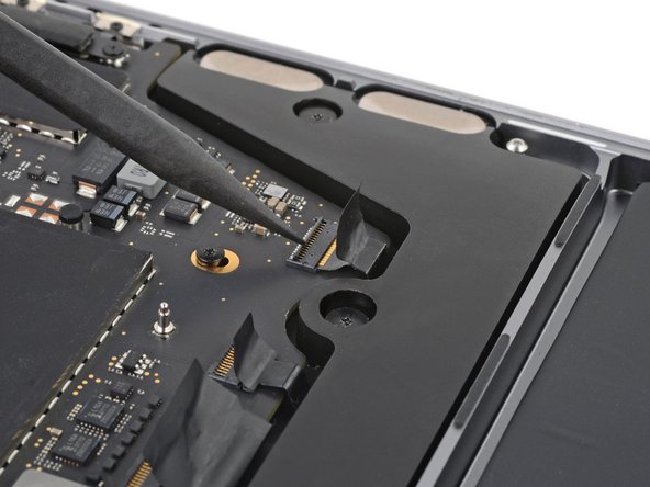

Use the point of a spudger to flip up the small locking tab securing the right speaker connector.
Grab the pull tab on the head of the cable and slide it straight out of its socket.

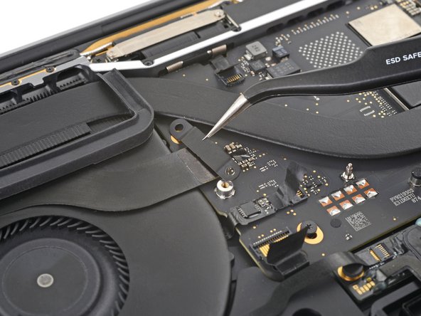

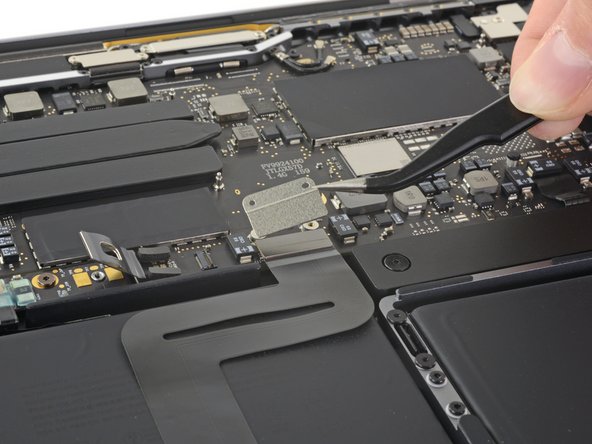

Use your T5 Torx driver to remove the two 1.9 mm screws securing the trackpad cable bracket.
Remove the bracket.

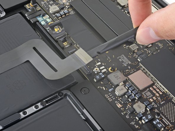

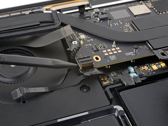

Use the flat end of your spudger to pry up and disconnect the trackpad cable from the logic board.

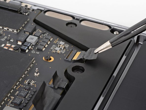

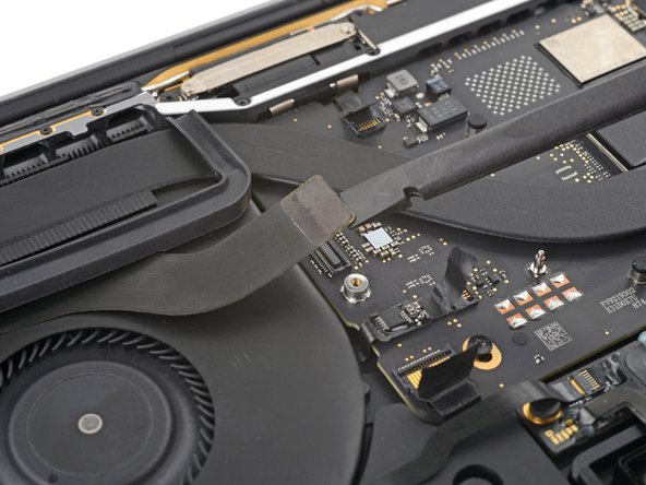

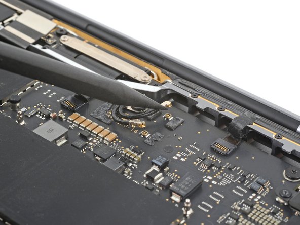

Use the point of your spudger to pry up and disconnect the Touch Bar press connector from the top right of the logic board.
Repeat this step for the lid angle sensor and the Thunderbolt ports press connectors.

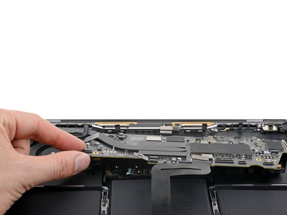

Pry up on the logic board until you can grab it with your fingers.
Grip the bottom left edge of the logic board.
Pull the logic board down and left to free it from the press connectors and antenna cables in the upper right corner.
Lift the logic board out of its recess, making sure not to catch on any loose cables.

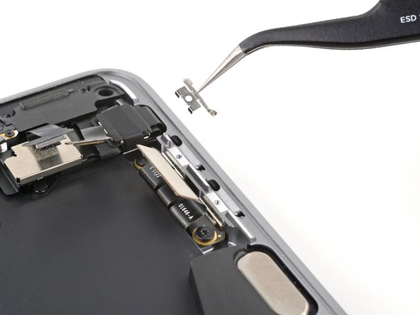

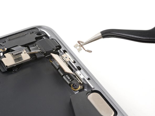

Use tweezers to carefully grab and remove the spring contacts from the Thunderbolt ports.

A minor but important missing part of this guide is removing the display cable near the top center of the logic board, if you attempt to remove the logic board without disconnecting the 4 screws and detaching the video cable you may damage your logic board or display cable, I'm sure the guide writer had this in rough drafts and just forgot to insert it
Seconded, this is very very important and should be fixed!
I just damaged mine! ☹️ This article really should be updated!
