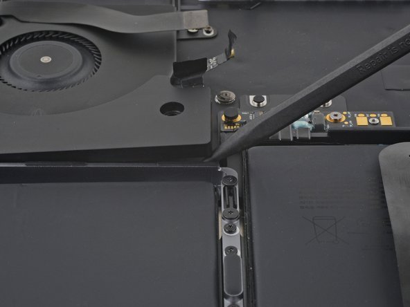

    1. MacBook Pro 13" 2022 (M2) Fan Replacement, Unfasten the left speaker: step 34, image 1 of 1
      • Use your T5 Torx driver to remove the three 2.8 mm screws securing the left speaker.
      • The screws are held in place by rubber spacers that may prevent them from coming out once they're unscrewed.
      Ask FixBot
    2. MacBook Pro 13" 2022 (M2) Fan Replacement, Remove the left speaker: step 35, image 1 of 3 MacBook Pro 13" 2022 (M2) Fan Replacement, Remove the left speaker: step 35, image 2 of 3 MacBook Pro 13" 2022 (M2) Fan Replacement, Remove the left speaker: step 35, image 3 of 3
      • Insert the point of your spudger between the right edge of the left speaker and the frame.
      • Pry the speaker out of its recess in the frame.
      • Grab the right edge of the speaker and remove it.
      Ask FixBot

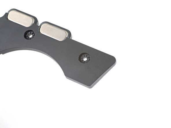

    3. MacBook Pro 13" 2022 (M2) Fan Replacement, Reassembly information: step 36, image 1 of 3 MacBook Pro 13" 2022 (M2) Fan Replacement, Reassembly information: step 36, image 2 of 3 MacBook Pro 13" 2022 (M2) Fan Replacement, Reassembly information: step 36, image 3 of 3
      • Before reinstalling the speakers, the rubber spacers must be in the speaker screw holes. If any spacers are on their screw posts in the frame, remove them and follow these instructions:
      • Flip the speaker over so the bottom side faces you.
      • Press each rubber spacer into its hole with the smooth side facing up.
      • Use the point of a spudger to fully seat the spacer into its slot.
      Ask FixBot

    6. MacBook Pro 13" 2022 (M2) Fan Replacement, Remove the fan: step 39, image 1 of 3 MacBook Pro 13" 2022 (M2) Fan Replacement, Remove the fan: step 39, image 2 of 3 MacBook Pro 13" 2022 (M2) Fan Replacement, Remove the fan: step 39, image 3 of 3
      • Slide the fan out from underneath the audio board flex cable and remove it.
      Ask FixBot
