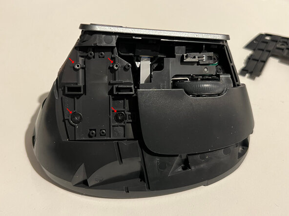

    3. Logitech MX Vertical Mouse Wheel Fix, Remove button caps: step 10, image 1 of 2 Logitech MX Vertical Mouse Wheel Fix, Remove button caps: step 10, image 2 of 2
      • Remove outer cover by pulling it away from the mouse to reveal the button cap screws.
      • Button caps are attached with two screws each.
      • Remove the upper cap first, then the lower cap.

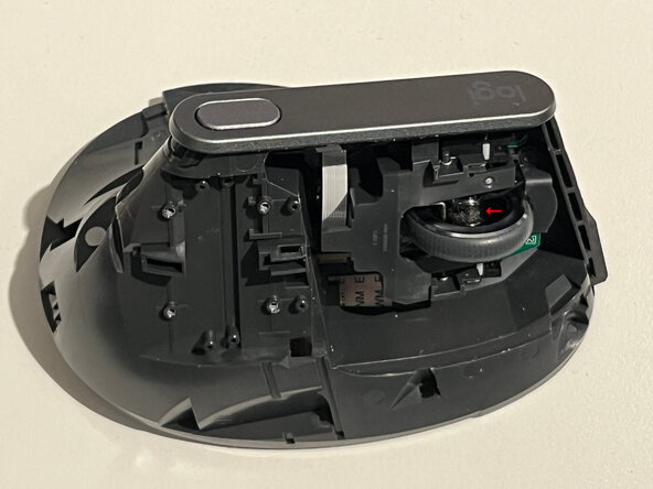

    4. Logitech MX Vertical Mouse Wheel Fix, Clean the mouse wheel: step 11, image 1 of 1
      • The arrow in the image shows where the fuzz accumulates to remove it using an air blower and tweezers.
      • Fuzz also accumulates on the inner side of the wheel, roll the wheel and clean until there is no fuzz left.
