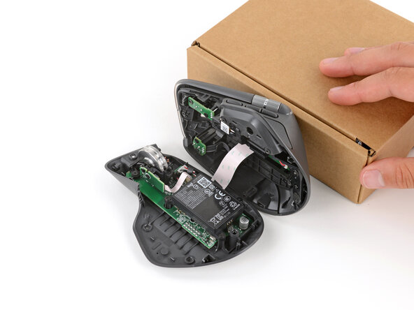

    4. Logitech MX Master 4 Battery Replacement, Prop up the top half: step 5, image 1 of 2 Logitech MX Master 4 Battery Replacement, Prop up the top half: step 5, image 2 of 2
      • Flip the top half of the mouse over the right side and use a sturdy object to prop it up, so you can access the battery.

    5. Logitech MX Master 4 Battery Replacement, Remove the battery screws: step 6, image 1 of 2 Logitech MX Master 4 Battery Replacement, Remove the battery screws: step 6, image 2 of 2
      • Use a Phillips screwdriver to remove the three 4.4 mm‑long screws securing the battery.

    6. Logitech MX Master 4 Battery Replacement, Remove the battery: step 7, image 1 of 3 Logitech MX Master 4 Battery Replacement, Remove the battery: step 7, image 2 of 3 Logitech MX Master 4 Battery Replacement, Remove the battery: step 7, image 3 of 3
      • Use your fingers to lift the battery straight up and remove it.
      • During reassembly, press the battery into place until the connector on the bottom edge clicks into its socket.
